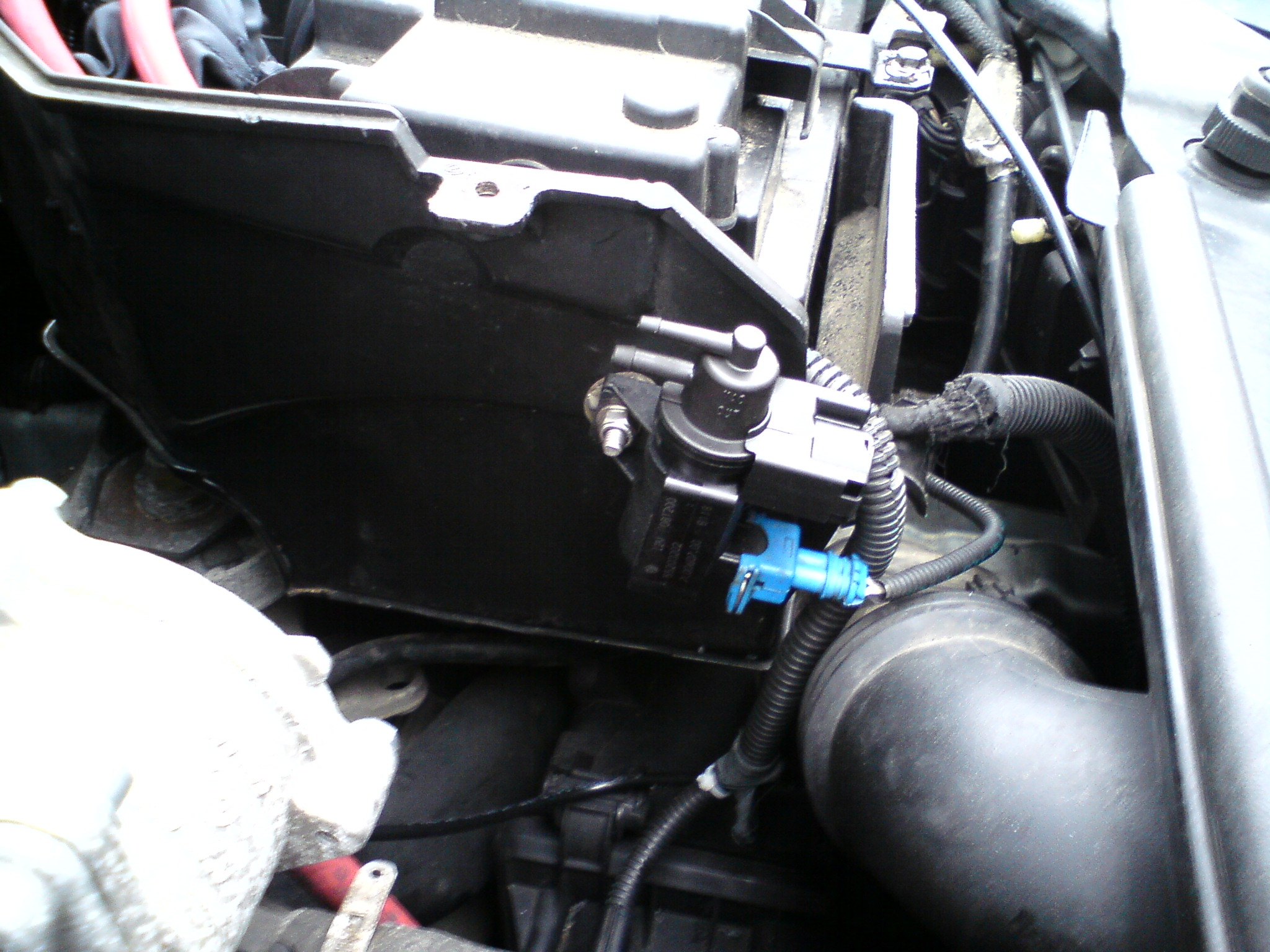

Personally, the only sensible place to resite the solenoid is on the side of the battery box. The following may help you to resite your boost solenoid and hopefully avoid further failure.

Using the solenoid as a template, position it on the side of the battery tray as shown in the photo - 2 vacuum pipes at top, electrical connector at bottom and drill 2 6mm holes - being careful not to drill through the battery cables inside!
Using 5 or 6mm bolts mount the solenoid on the battery box, sandwiching the rubber washers between the two.
Reconnect the electrical connector and 2 vacuum pipes, large connector to turbo actuator, small to vacuum pipework under EGR valve. Secure pipes with cable ties to prevent rubbing.
Refit battery cover - dependant on solenoid position, the cover may need trimming - easily trimmed with a hacksaw.
Close bonnett, job done (y)
