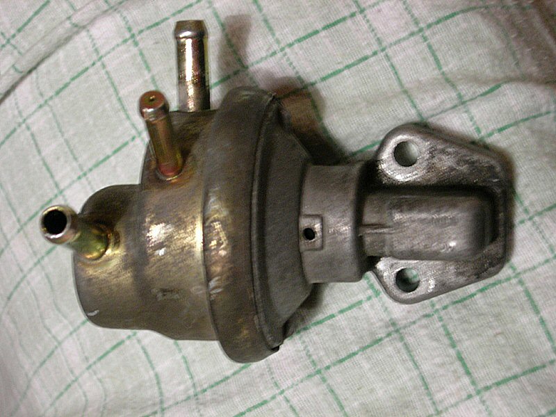

1990 Uno 1.0 engine, manual fuel pump.
Car cut-out in the middle of crossing a major road... coasted to the shoulder just in time to avoid a collision, whew!
Checked for spark - got. Checked for fuel in the in line filter - none. Tryed to get a pump here locally (Ireland) not a hope, even from the Fiat dealer.
By chance a person walked up to me and asked what was wrong, I guess he saw my Italian plates and thought I was a fellow country-man, I told him the problem and told me that of the dozens of Uno he had worked on (he was a retired Fiat mechanic, what were the chances of that!) with this problem it turned out to never be the fuel pump, but the push rod that operates off the cam that actually pumps the fuel pump.
The cam, I guess is wore past spec for the pump push rod.
So, what to do: he said
1.) Remove one of the the gasket shims on the pump, thus bringing the pump closer to the push rod thereby increasing the fuel pressure.
But I didn't have any shims just one 3mm hard gasket.
2.) Refit the manual pump and block off the fuel ports.
Buy an electric pump and route the fuel line through it.

My questions.
1.) Has anyone installed an electric pump in place of a manual one, if so what make/ model /PSI of pump, Haynes says 0.176bar/ 2.55 PSI to the carb but this sounds very low.
2.) If I can get some soft gasket material is it feasible to make a handmade gasket of 3 mm and then compress the soft 3mm to 2.5 mm
when I put the 2 pump retaining bolts back on? This would move the push rod closer to the pump.
I don't think I can cut a hard gasket to the shape of pump face.
Any help would be appreciated... Lance

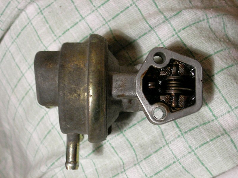

I dont have any shims on my pump (just a thin gasket on each side of the plastic block). That plastic block needs to stay on there as it holds the push rod in place.
If you are going to go with an electric fuel pump, you would probably be best to remove the entire fuel pump assembly and replace with a blanking plate.
i dont have any shims on my pump (just a thin gasket on each side of the plastic block). That plastic block needs to stay on there as it holds the push rod in place.

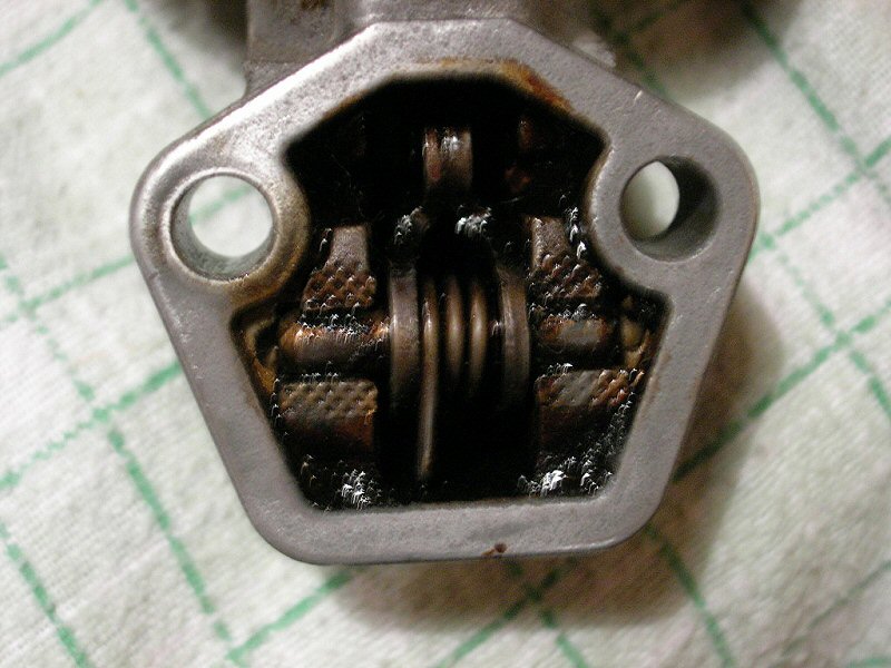

The push rod looks fine, no rounding at the cam end at all and just a tiny tiny deformation at the pump end.
I don't understand why...
"the exact thickness/adjustment really isn't that important."
I used my finger as the push rod and the mechanism that the rod pushes doesn't have that far of a stroke (4mm?) b4 it hits the interior of the housing.
I don't know if 4mm is a flexible adjustment range or not. I guess ur saying its a flexible adjustment range?
The first thing I did (yesterday) was test the pump, I tyred to pump it with my finger and it didn't suck any petrol, however I thought that I couldn't pump it fast enough to make it suck... so I attached a spare fuel line and gently blew into the intake port. The diaphragm seems to work fine as it took a little pressure to feel the air flow come out of the carb port. With just a faint blow the air wouldn't exit the carb port.
I took this to mean the pump could hold a vacuum.
I cleaned-up and sanded down the 3mm plastic gasket (today) put back the pump and didn't get a drop of petrol. I let the battery crank the engine a good 60 seconds 3x in a row. No fuel.

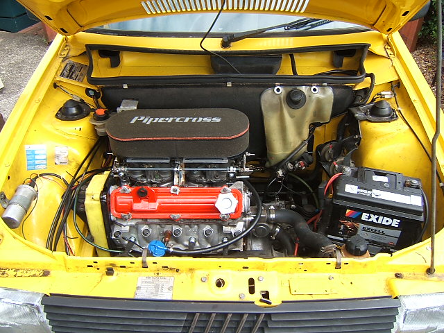

The easiest way to tell them apart is by looking at the cam cover, there are three types.
The FIRE has a big square cover with the oil filler on a raised square section at the timing belt end (most people appear to have the FIRE). The fuel pump on the FIRE is on the top at the back next to the distributor (which is driven directly by the cam shaft).
The Lampredi engine often has a pressed steel cover with ribs on it (some of them have an alloy cover, but I've only seen this on an X1/9 and Uno turbo). This cover is on about a 45 degree angle facing forward. The fuel pump on this engine is on the bottom front of the engine (on the block), just above the oil filter. The attached photo shows my Lampredi engine.
The old OHV engine has a dome like steel cover and the distributor sticking out the top.
If it is a broken cam belt then I'm not holding out much hope for your engine. The Lampredi engine is a non-safe engine, so the valves often hit the pistons and bend when the cam belt brakes. Of course if you have a FIRE then you are sweet with a broken cam belt and they are really easy to replace. If you have the OHV engine then you wont have a cam belt.

I pretty sure I have a FIRE the as the fuel pump is high on the engine not near the oil filter. At least that one mystery sloved...thanks
