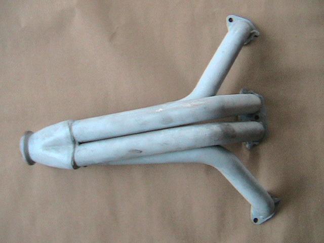

Hey Theo Chan,
What did you mean by 42" primary headers? Is that the length of the pipes?
Here is the picture of the manifold I've got.
Hi SpiritX,
That one looks like a 21" header, if you measure it from the exhaust flange to where all 4 pipes meet, it should be about 21 inches. It should bring up the torque of the engine and should be okay and alot quieter that the 42"'s. A nice Ansa 4 pipe tailbox would go great with it!
T :)
Yeah, probably 21"...
I remember I've seen a 42", it was a veeery long manifold, where the headers were joining after 90 degree turn.
ut I think I will keep this one. For me its better to have a quiter rather than few bhp more.
Thanks!
