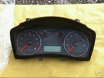

Yesterday I bought a full instrument cluster from a vehicle dismantler for £58.75
It looks quite simple to fit, remove the plastic steering column covers, undo the two lower and two upper screws that hold the cluster in and pull out. We shall see tonight when I get home, weather permitting. Will post success :) or failure :(

Just took me 3/4 hour to change the instrument cluster. Please see my other thread for more info.
Only required an allen key and a philips screwdriver.
Don't ditch the car for something relatively cheap.

You can use a second hand instrument cluster (of the same type) but it has to be proxi aligned i.e. tuned in to all the other nodes and mileage transferred over etc so you'll need Examiner somewhere along the way
