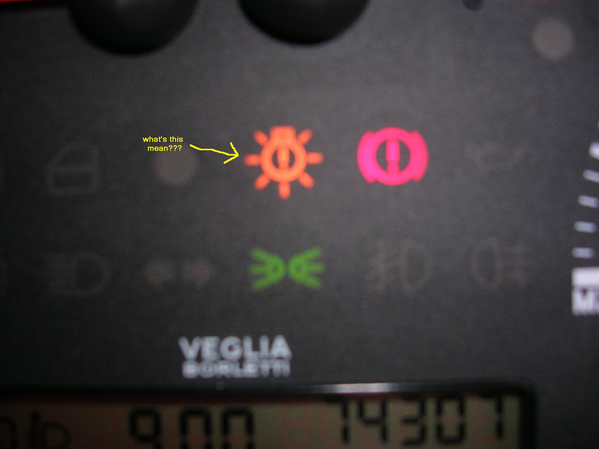

The missus's 1.2 8v ELX 2001(Xreg) is doing the same!!,its on constantly and all the bulbs are fine,at least i think they are,i checkaed and all are working!
heres a pic of the light,is this the same as you guys?
Re: Punto "Bulbcheck" Amber warning light on dashboard
That light in the photo is isdeed the blue check light.
My plan of action in order would be:
1) Check all blubs are working, this includes reverse lights, both indicators, fog lights, spot lights, boot light, reg light, break lights, dip lights and head beam.
2) Light still on? Take out all blubs and make sure the socket for each blub is clean and so is the connections free from rust, also make sure blubs are in fully and tight.
Replace and really old worn out doggy dull looking blubs even if they work okay.
3) Still on? Go to fiat and get the earthing and wiring checked.
4) Open up the dash and put some black sticky tape over the warning light .so ya cant see it :D
