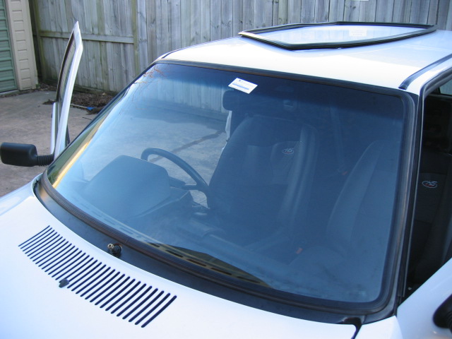

Anyway. Today I kicked out the old windscreen (that I put in just under two years ago) and fitted the new... except that I didn't, because it didn't fit! There's a 15mm gap at the side, and an 8mm gap at the top.
Standing the two windscreens side-by-side, I can see about a 5mm difference all around, which is about what you'd expect. BUT (and here's the fun part), if you measure with a tape measure, stretched taught, from corner-to-corner, side-to-side, and top-to-bottom, the two are within a couple of millimetres of each other! It's nuts... :bang:
So my conclusion is that the curvature of the glass must be different, or some other reason (though you'd think that the diagonal measurement or the side-to-side measurement is what would show the difference, since the tape measure doesn't follow the glass curvature).

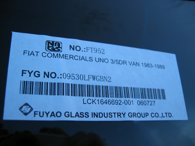

Anyway the windscreen was labelled 'Uno 3dr 5dr van'
and made by a company in China I think.
I've never thought of the Brazilian-style Cityvan (the one with the clamshell bonnet) and similar Brazilian-style Uno as having a different windscreen, but I guess that this is the case. Or, the one I've got is wrong because of a manufacturing fault. Either way, it now has to go back, though the glass company is wondering what they're going to do about it.
