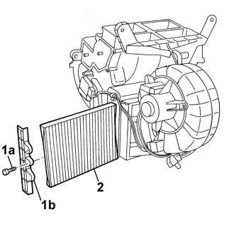

Ive owned my stilo since new and the aircon has been a thorn in my side the whole time. In the summer months after a day of use the unit throws out water all inside the car soaking everything and misting up the windows. It had been back to the dealers 7 times during warrenty each time they "said" they had fixed it but within a couple of days it was back.
What i done was took off the drivers side centre panel and located the drain pipe, the pipe is plastic and has a rubber 90degree bend on the bottom to atmosphere (ps this was clear). I pulled the pipe off and with a normal plastic straw i inserted it into the top hole (into the aircon unit), about a gallon of water flowed out. This is basically what i think the dealer was doing, but as soon as the aircon was running again it seemed to vaccum up and stop flowing out again, this time i done the same trick and left the straw in it hoping it would break any vaccum that occurs. Its been two months now and i have clear windows and dry carpets, all for the cost of 10mins and an normal drinking straw.
