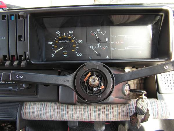

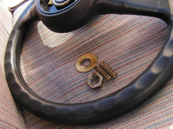

Once removed you can see the 24mm nut holding the wheel in place, the springs which operate the horn and the washer below the nut. Remove the springs and set them aside.
Next, get a 24mm spanner or socket and loosen the nut carefully. It may be tight, but it will loosen. Be careful not to round the edges. Once off set it with the springs and then remove the washer. Don't lose them!
Then simply pull the wheel towards you, it will come away from the steering column easily.
