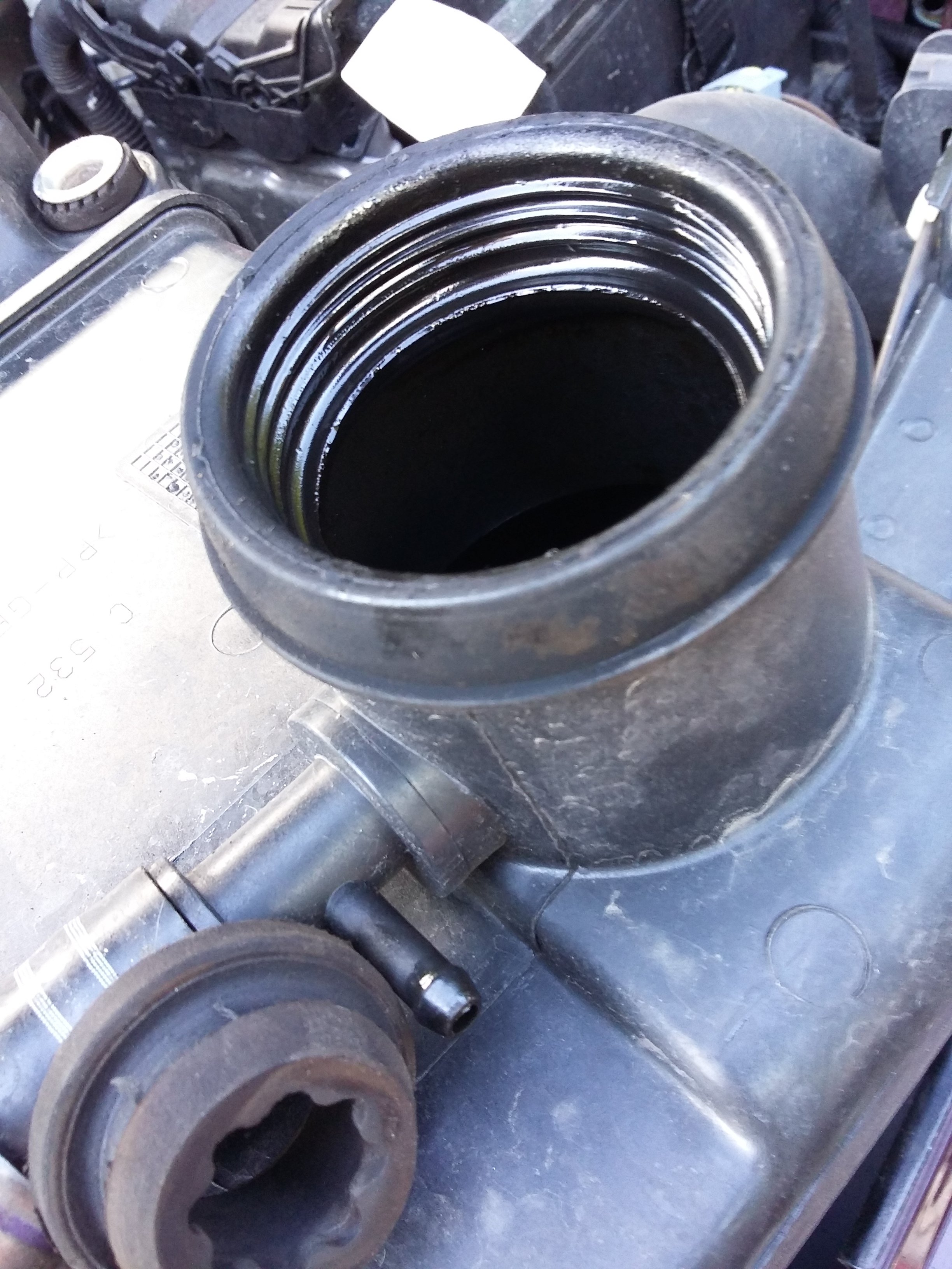

Slide Airbox boot over the throttlebody

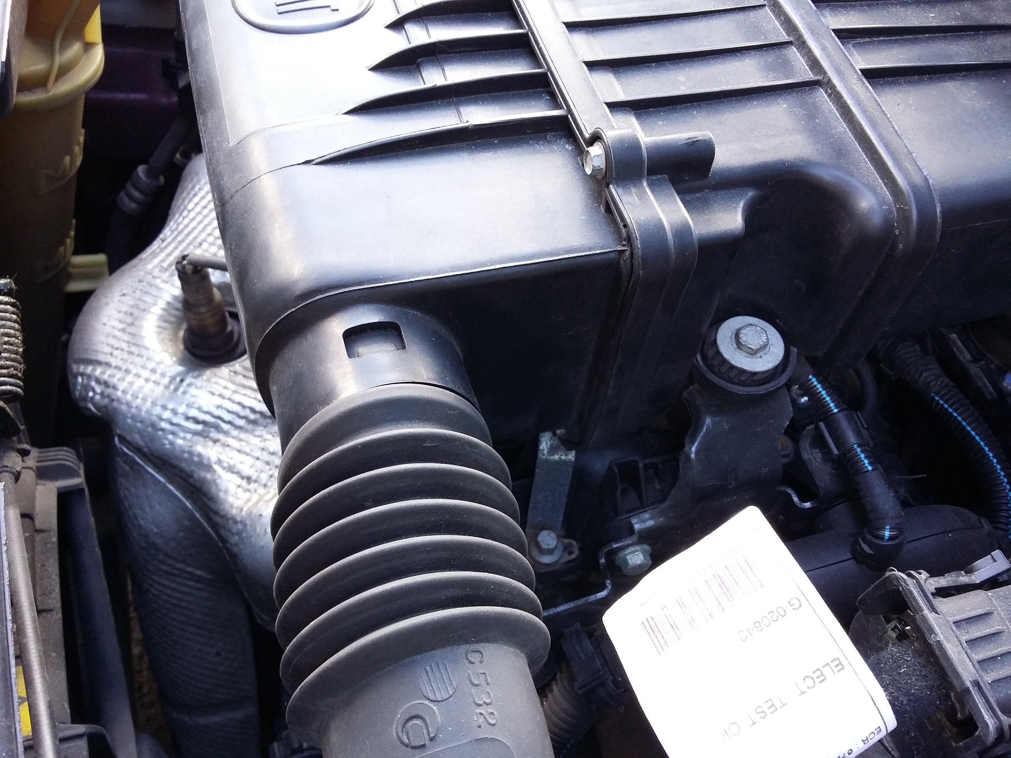

And lower Airbox onto the rear mounting spike
Mount the Fresh air hose into the front of Airbox

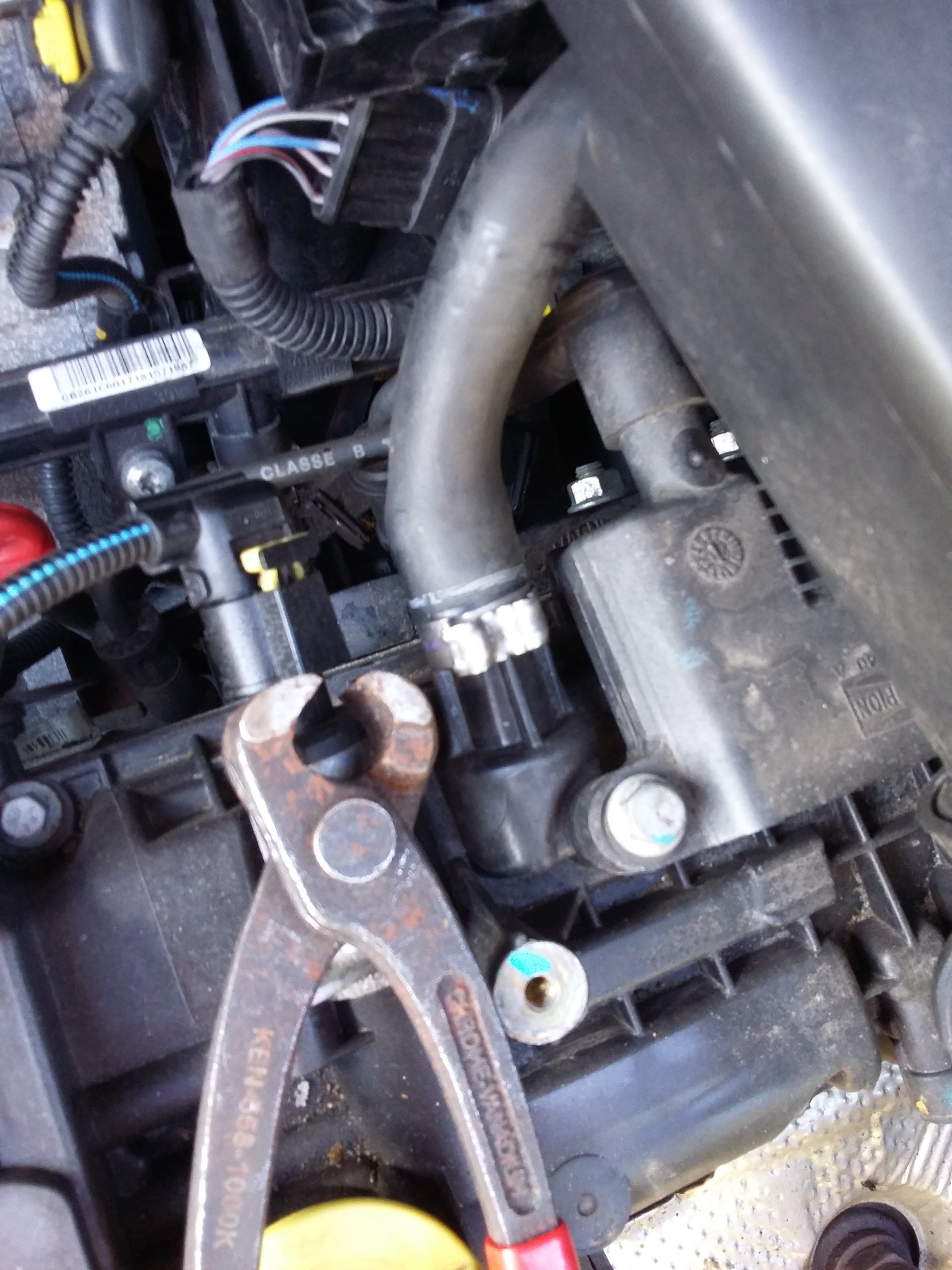

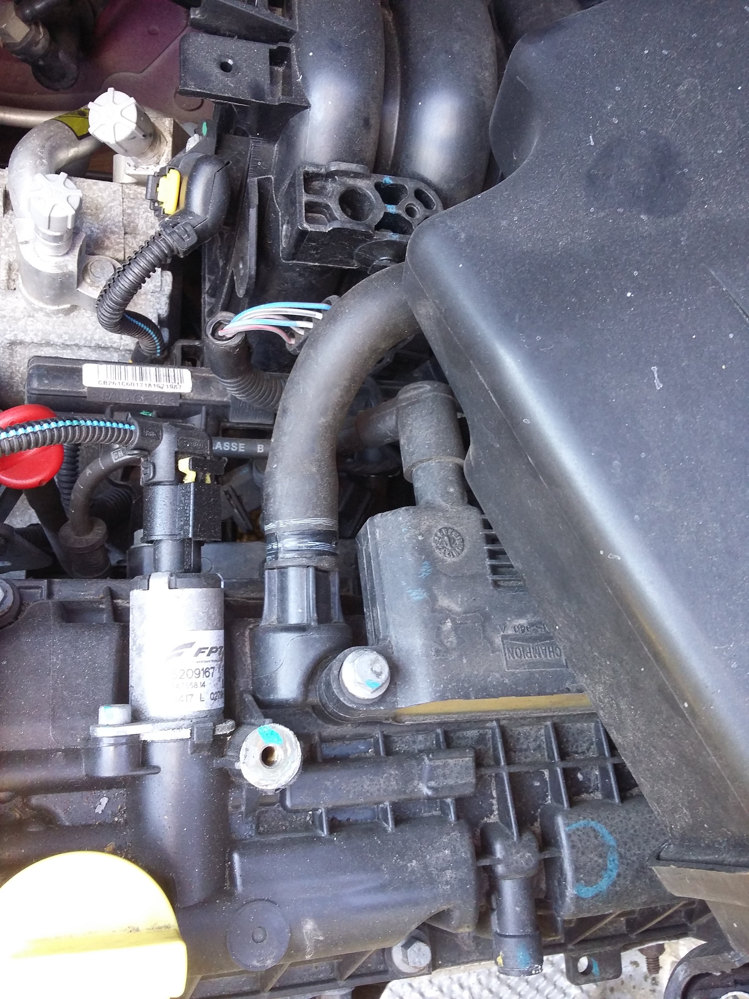

Slip Black Breather hose back onto the Camcover stub And position silver clip and Tension : close the clip
(I use pincer tool for that )
