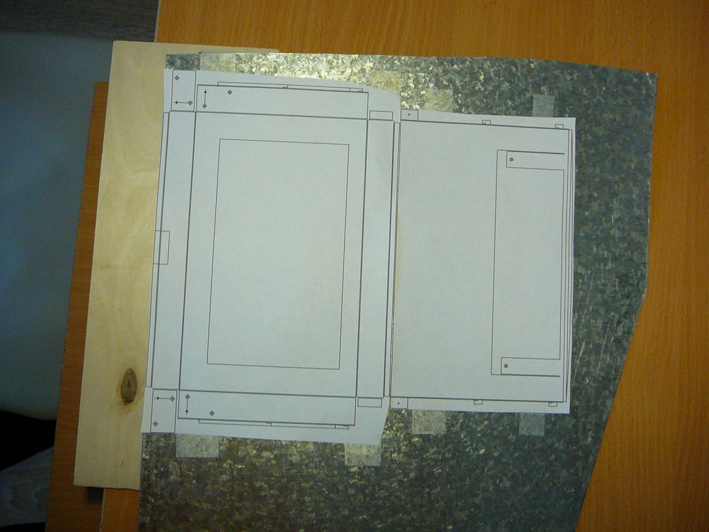

This is box for navigator. It made of tin-plate and has soft bumpers inside for protection of navigator from scratches and vibration. It has window for good satellite signal receiving. Navigator is Ritmix RGP-665. 912C platform, 800x480 @ 6", BT, AV, iGO, Navitel.

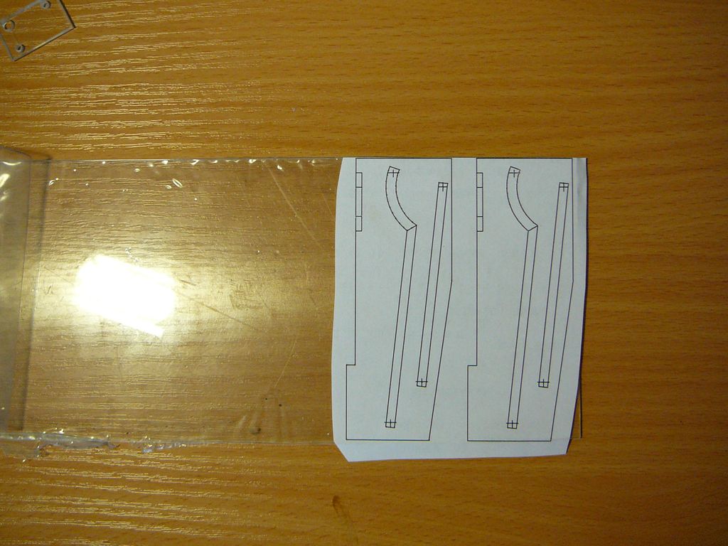

This is guide rail for navigator box.

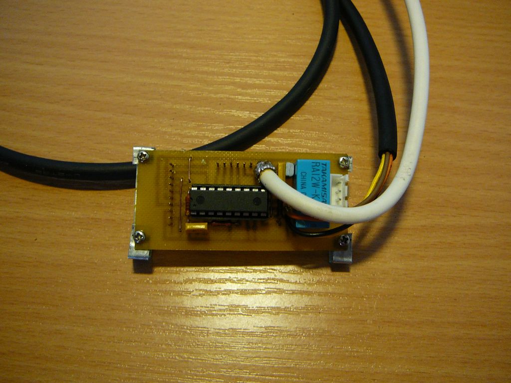

This is workpiece for electronic parts: power unit, control unit and optical sensors. I have used PIC 16F628. White cable is video.

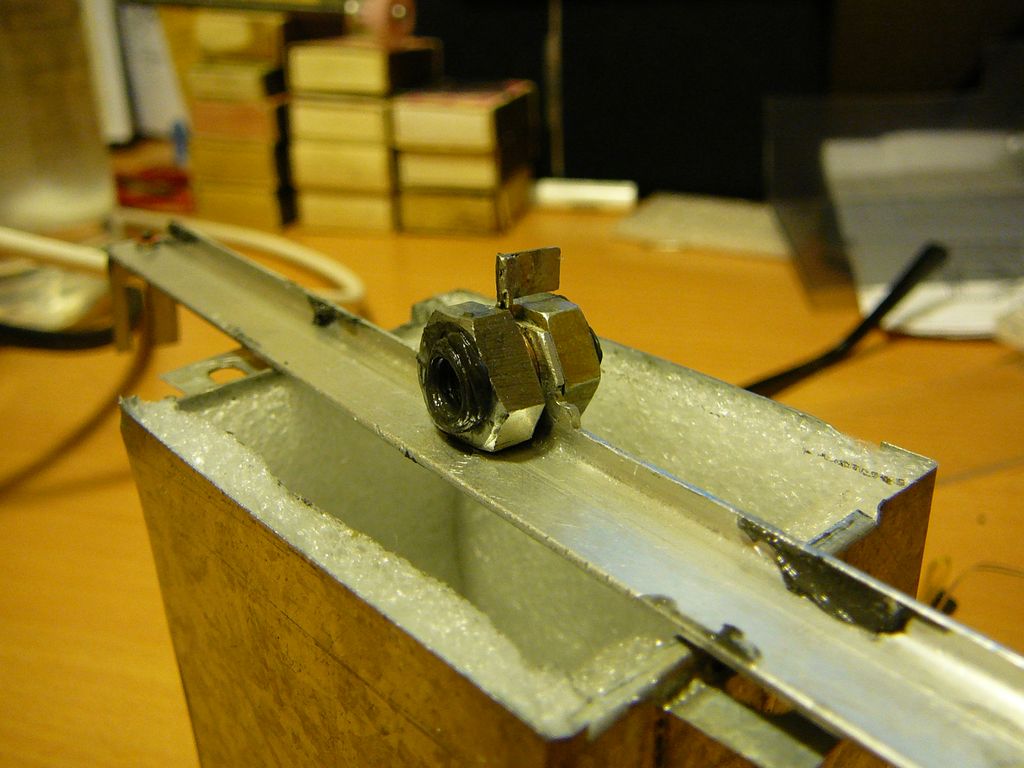

This is carriage which move box with navigator (upside-down view). It is DIN M8x1,25 bolt which have the hole with DIN M6x1 screw-thread inside. There is flag closing optical sensors at upside.

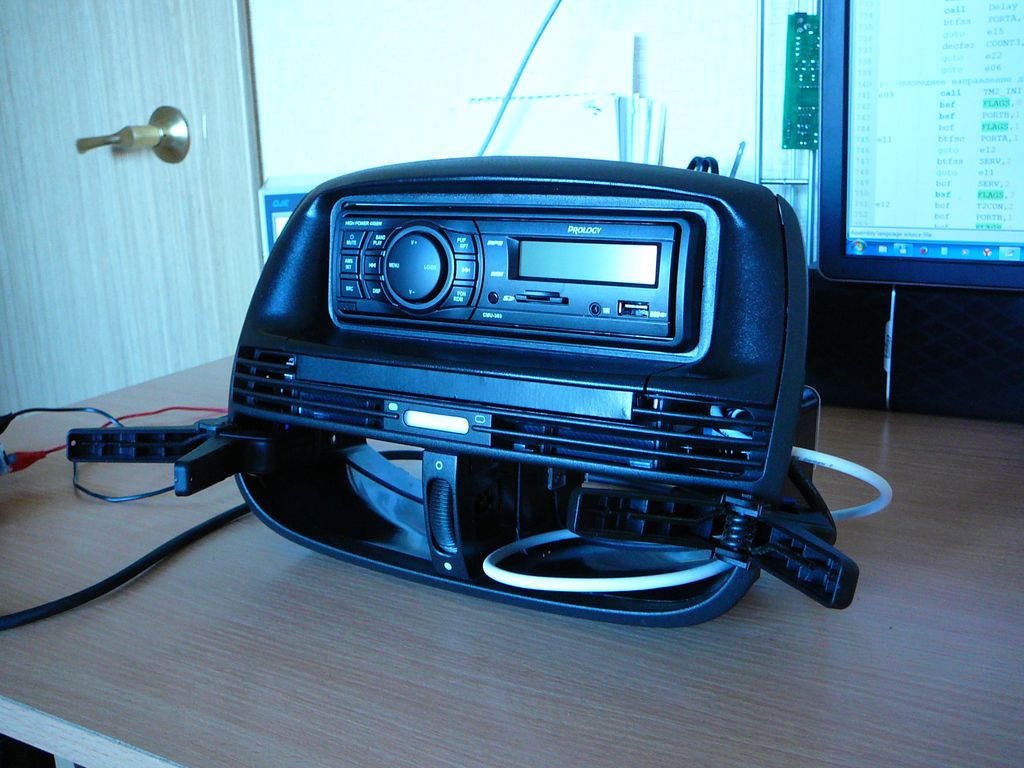

My device from different points of view.

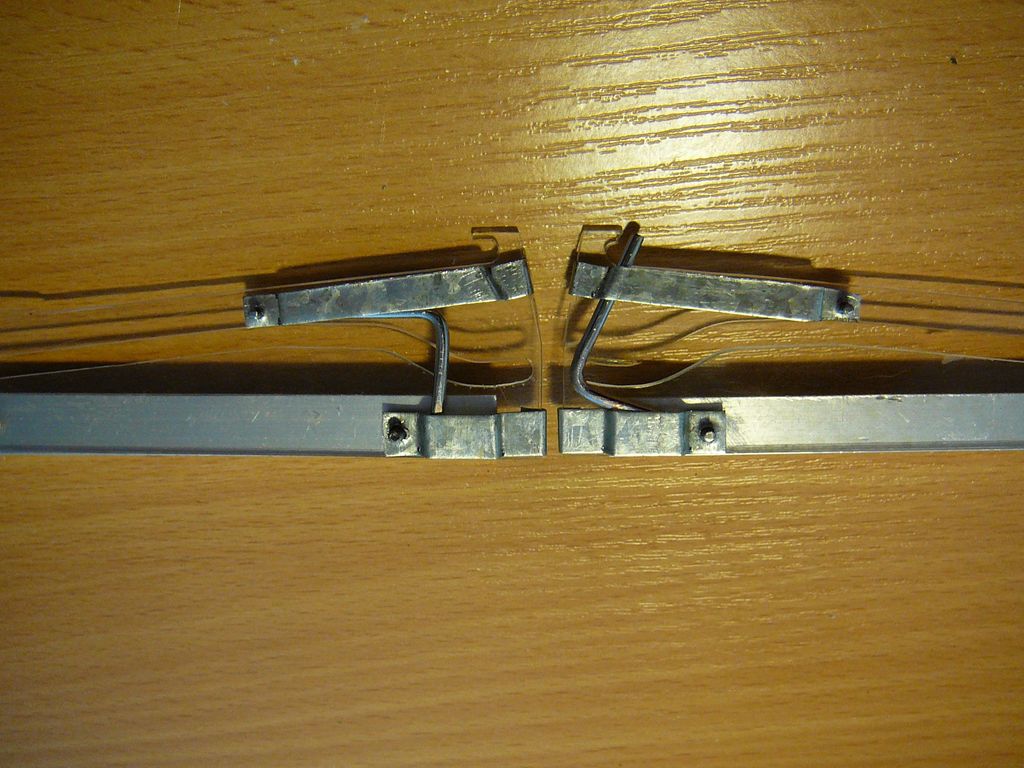

To avoid monitor moving when I press touchscreen, I've made these locks.

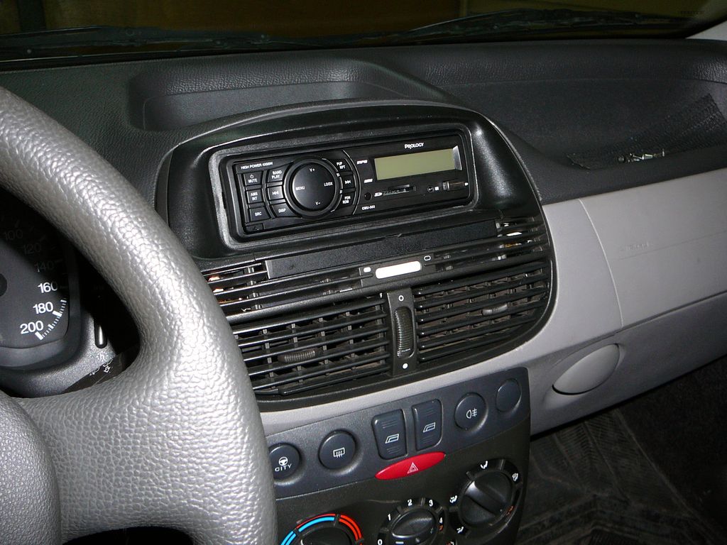

My device in car.

My device in car.
