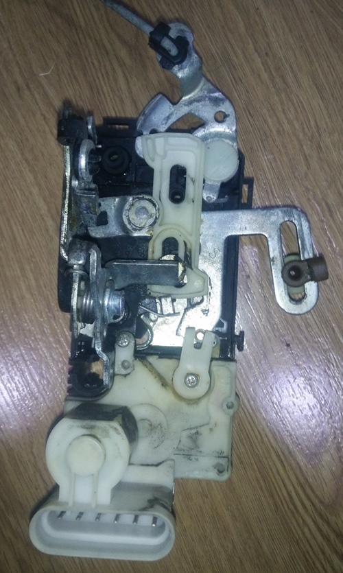

First you need to pull out the lock from car

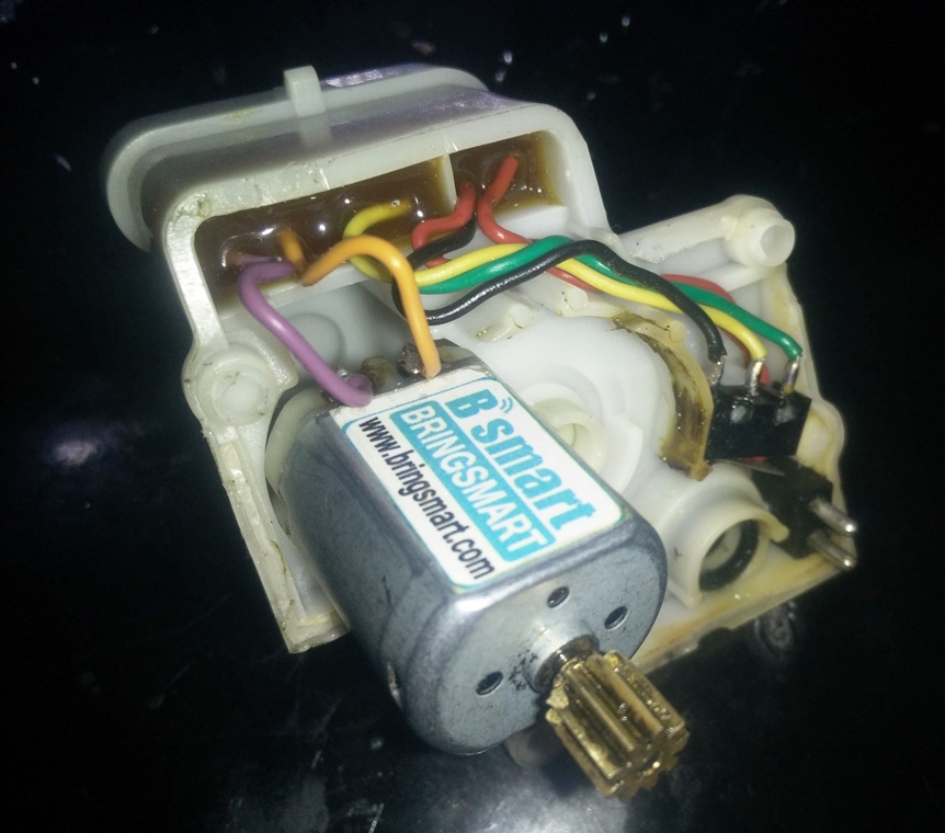

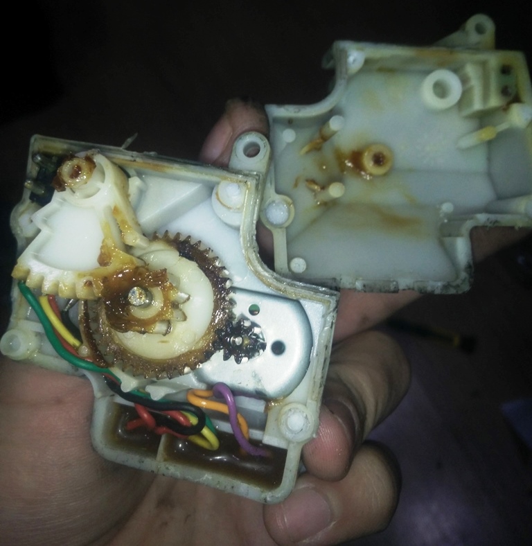

now you need to gently open the lock cove

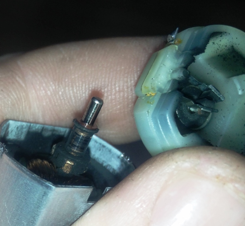

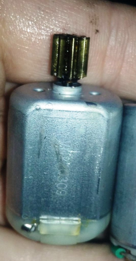

this motor need to change...
i order new one from AliExpress...
do not confuse the polarity when you solder wires to motor

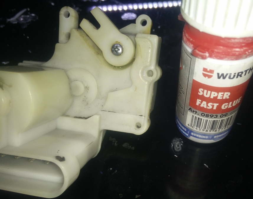

now need to close back cover i use cyanoacrylate glue (super glue)
ready to use :cool:
