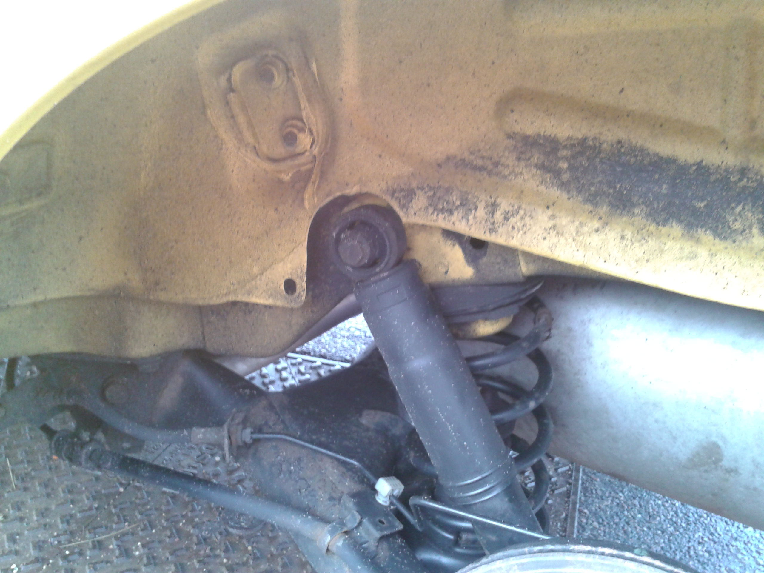

Removing
2 bolts that hold the rear shocks in place

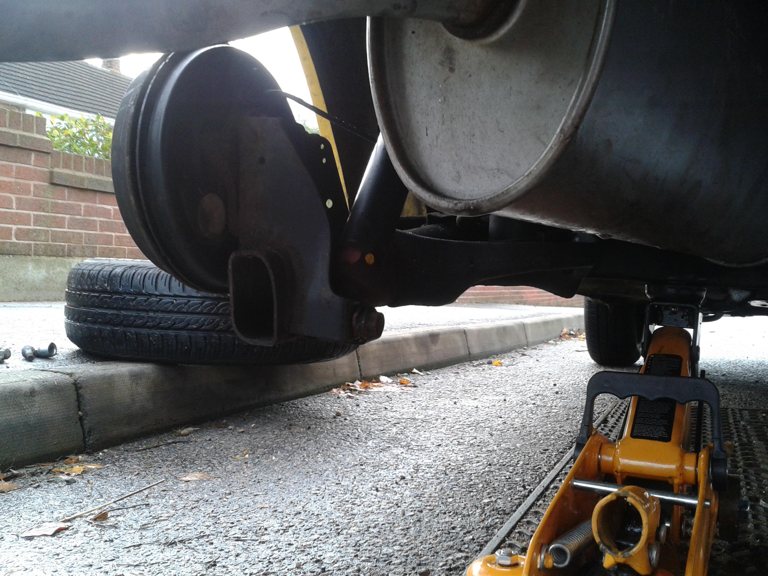

Bottom
The top bolts never have been a problem for me really, but either way
Removing the top bolt with a snug fitting socket/spanner
The bottom bolts vary, my 100k mk2 punto caused me hell, and the bolts were proper tight and stuck, refusing to budge and ended up snapping them
Mk mk2b 60k was a doddle to remove once cracked
The Bottom bushing can be a little stuck, a swift wiggle tug and mine pop out with ease
