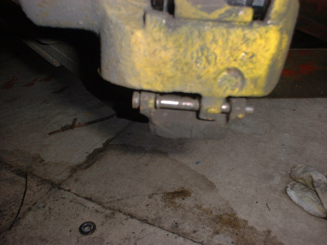

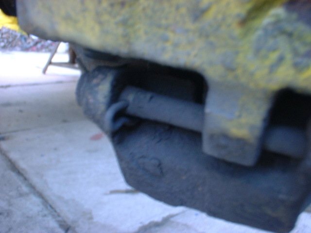

Look at the bottom of the caliper and you will see a pin, with a very small clip going through it:
Using a pair of pliers, carefully pull the clip out from the pin, careful as you dont want it flying over next doors fence, you will need to re-use it. The Clip:
Gently tap the pin with the hammer, go easy as you dont want the end of the pin to 'mushroom' as it might not come out, take your time, it will pop out quite easy after a few taps. When its part way out, wiggle it out the rest of the way with your pliers. The Pin & Clip:
