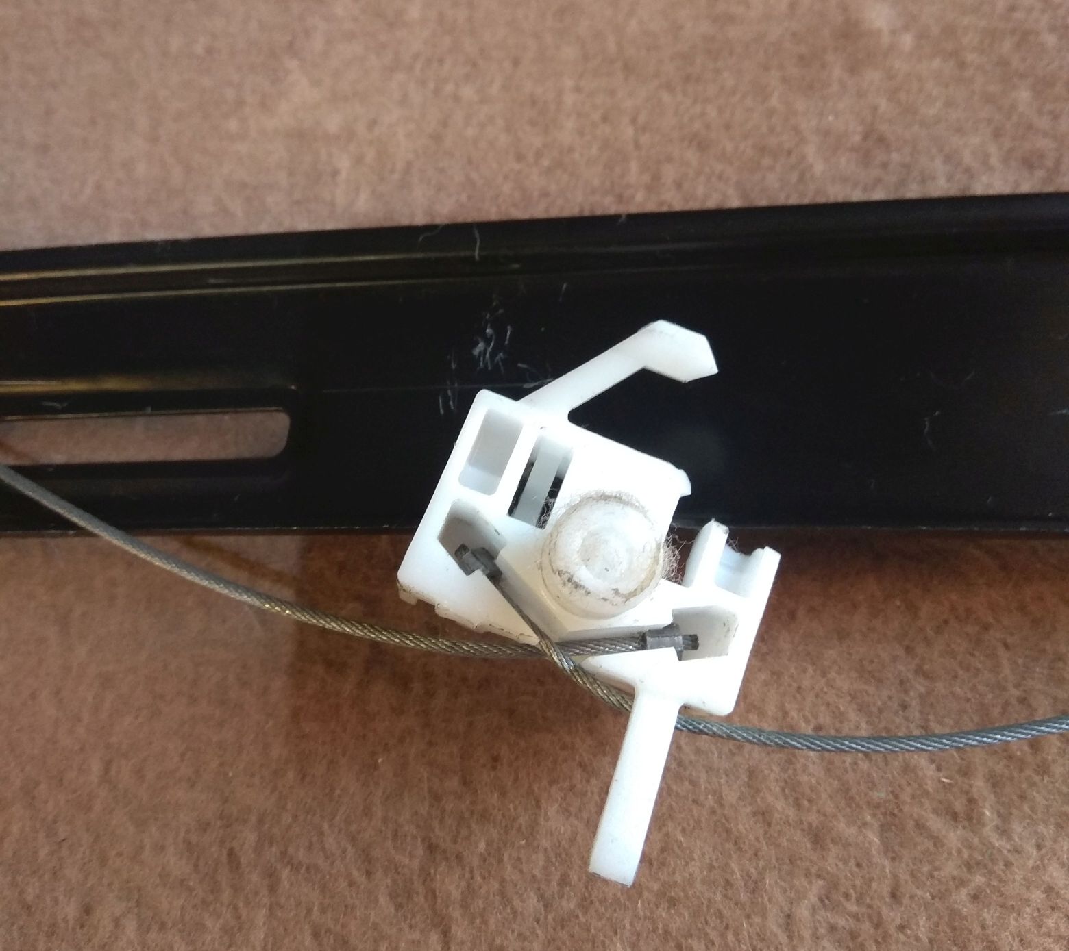

Remove door card and check that the plastic clip is indeed broken and not still attached to the window glass and its guide frame, If it is intact you may have other problems with your window.
Anyway, assuming the plastic clip is broken, remove electric motor and frame by unscrewing the five nuts that hold the electric motor and window clip guide frame in the door.
You should then see a broken clip

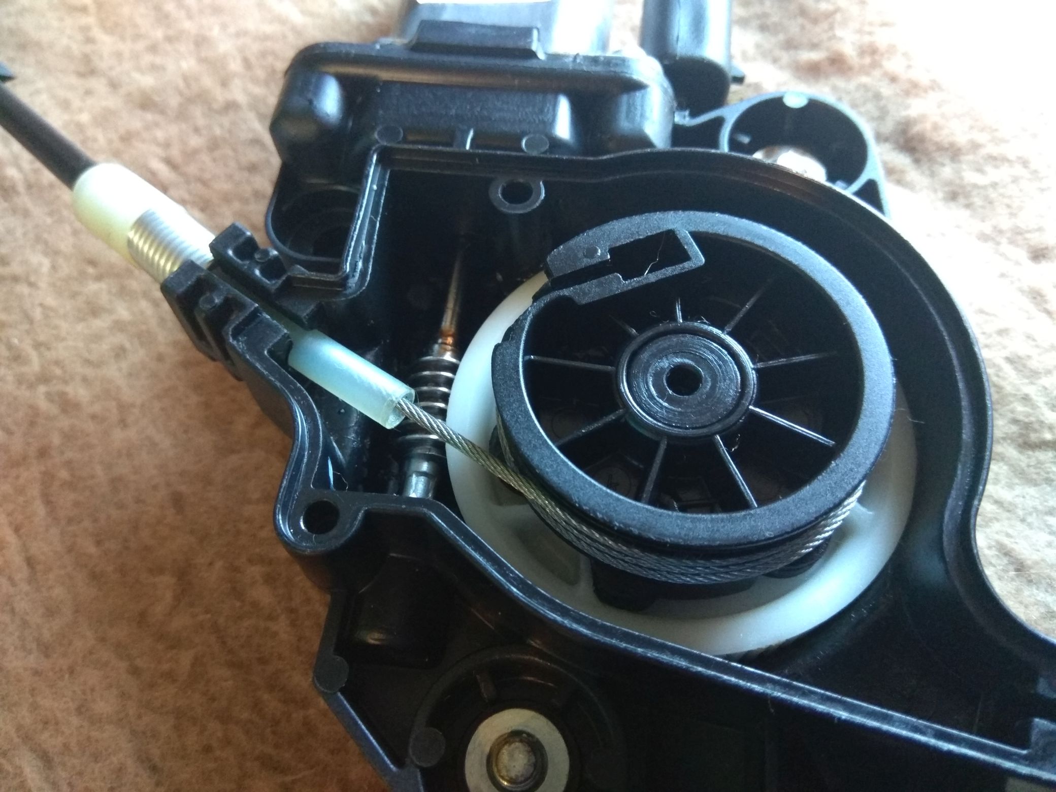

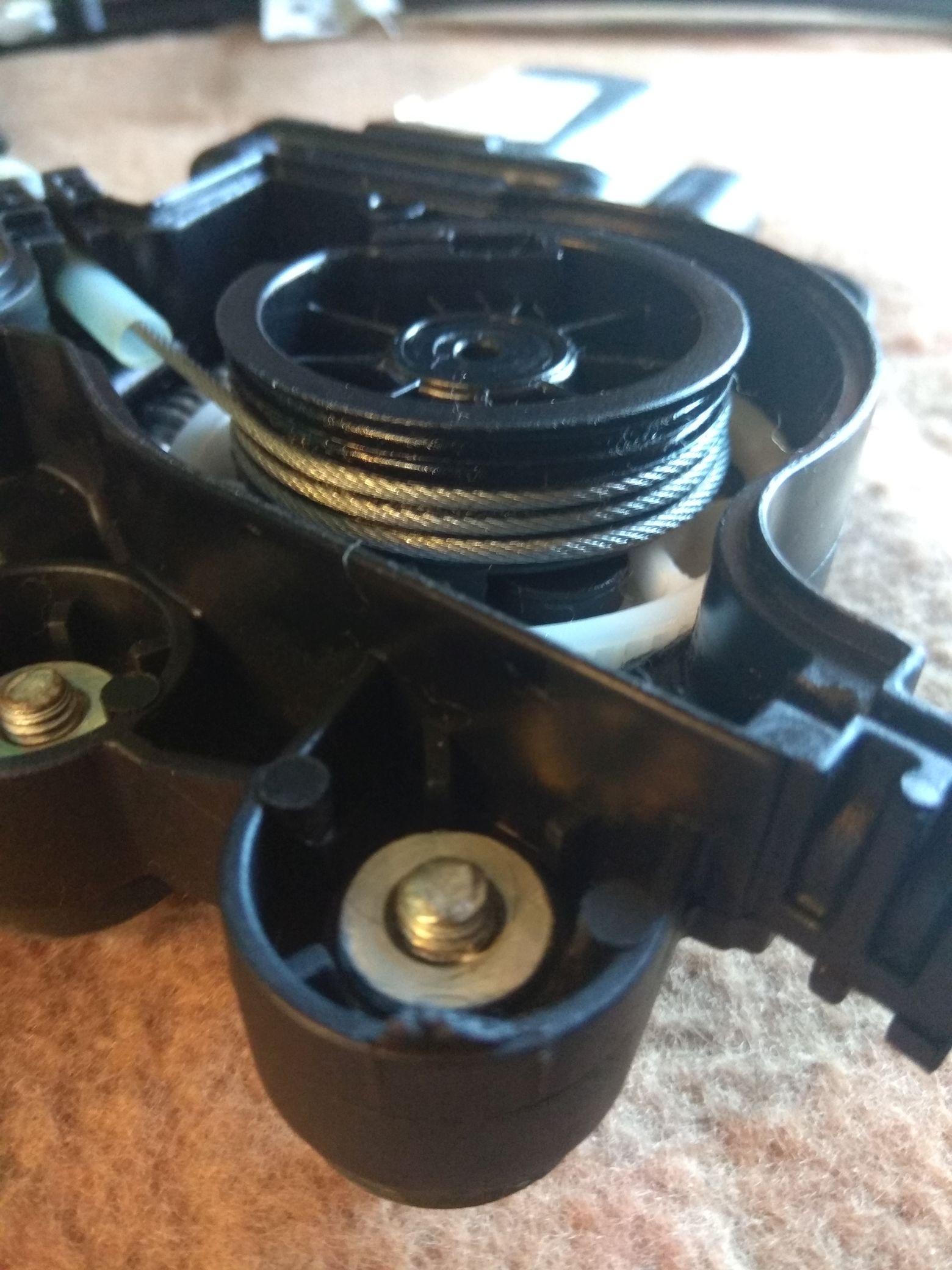

You will then need to check out the motor cable spool, open it by taking the three screws out with a Torx TX15 bit.
Opening the motor spool cover will probably reveal a mess of twisted cables
Detach the upper cable from the motor spool and put to one side.
Take out the spool and rewind the lower cable back onto spool
Replace the spool (with just the lower cable attached) into housing

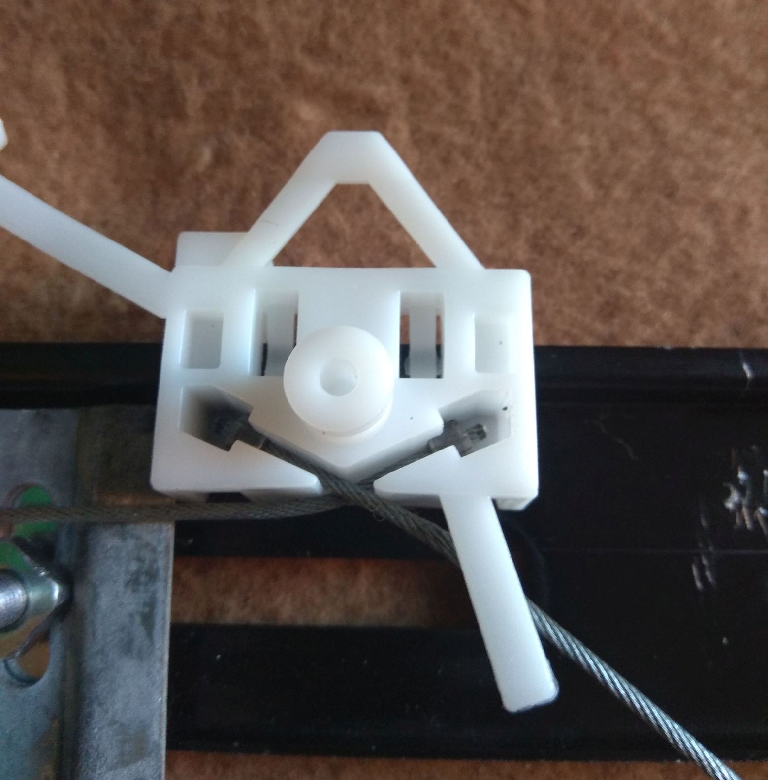

Attach new plastic clip to top of guide rail.
Insert free end of lower cable into slot in clip.

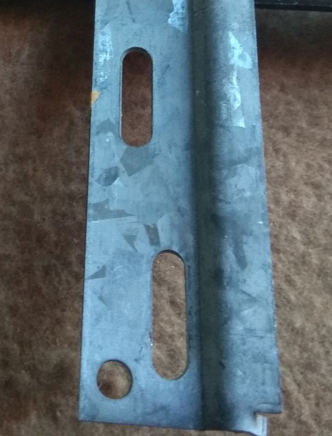

Affix plate to top of rail as 'barrier' to prevent clip moving

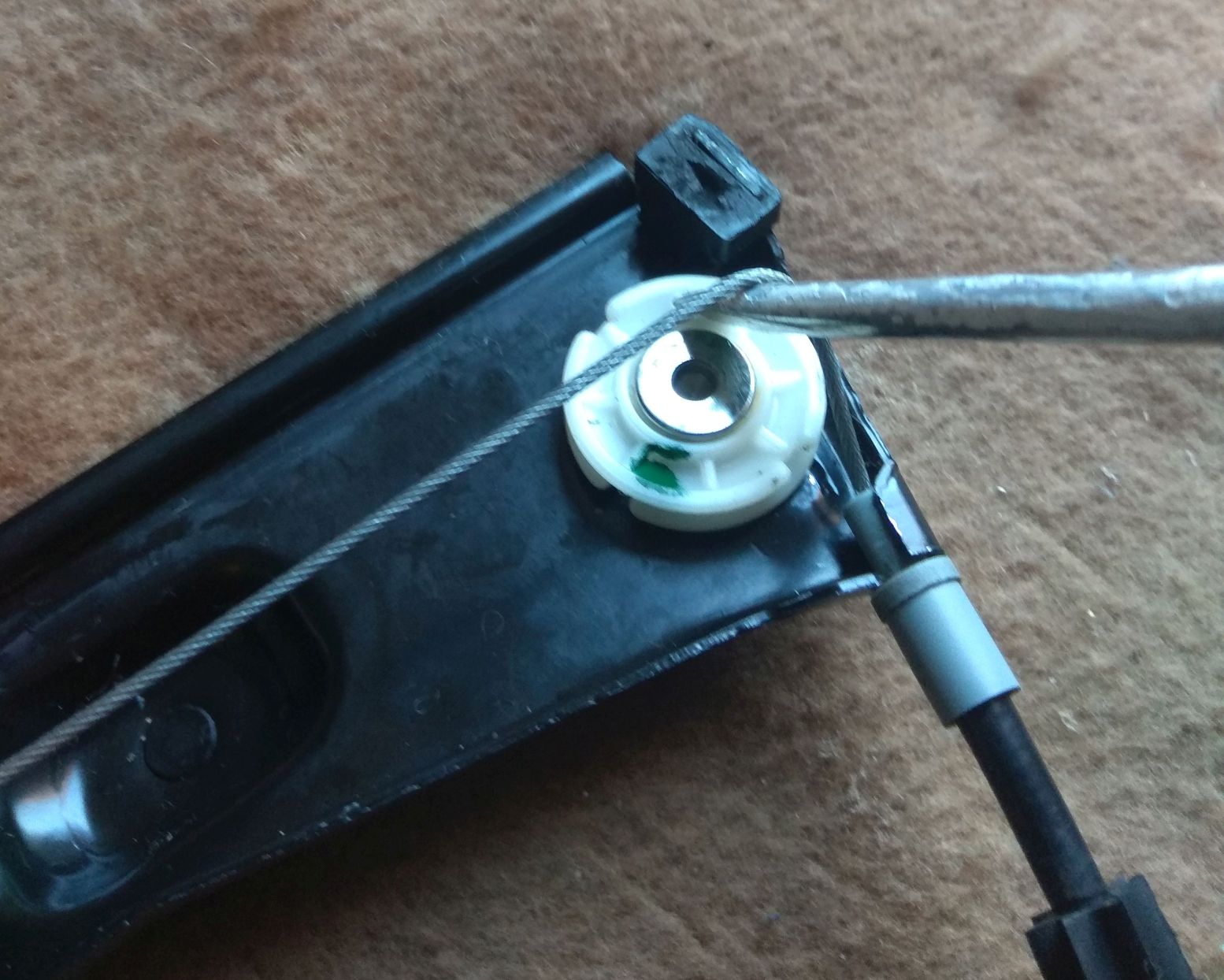

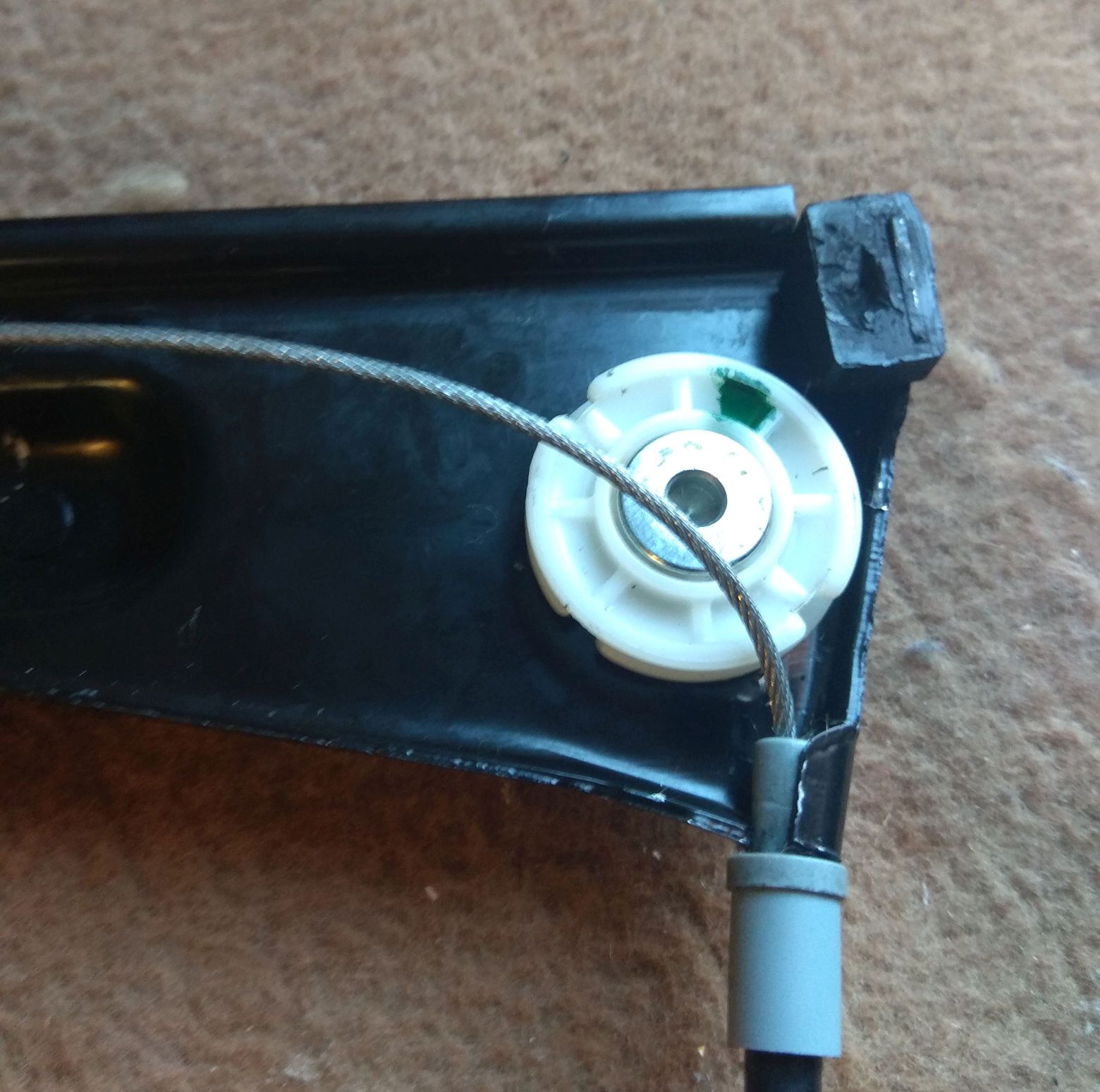

You will then need to lever the upper cable over the pulley
You should then have an assembled window motor cable frame.
