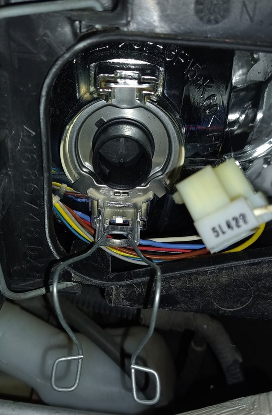

Next, remove the existing bulb by pulling off the three-pin-power connector, undoing the two springy wire-hooks atop the reflector housing and carefully wiggling the bulb from its position.

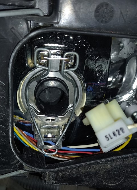

The unit won't fit directly; the springy wire-hook isn't really designed to accomodate the fan/cooling thingamabob protruding backwards from the mounting plate of the unit. Luckily this mounting plate comes off the unit through a bayonet-like twist-action (rotate the unit counterclockwise in relation to the plate):
Install the mounting plate, plastic ring facing out. It goes in in only one position.
Snap closed the two springy wire-hooks to fasten the mounting plate to the reflector housing.
