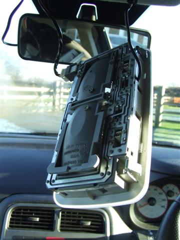

First job is to remove the interior light, this is done by simply pulling it down from the rear, it will then pop out.
Make sure all switches are in the off position. Open the door part on the interior light from one end.
It then took me a while to establish which metal strips did what. I decided to take my feed off the passenger light bulb so connected one end of the 3 metre cable to each side of the passenger light bulb. At this stage it doesn't matter which wire is connected to which side of the bulb. So I did not have to cut any wires etc I placed the cable under the correct bit of metal wire strip. Hard to explain really!!!!

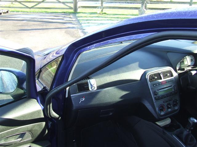

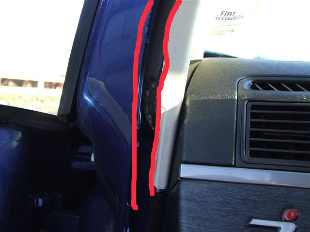

Pull the door seal off from where the roof liner starts, all the way down the front of the door to the bottom. You will see there is now a gap to place the wire in (between the two red lines!!!).

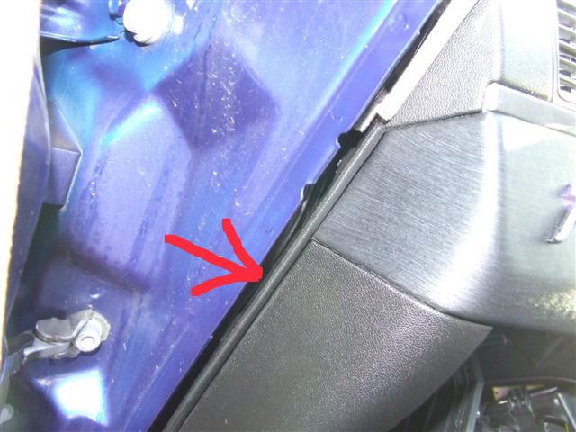

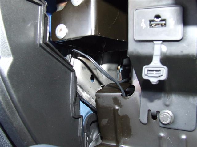

Take the other end of the wire and feed it through the gap from the door seal to the back of the glove box. Rough position shown by red arrow.
Place the wire in behind the door seal and reapply the door seal.

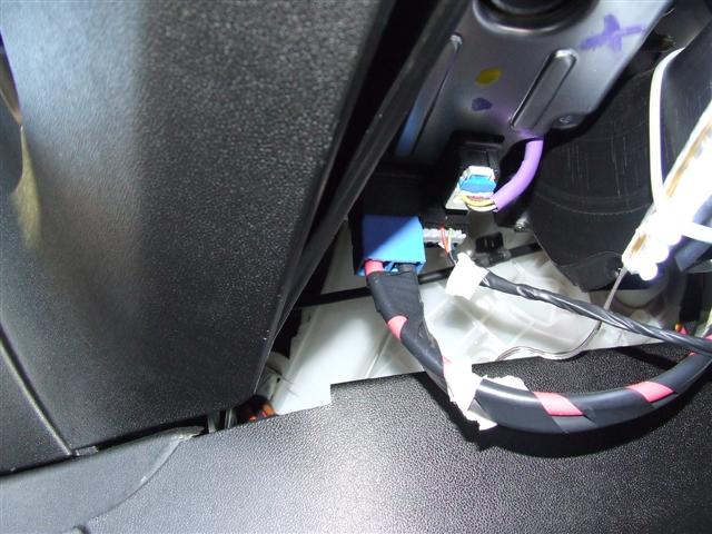

I took the wire from the drivers side behind the dashboard by removing the stereo, feeding the wire across and then out into the passenger footwell.

Test the lights which should all be working. Zip tie any loose cables up behind the glovebox out the way.
