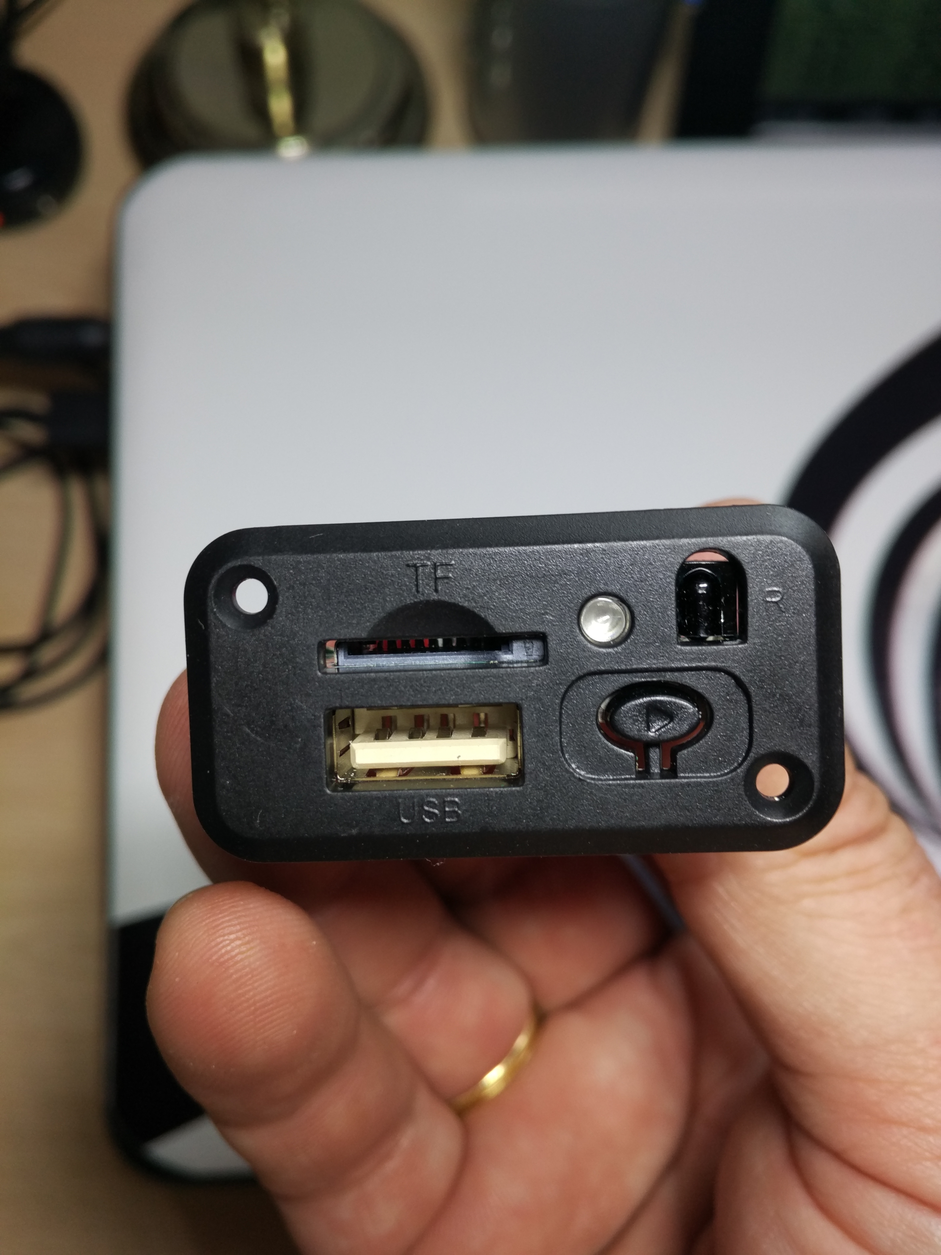

I want to collaborate, teaching how after this AUX jack, I have installed a small MP3 decoder panel and SD and USB memory reader.

The gadget that we will install, easy to locate in Asian stores.

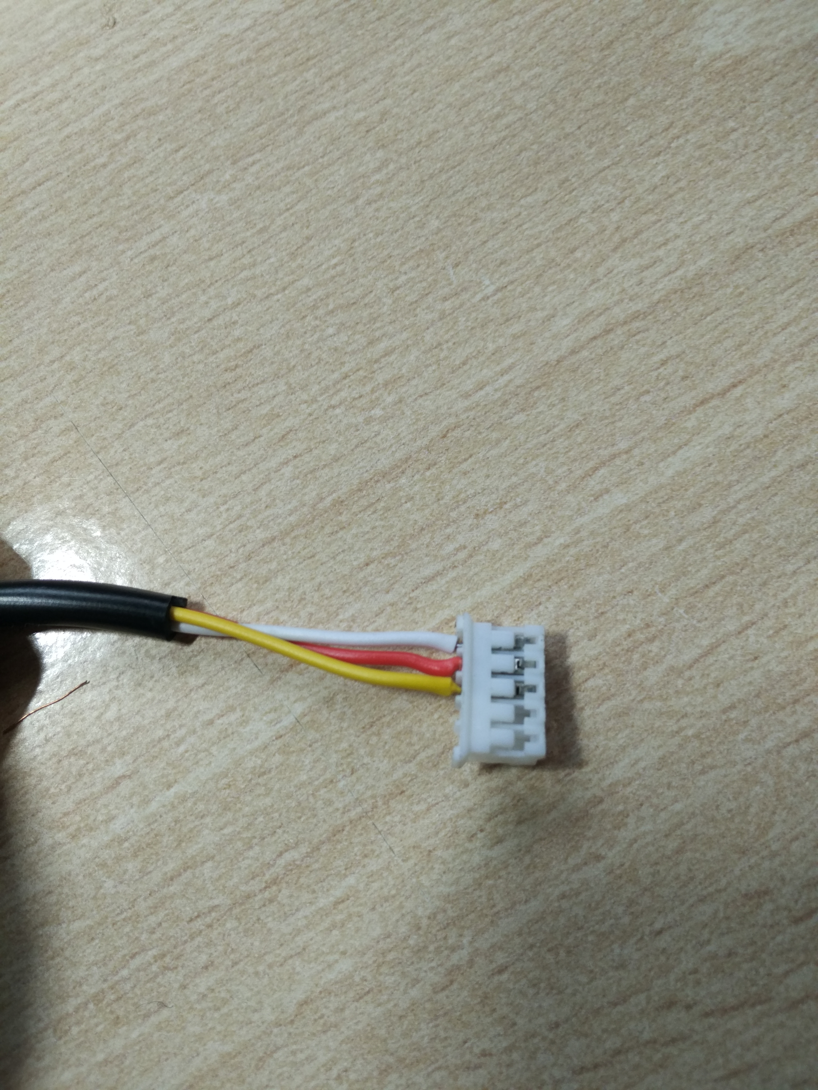

The connections.
Small to be able to host it in a good place.
Taking advantage of the AUX cable and adapting it to the plug of the gadget.
Remember the bridge so that AUX works in our car radio
The finished plug.
