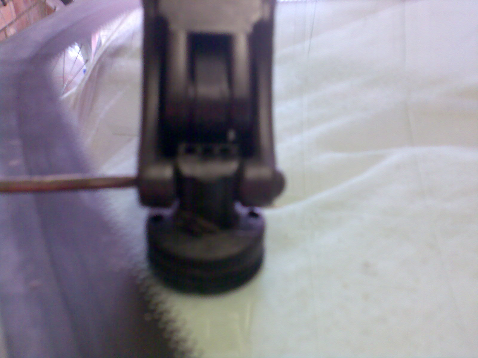

There is a pin going through this whick connects it to the window using small screwdriver push this pin out (pic 5.jpg).

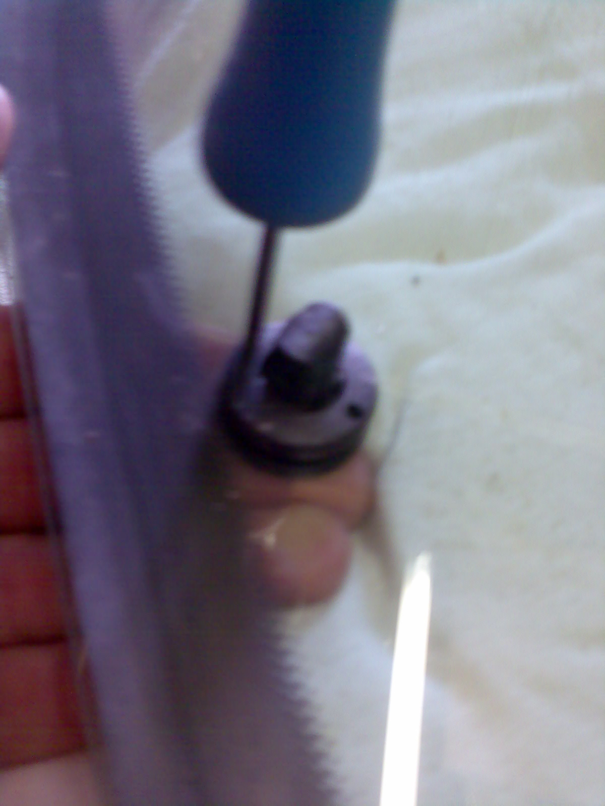

you are then left with a bit still connected to the glass, using the small screwdriver again locate it into one of the holes and hold underneath.then use the screwdriver to turn the ring anti-clockwise until it clicks it can then be removed (pic 6.jpg).

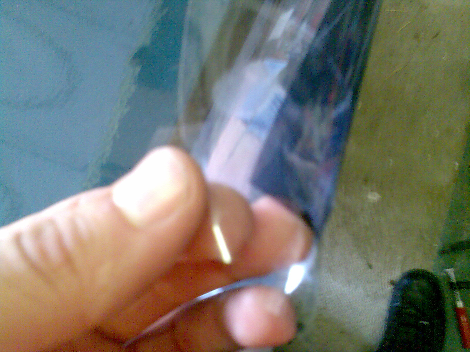

using your spray bottle and lint free cloth clean the window.:bang:The fun starts now!!:bang: take your tint and get two pieces of sellotape to seperate the tint from the backing plastic (pic 7.jpg), spray water on the tint as you expose it.

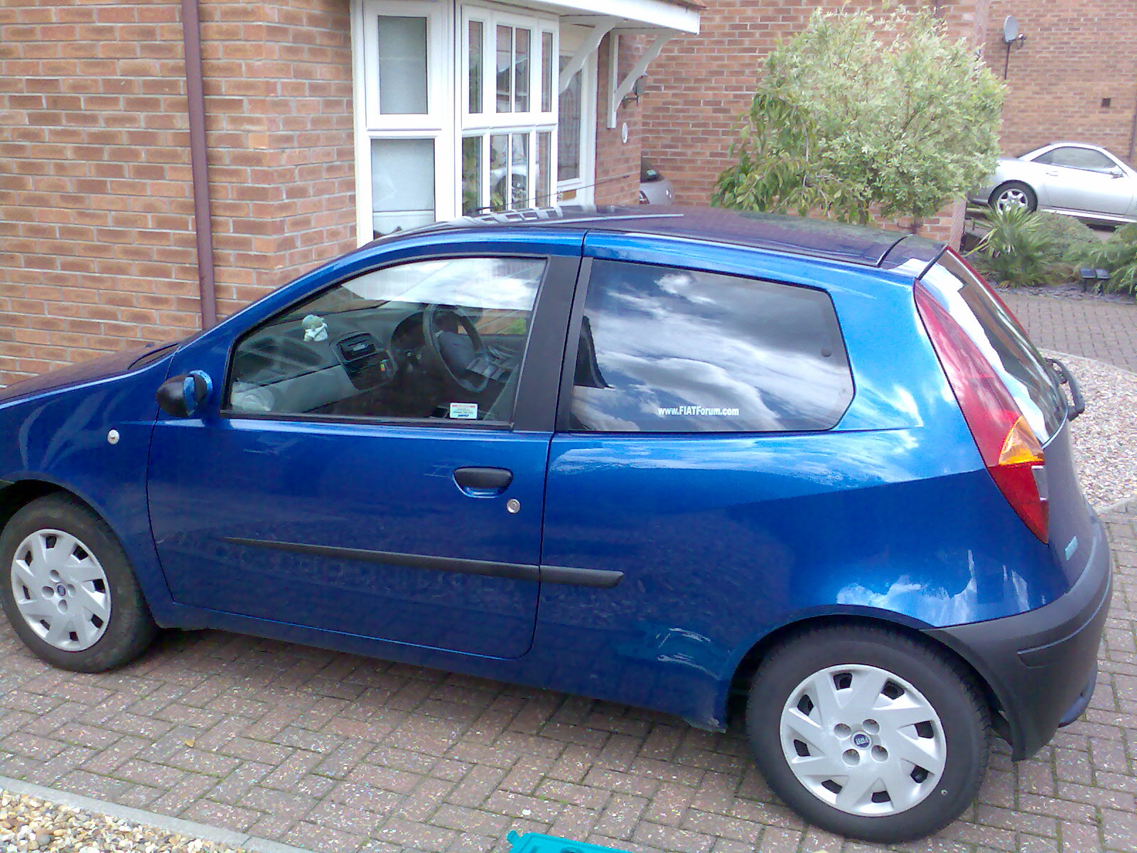

you now just have to cut the small hole out and refit everything in reverse to how you removed it. have fun and good luck. i hope you find this guide useful. finished (pic 11.jpg)
