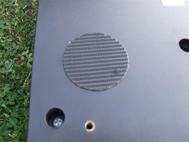

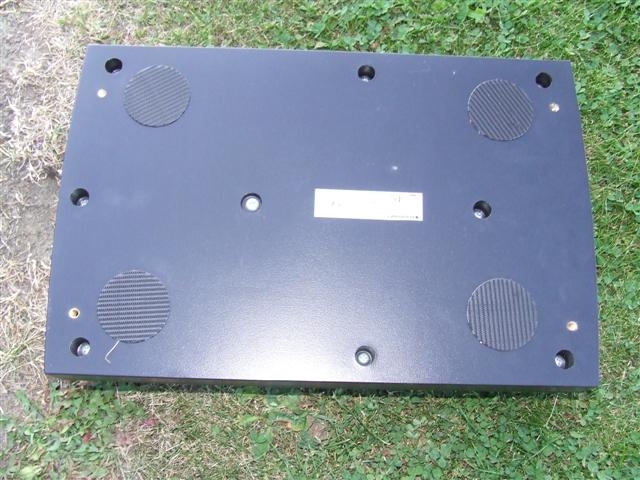

On the rear side of the amp, place one "spikey" velcro tab in each corner as shown in the pictures.

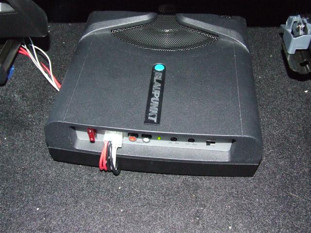

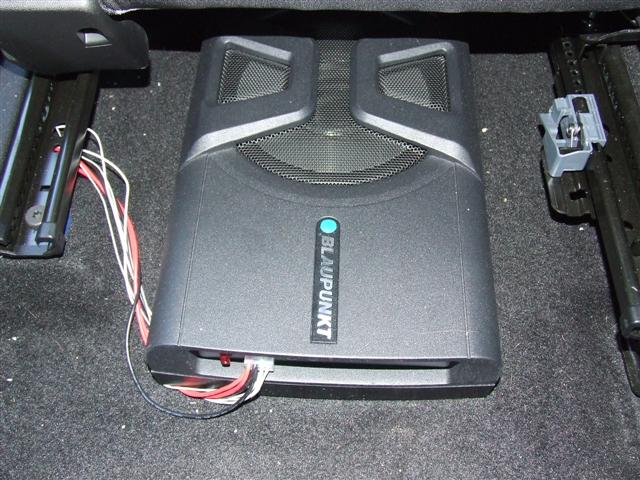

Place the Blaupunkt amp under the seat of your choice (in my car it's under the passenger seat - which my girlfriend likes
Connect the high-level input lead to the amp. Now fead the wires under the seat rail and along to the front of the car placing them under the side trim. This can be taken off by undoing the screws as shown in the picture.

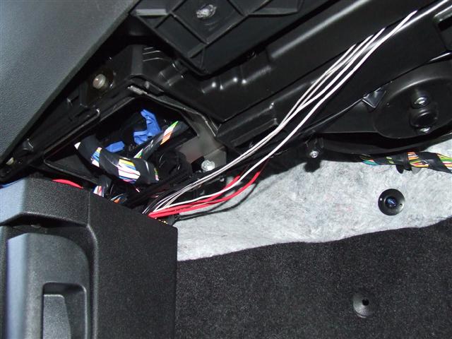

The wire then needs feeding up to the bottom of the glove box behind the trim. The wires can then be taken across under the glove box in the direction of the centre console. Keep the two red power cables at the left hand side of the glovebox as these need connecting to the distribution block as shown.

The next few pictures show the amp in place. This cannot be seen from outside the car so thieves don't know it's there!
