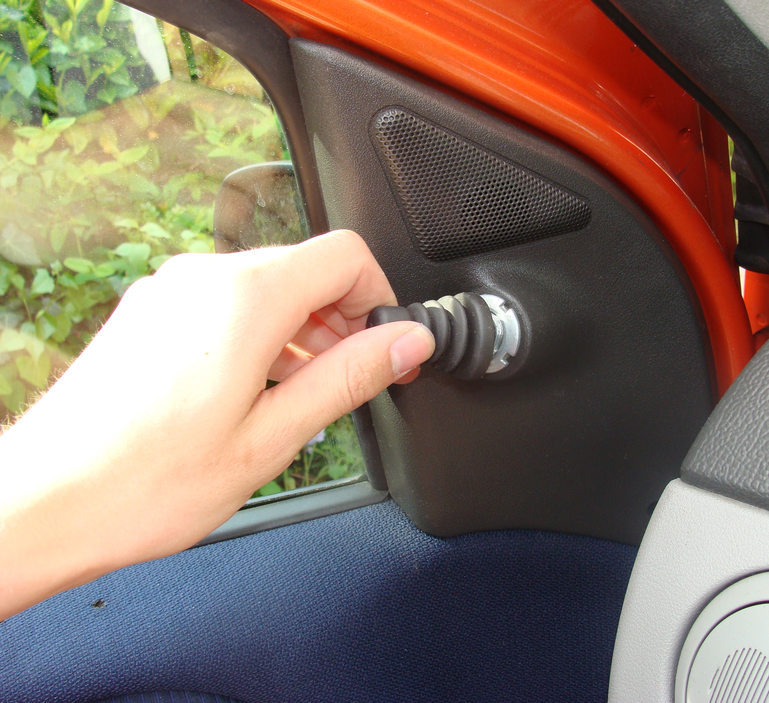

Step One (taking off the mirror for Mk2)
You need to take off the little rubber cover that is covering the mirror adjuster. You then need to unscrew the metal ring attached to this.
This rubber cover simply pulls off, lift the base of the cover off the metal ring and then pull it off.

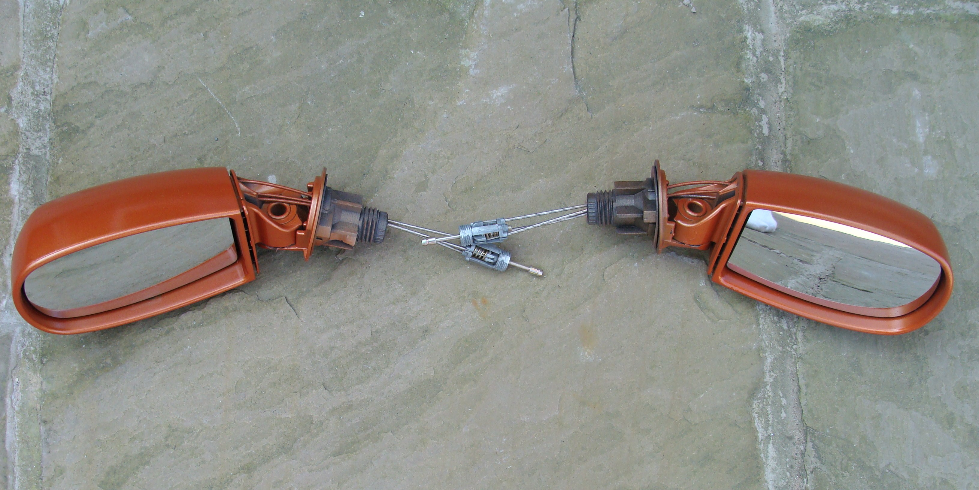

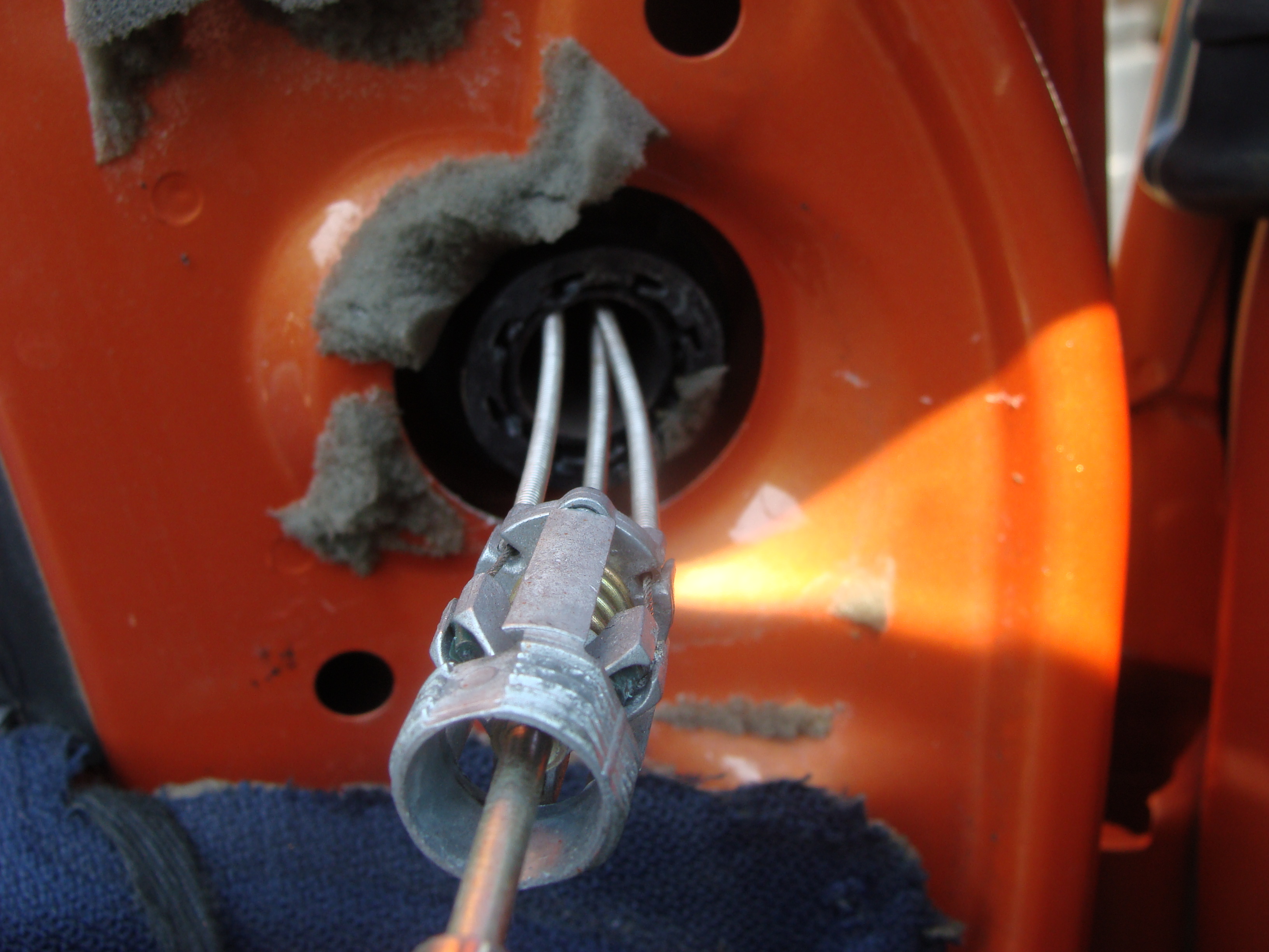

Step Two (taking off the mirror for Mk2)
You are now left with the whole attachment hanging on by the mini speaker wiring, just ignore this, it isn't neccessary to unattach this.
As you can see, inside the hole, there is a black ring and if you look closly it has little 'L' shaped holes. You need to unscrew the black ring. This is holding on the wing mirror. What i used is to use a chizzle in the 'L' shaped holes and hammer them round. It unscrews anti-clockwise.
Now you can just pull the mirror out with the metal attachments with it. The rubber sleeve just pulls off. We're now ready to colour code!

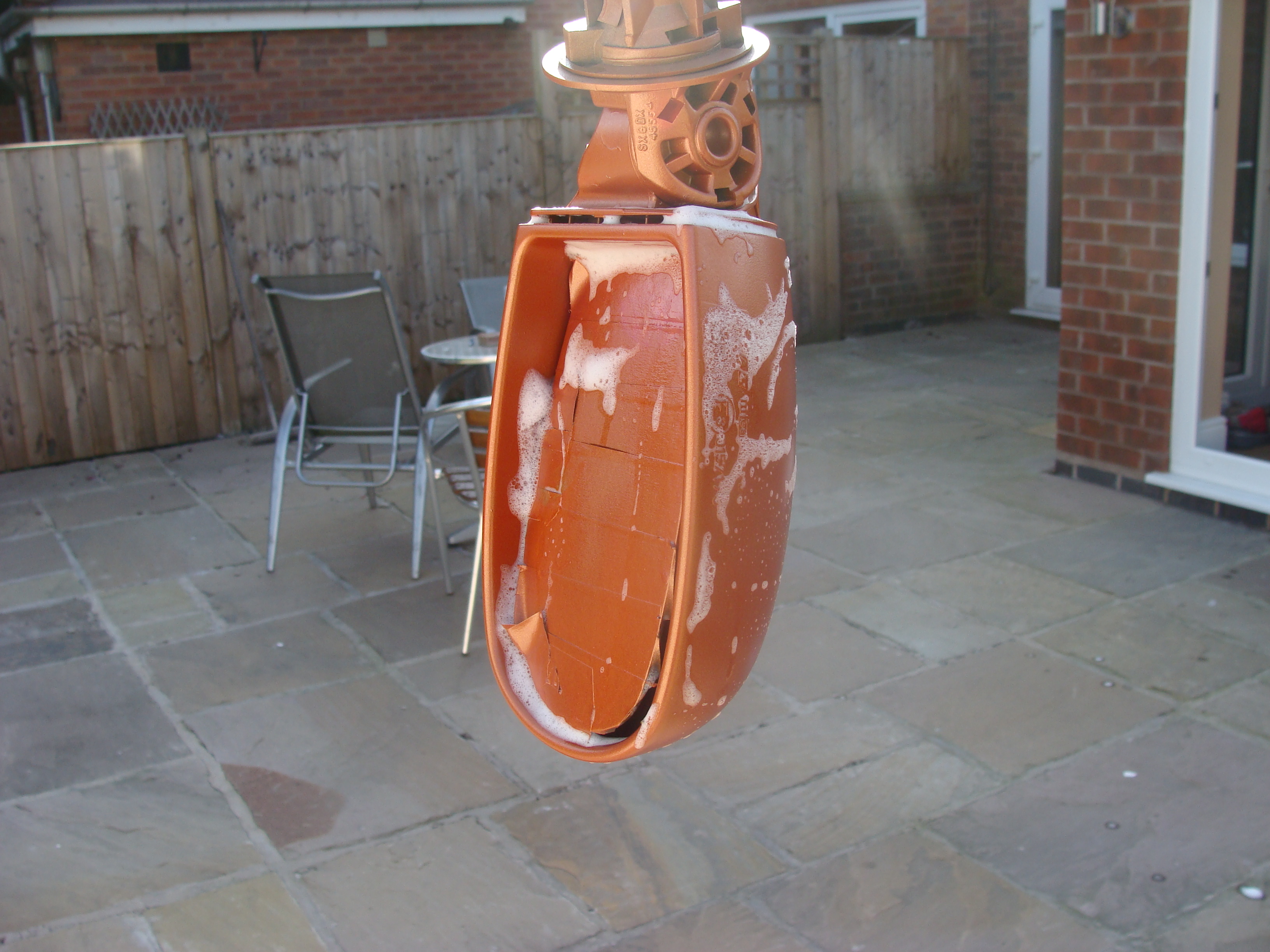

Step Six (Lacquering)
By spraying laquer on the paint it creates a weatherproof and driveproof shield on your mirror to protect the paint and gives the paint that shiny look.
As before i used THREE coats here.
As with the primer allow 15minutes for the lacquer to dry between coats.
Before you start spraying make sure you wash the mirror with warm soapy water (like in the first pic) to wash away the greasy stuff left from the paint so you can get a nice coat of lacquer (like in the second pic).

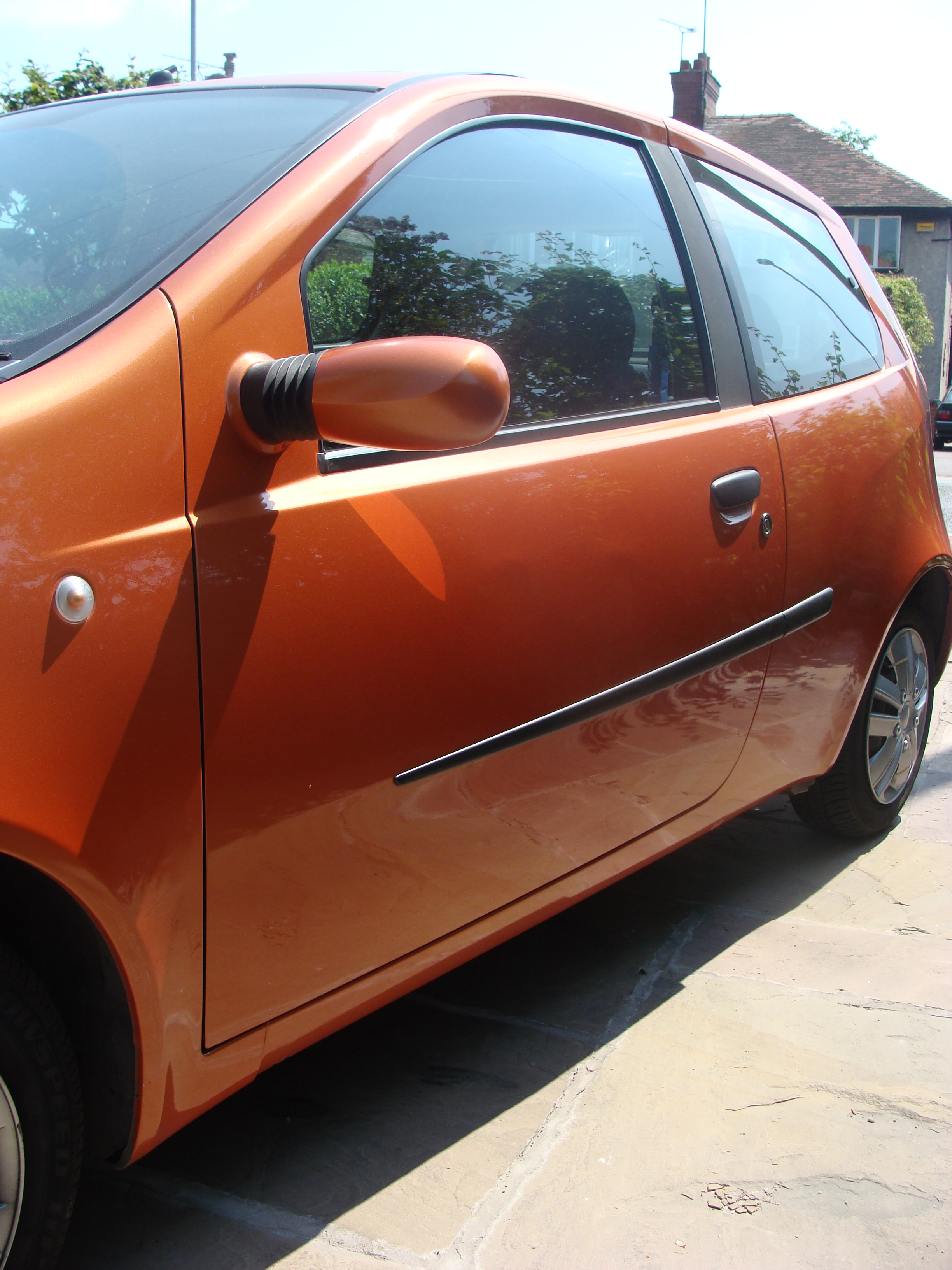

I hope this guide has helped, tried to make it as detailed as possible...let me know how you get on, good luck!
