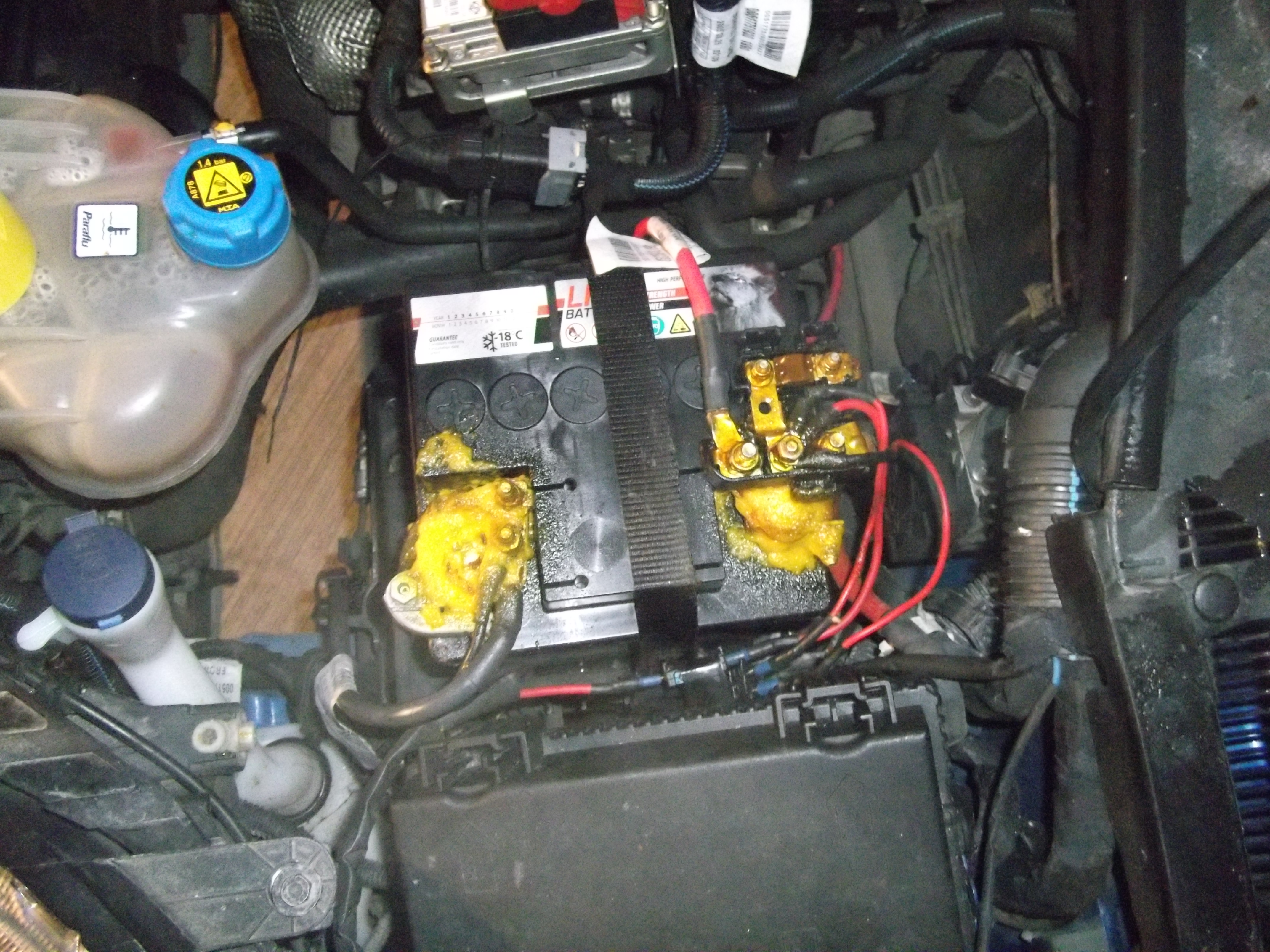

So remove the negative quick release clamp first and tuck out of the way (always remove this one first to minimise the risk of causing a short to the battery when removing the live)
now remove the plastic cover off the live post by squeezing the three tabs together
next using a 10mm spanner slacken the live clamp
and pull off and place out of the way
now using your 13mm socket remove the bolt which secures the locking plate and webbing strap over the battery completely
and remove battery
clean the tray and ensure the drain hole is clear of dirt and rubbish
and drop the new battery in ensuring its the same way round as the old one
and push it under the lip of the tray (if you stand next to the wheel put the battery in place and pull it towards you slightly its bottom edge will lock in place under the lip in the tray)
next put the strap and clamp over the battery and secure back down with a 13mm spanner (do this tight enough so the battery can't move in any direction)
next clean the battery posts and clamps with the wire brush and wire wool to ensure a good connection
and refit the live clamp and tighten up with a 10mm spanner
(tight enough so it wont move but not so tight you strip the thread or damage the clamp)
Now connect the negative quick release and tighten with the thumb lever
Spray / smear the terminals with battery terminal grease
and refit black plastic cover to the live terminals close the bonnet then hunt high and low for the owners manual to remember how to reset the clock on the dash
