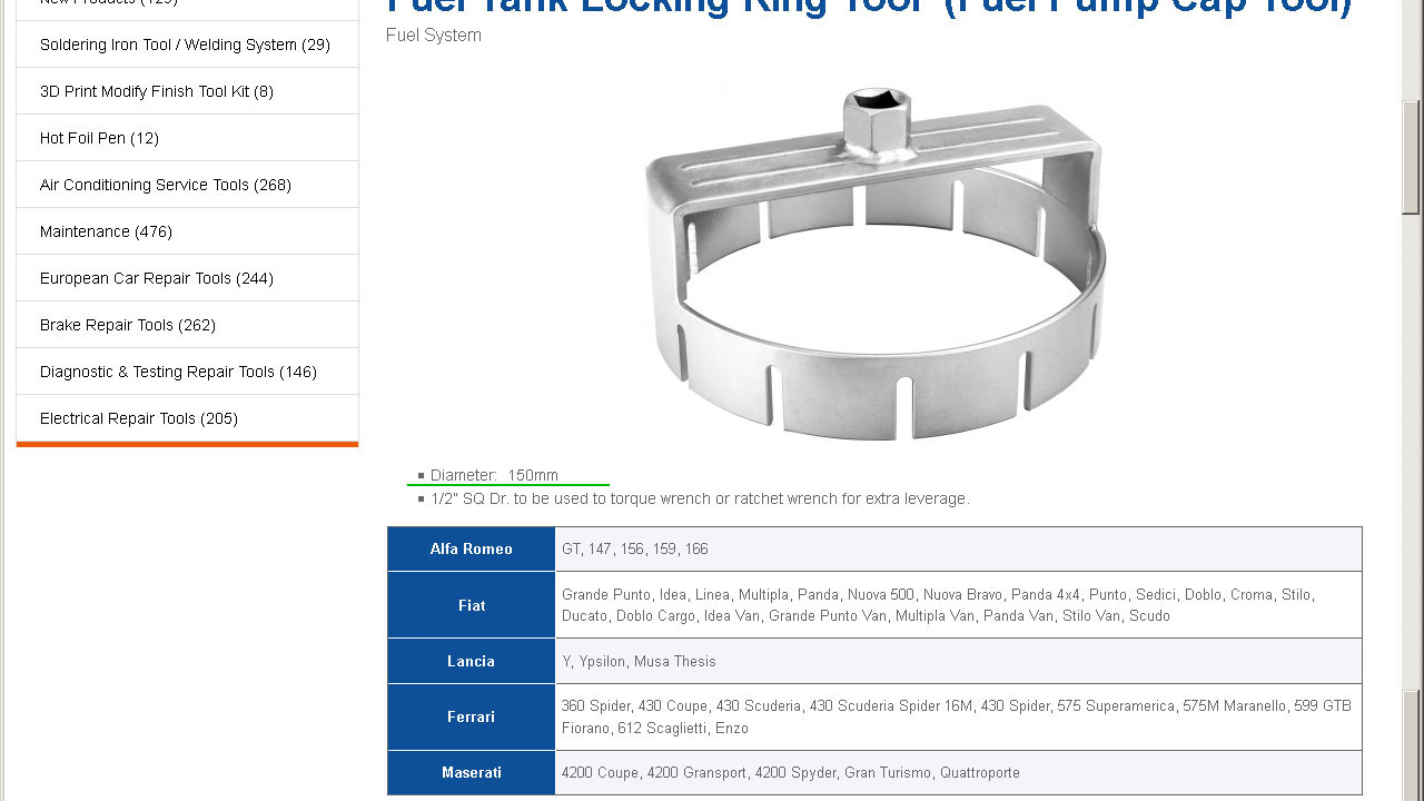

There are tools for undoing fuel pump nuts ("caps"). Like this...
...or this style ("ring"). Example website: https://www.autotool.com.tw/products/detail/5462.html

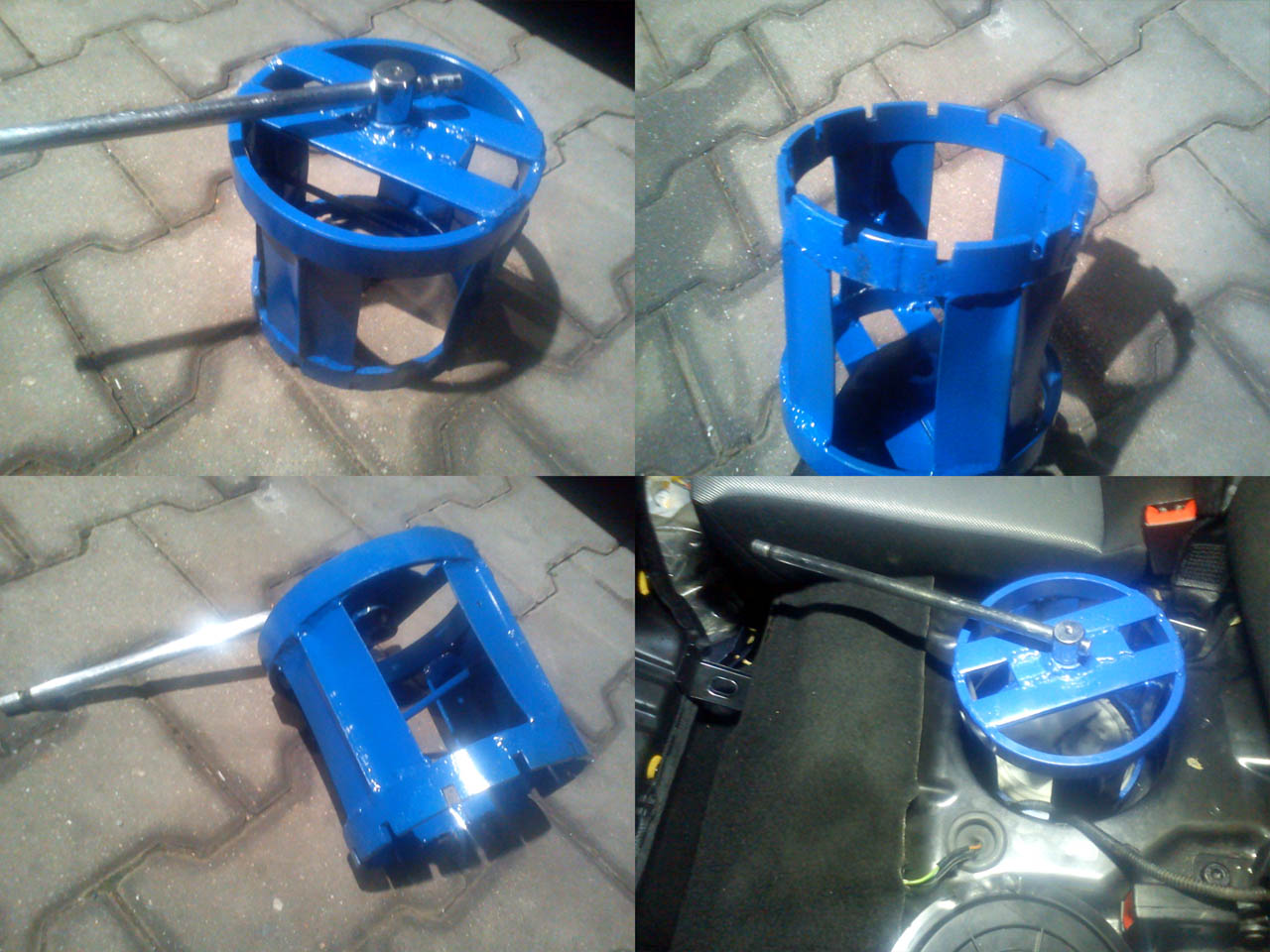

So the nut nominal size (OD) is about 150 mm. There are 12 equally spaced ribs (4 mm wide). That's enough info to make a DIY tool.
I've made my own tool, just because I can. Scrap metal + welder + angle grinder + file. Nut was very hard to undo (needed extension pipe on the T-handle + full body weight on the tool, to hold it steady on the nut)! That's the main lesson here, key point of the Guide. You may need a special tool, no way around it.
If you'll ever do such tool, you don't need all 12 ribs precisely engaging (hard to do), 3-4 touching is enough.

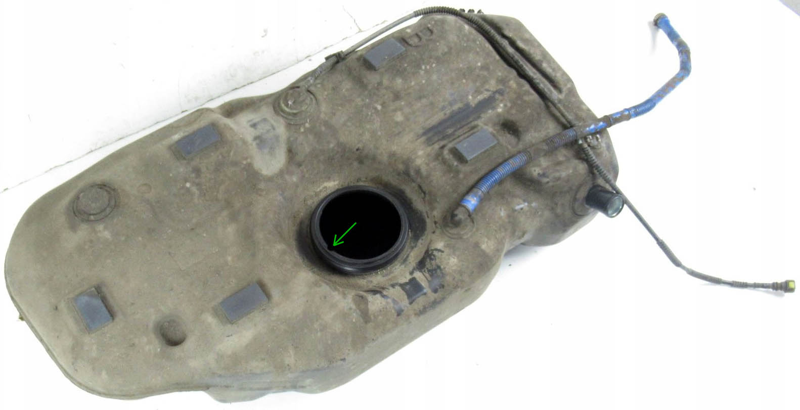

Mind the "clocking" (position) of the pump during installing it back in the tank. There's a "key" feature, cutout in the tank (and pump has a corresponding key).
