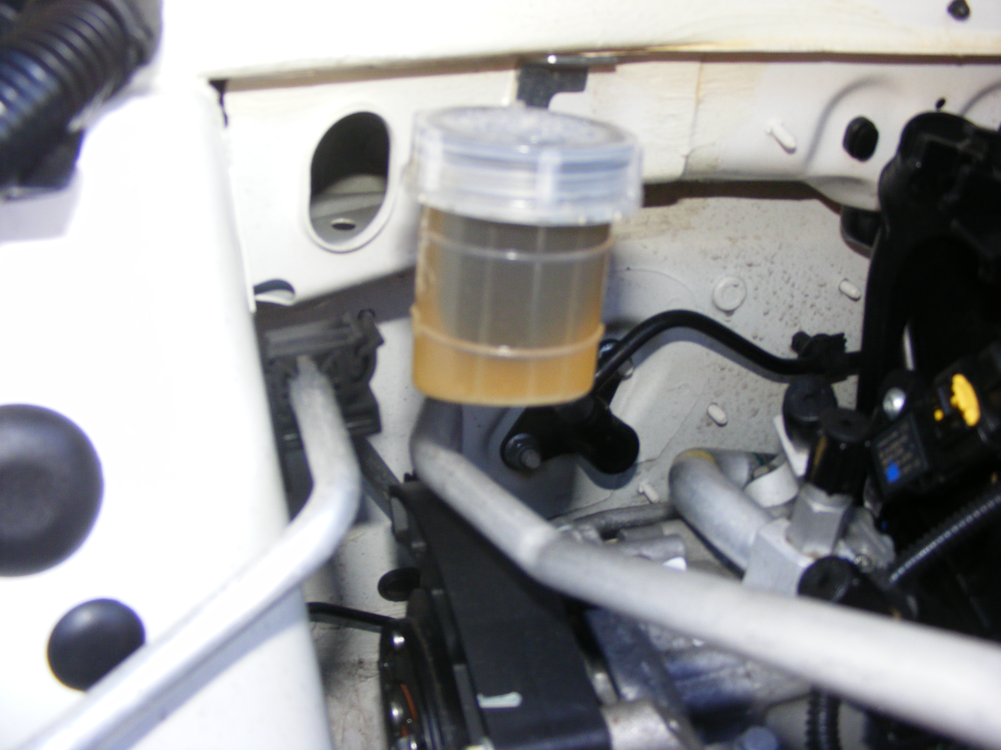

next check the clutch fluid its at the back of the engine on the right hand side if its over full i wouldnt worry too much since it has a "bellow"seal which can displace the fluid to make it look higher in level than it actually is but i would worry if it was near minimum mark...
nearly done....
next check the Brake fluid bottle (upper left of the engine bay)
again a torch is handy and check the fluid is between max and minimum markings which is embossed on the bottle
