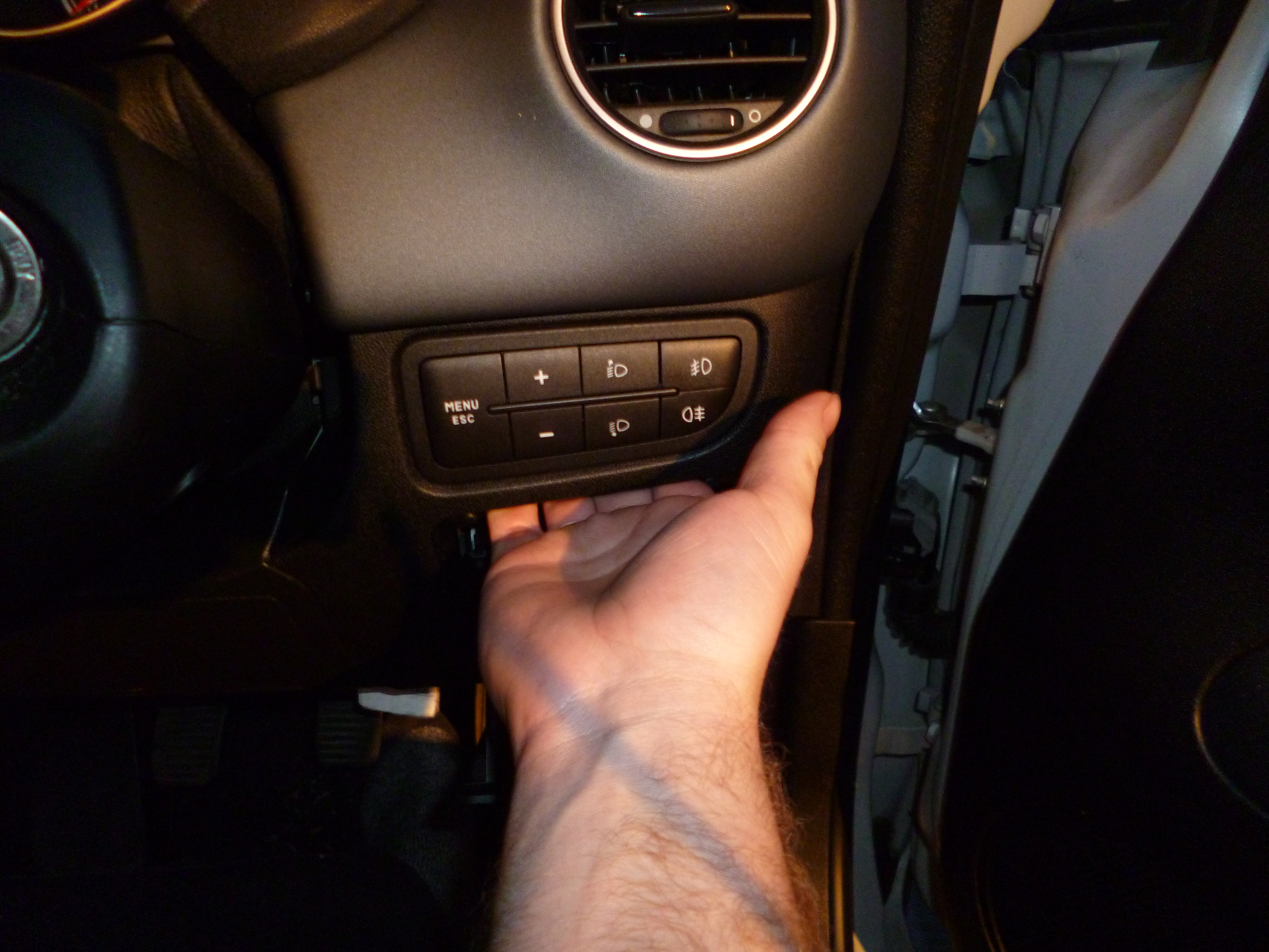

You have all the leads / plugs/ computer but where is the Port....
First open the little cubby by the drivers right knee......
and stick your fingers up the back of the fog light / menu switch array...
give it a good tug towards you...
Hinge it downwards
Locate the OBD2 plug and remove the cover you can see the OBD plug has a yellow band down its centre....
Then plug in your device ensuring it is the correct way round
Plug in your lead / adaptor and turn the ignition to MAR and follow the instructions that come with your chosen software / device...
