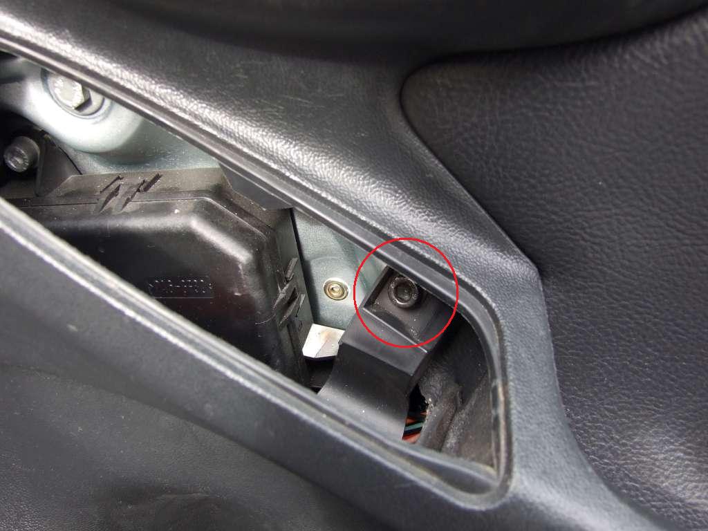

- Remove 1 (Allen) screw from where electric window control mechanism was

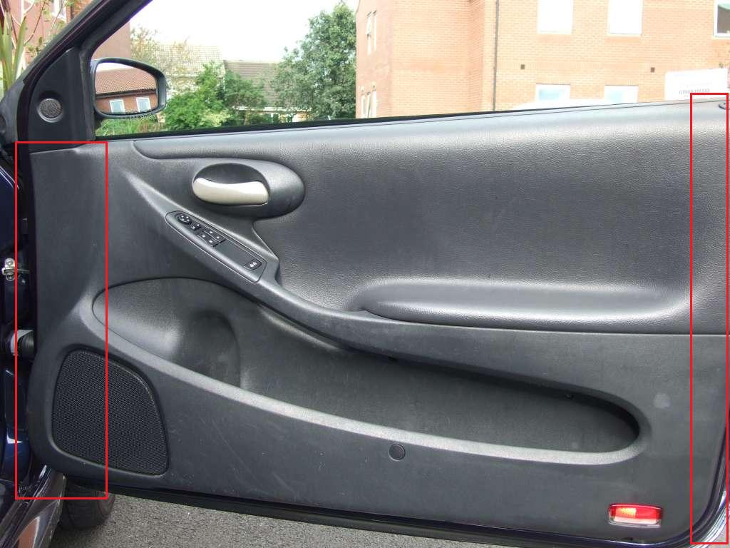

- Pull the door trim away from down, there are puch clips holding it down either side, the interior door trim will not come off at this point but just come away from the door
- Lift the trim panel up and away from door, be careful of alarm LED cable at top
