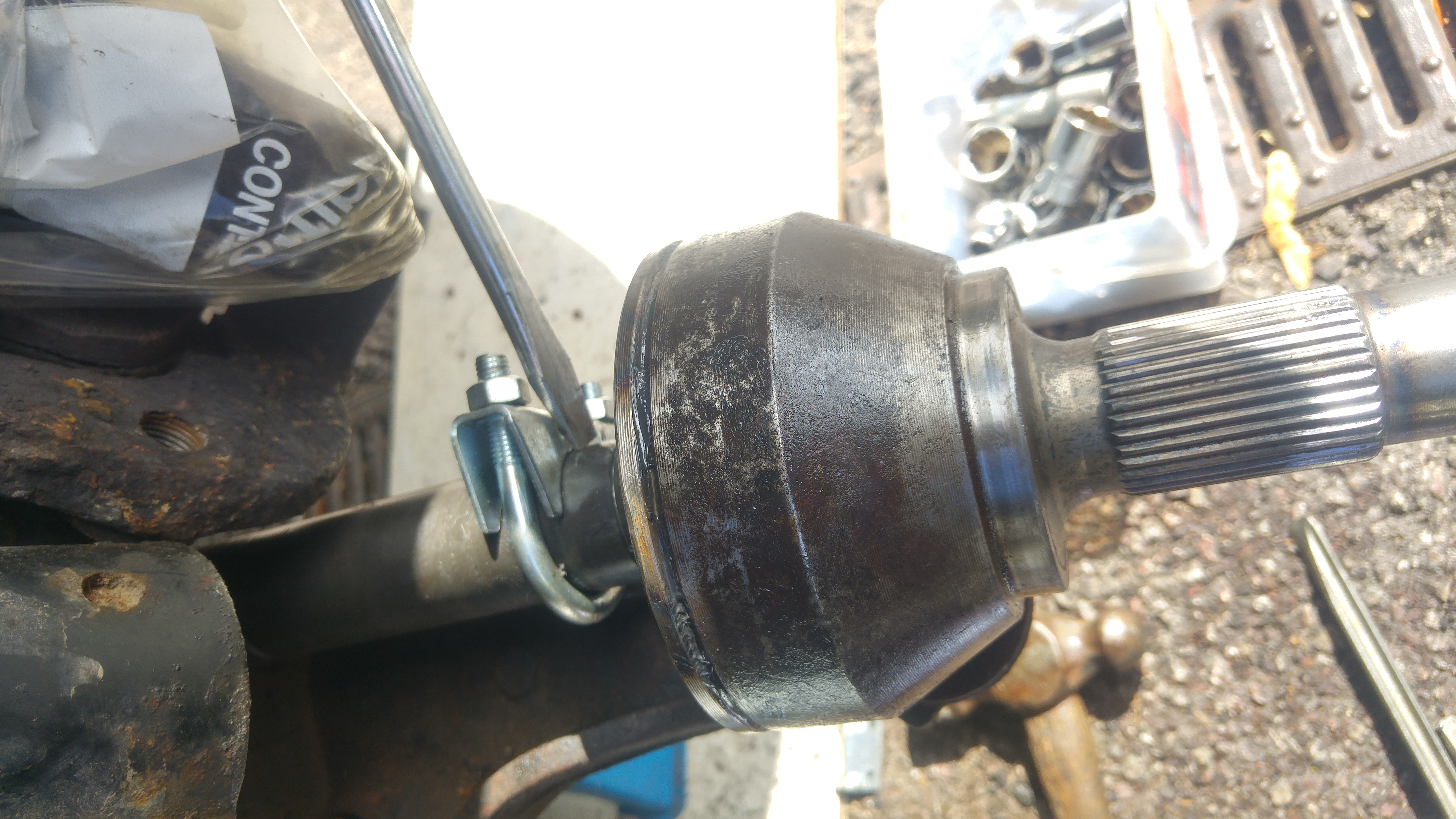

After stripping down get a 35mm exhaust clamp, fit this to the driveshaft a short distance from the CV joint and use two levers to pop the joint off. Saves risking hammer damage or accidentally pulling the inner joint out. Ducato CV joint.jpg 4.8 MB · Views: 371
