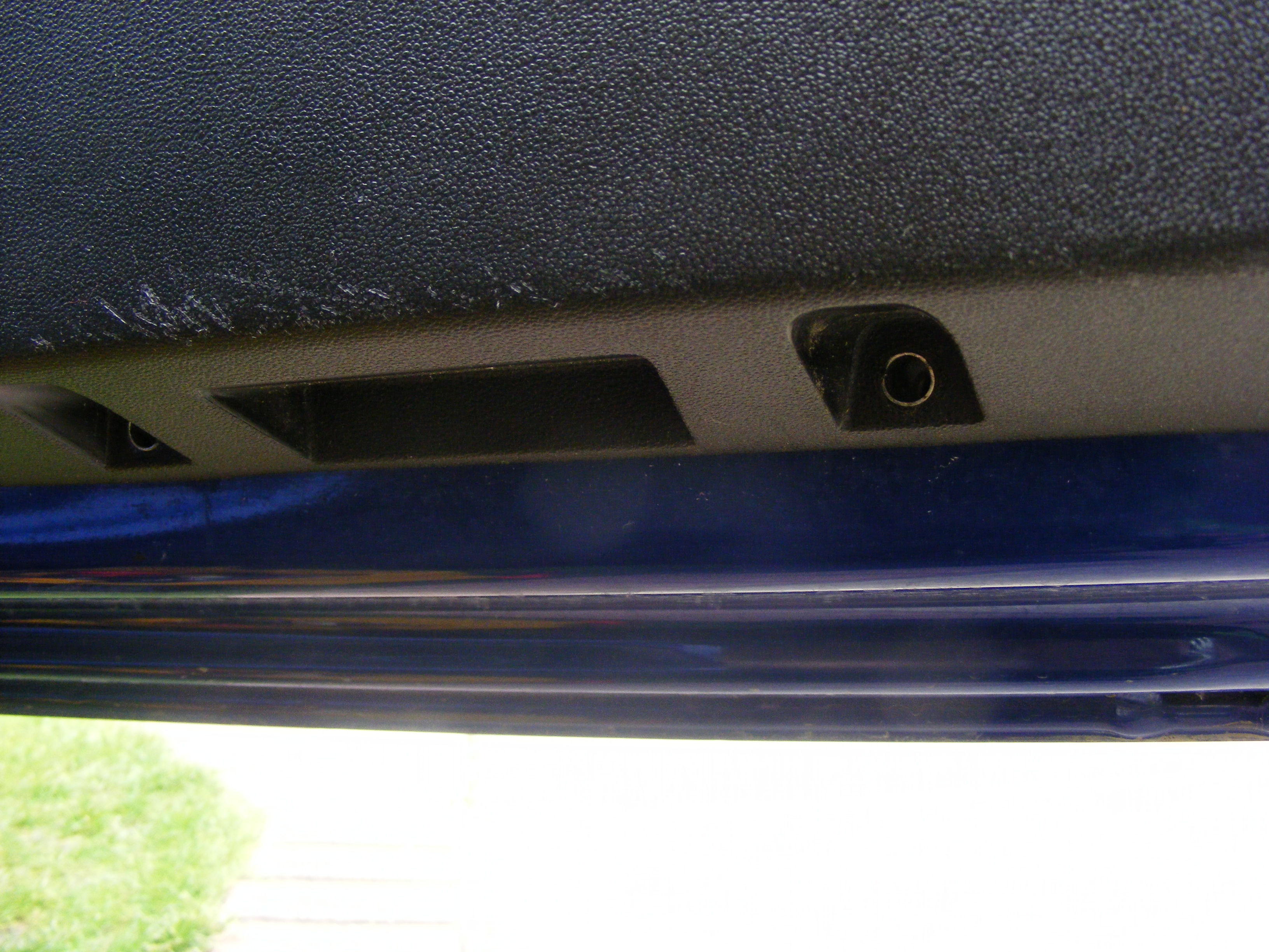

now remove the 4-5 pozzi screws at the bottom of the door card

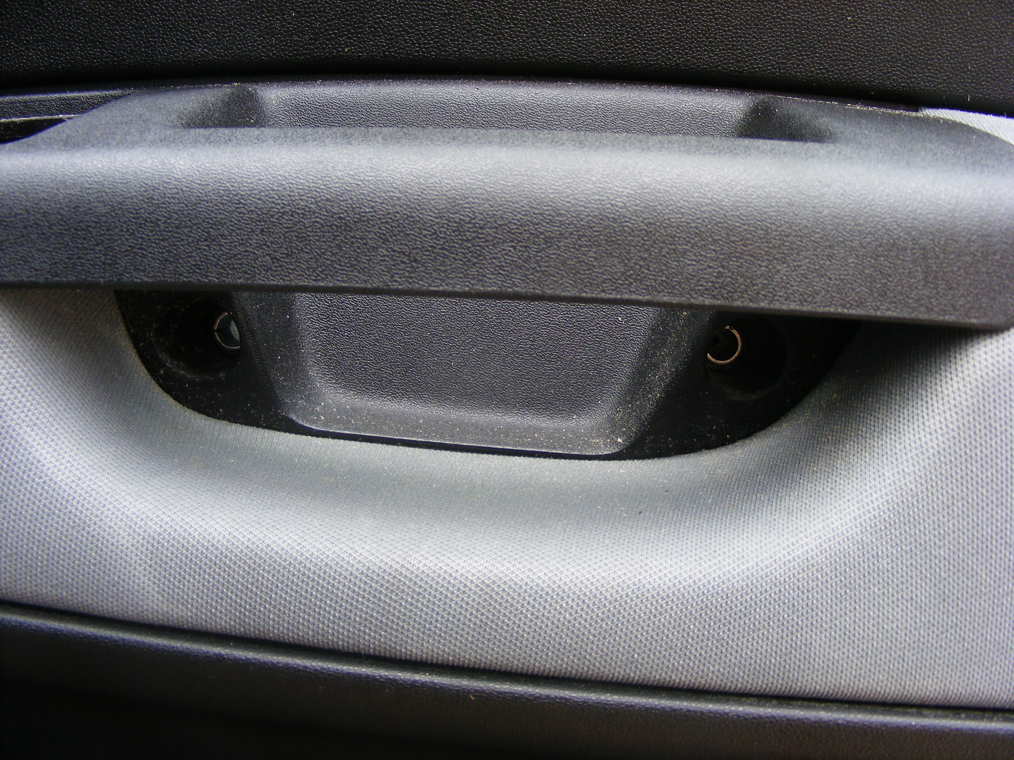

and the 3x socket cap Alan headed bolts (2 either side of the handle and one behind the door open pull catch ((under little cover that picks out))

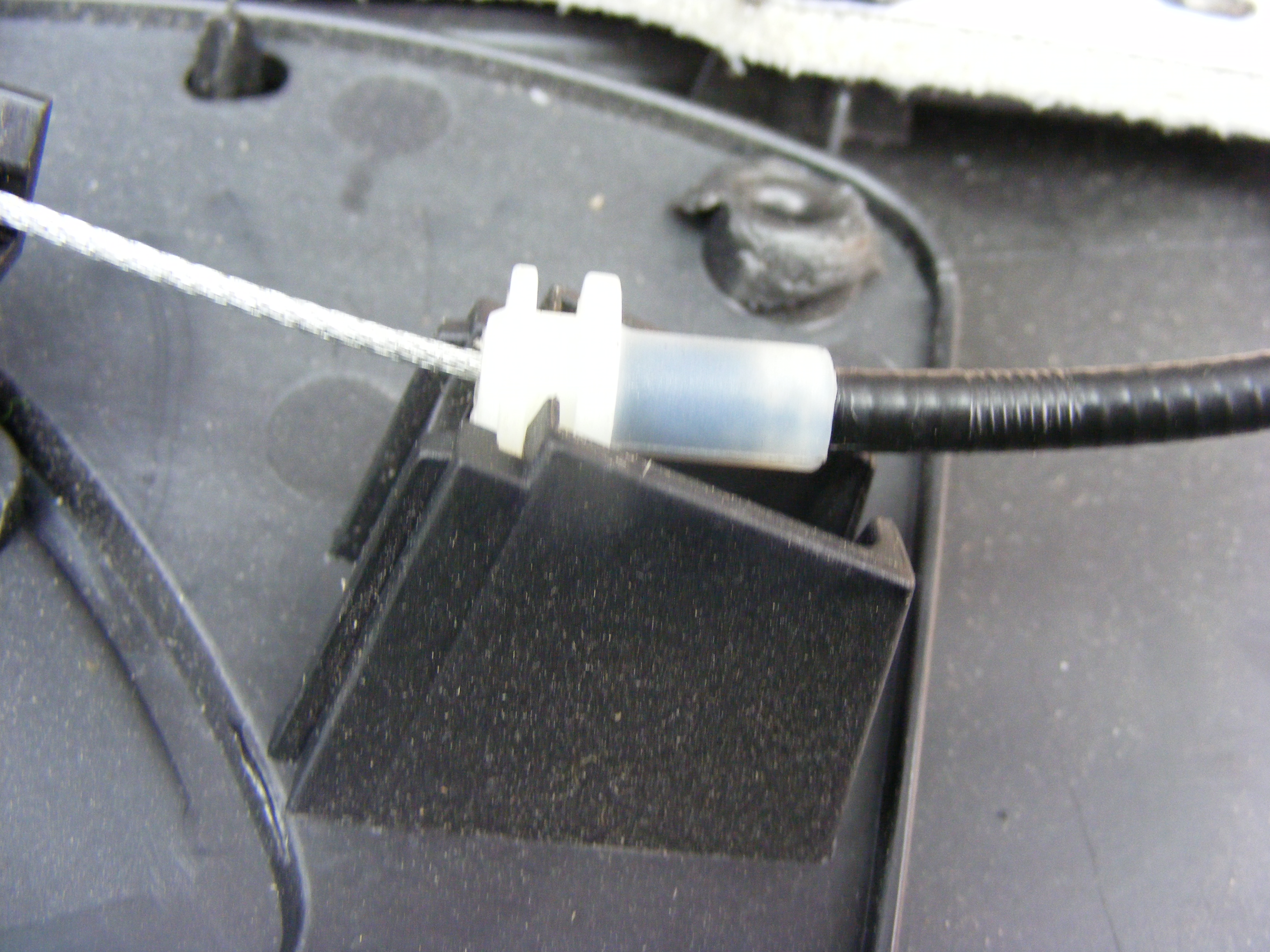

and the door catch cable nipple and remove
followed by the outer cable retainer.

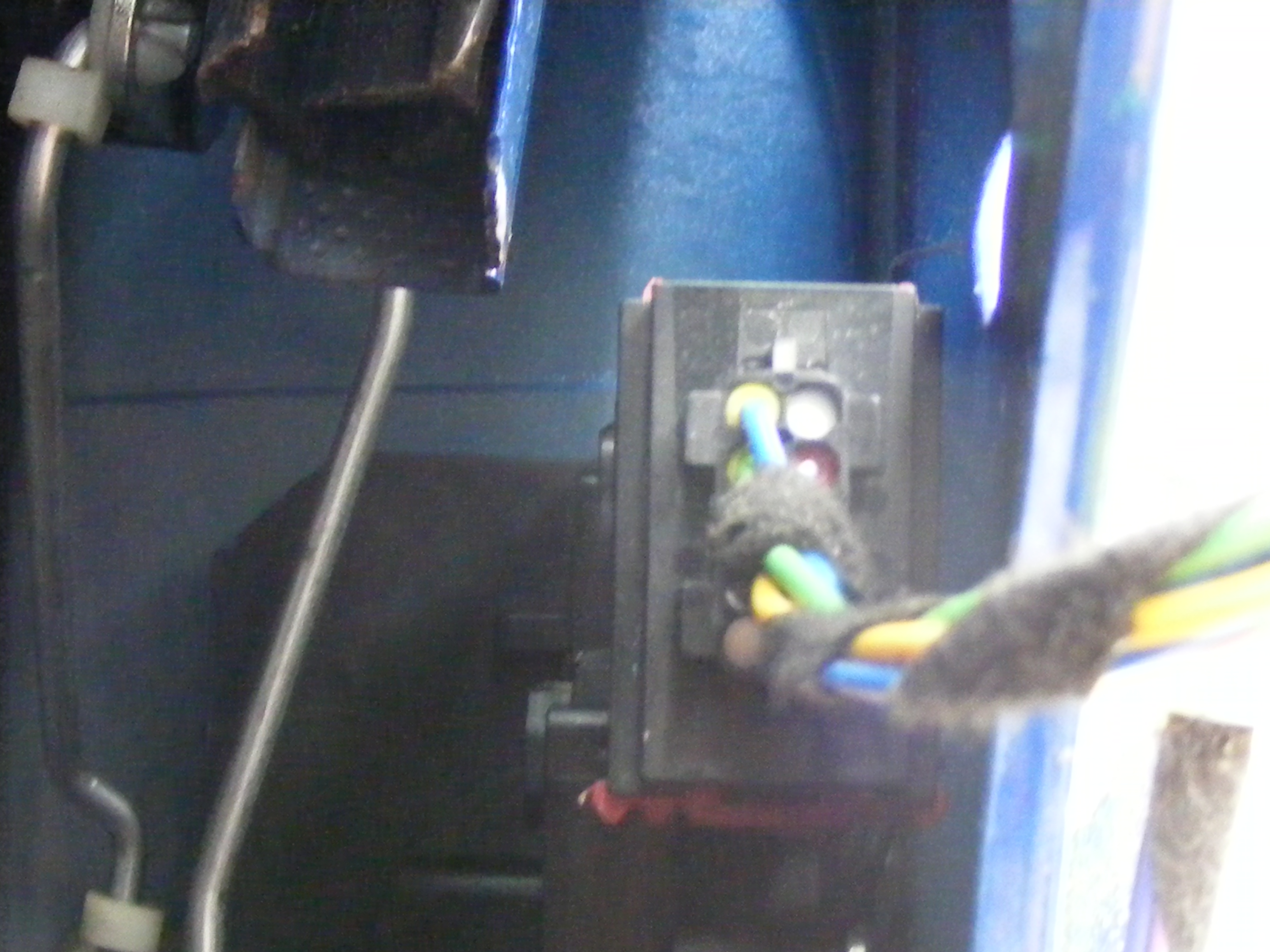

First un-clip the power cable multi plug pull the red tab down and this will release it

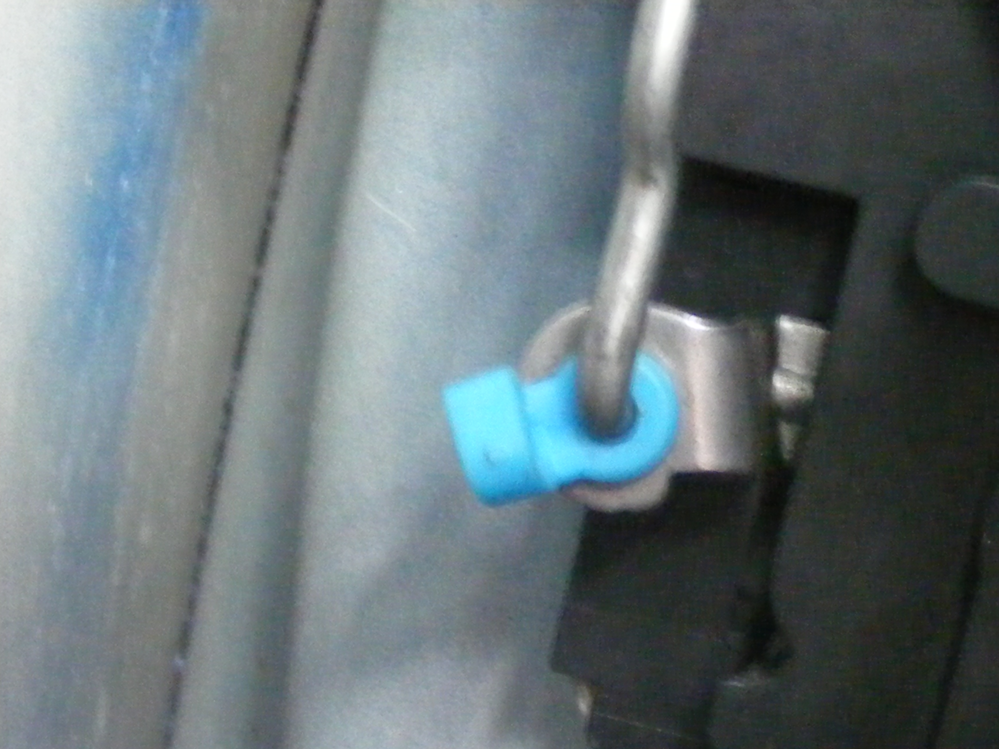

now unhook the 2 control rods swing the retaining clip open then unhook the control rod..
