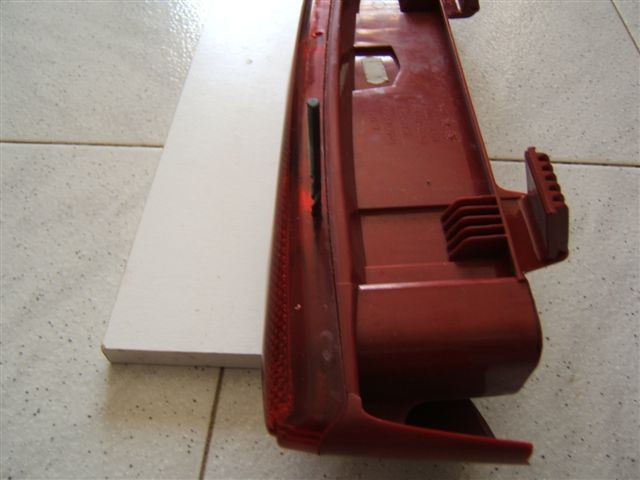

attachment.php
Looking at the picture you can see the position of the holes use something with a sharp point to make an indent to stop the drill bit from skidding. Carefully drill through into the first cavity tip out any water there may be so you do not get any near the electric drill.
For some reason my back left had two cavities and right only one so check the depth of the drill to see how far it has gone and if necessary drill into the second cavity, you should not reach into the reflector area. I was told to just drill two holes, but I drilled three, one for each light.
