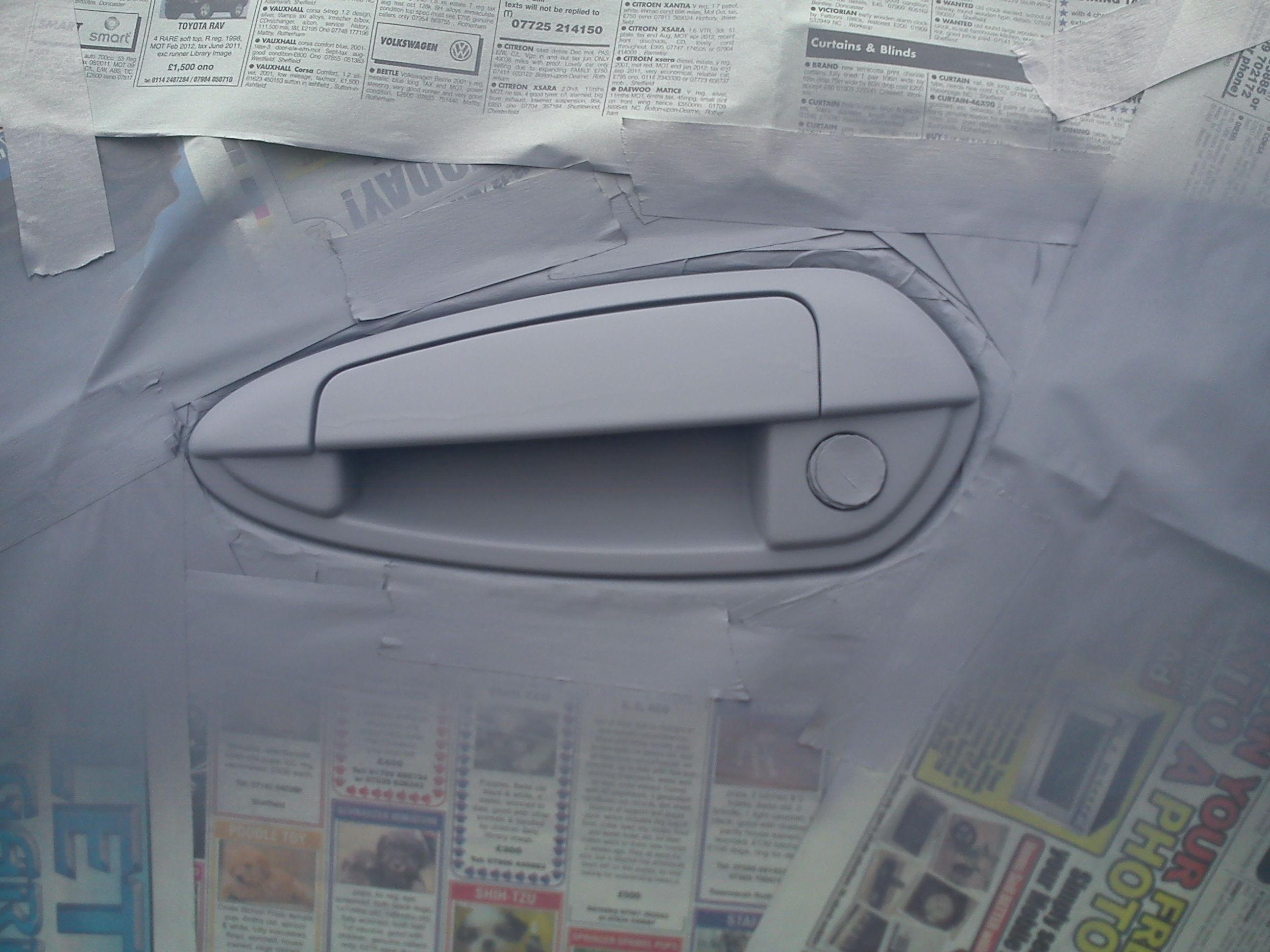

This, in my opinion, is the most important part. If you do not mask correctly, the whole job is ruined the second you spray your first drop.
Take time to get a perfect edge around the handle, using a credit card or equivalent to ensure your masking material 'tucks' in the edges.
To mask the keyhole, I used a 5p coin wrapped in masking tape.
Remember that the paint will drift in the wind so ensure you cover more than just around the handle.

Masking

Primer
After sanding, apply the coats of primer.
It is important that you do not attempt to 'thicken' parts of the primer which seem to still show the plastic underneath, the next coat will cover that.
Also, leave the correct drying time between coats.
Tip: if you angle the can right you can cover all sides of the handle:

Primer

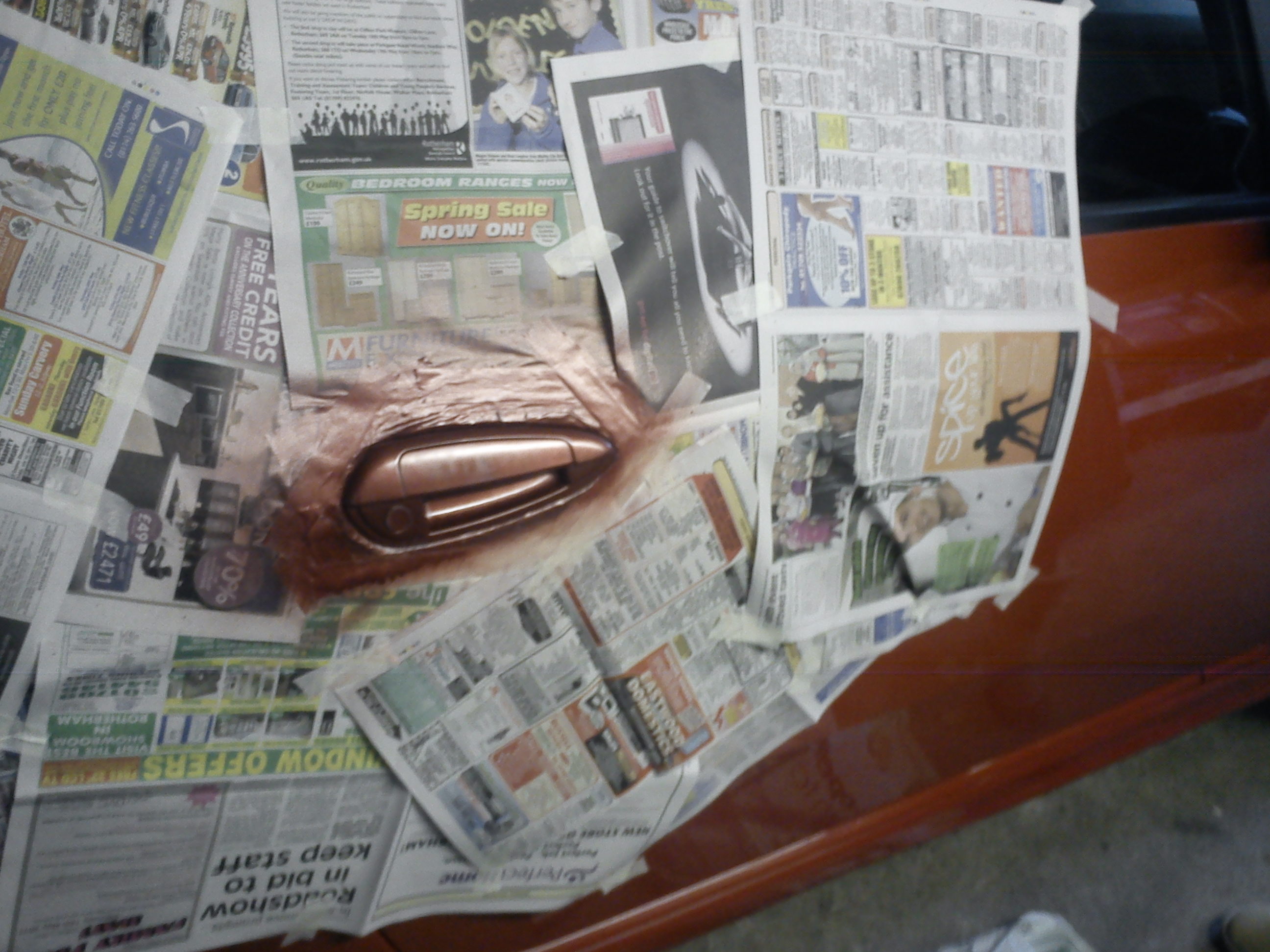

The part where you hold your breath. I strongly advise testing first or this could happen:
As with the primer, consistent smooth even strokes are best for ensuring the smoothest possible coat.
Once you have added a few coats, leaving sufficient drying time, laquer the handle to help prevent peeling and to help protect from the elements.
I used two coats of laquer.

Painting
