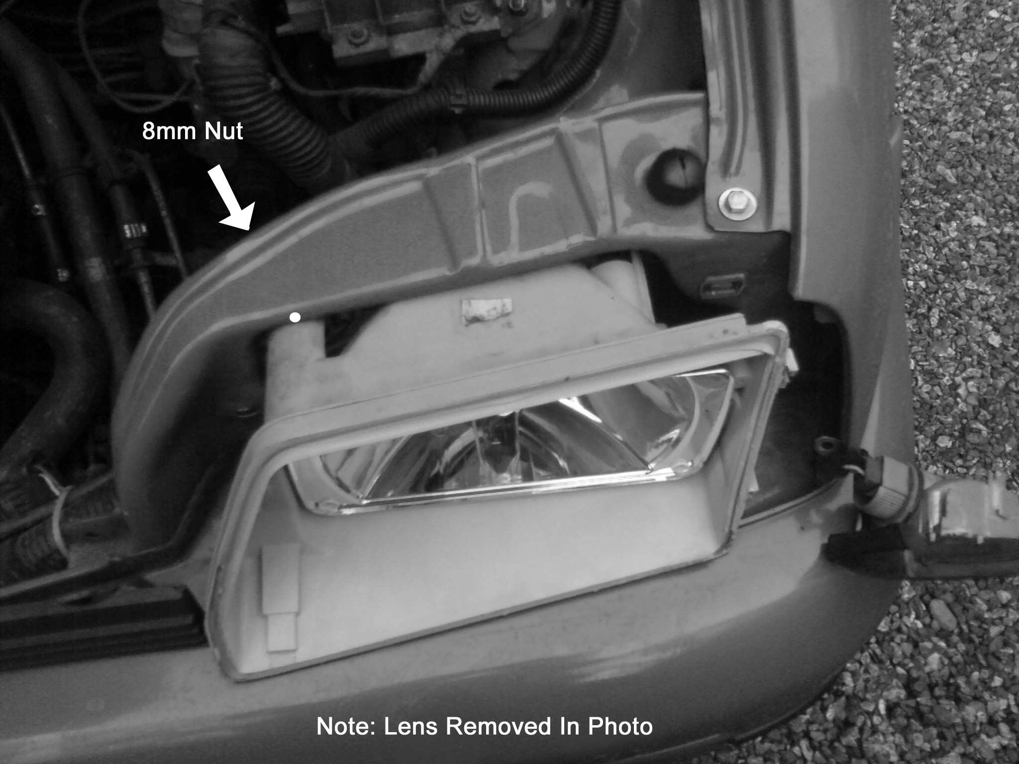

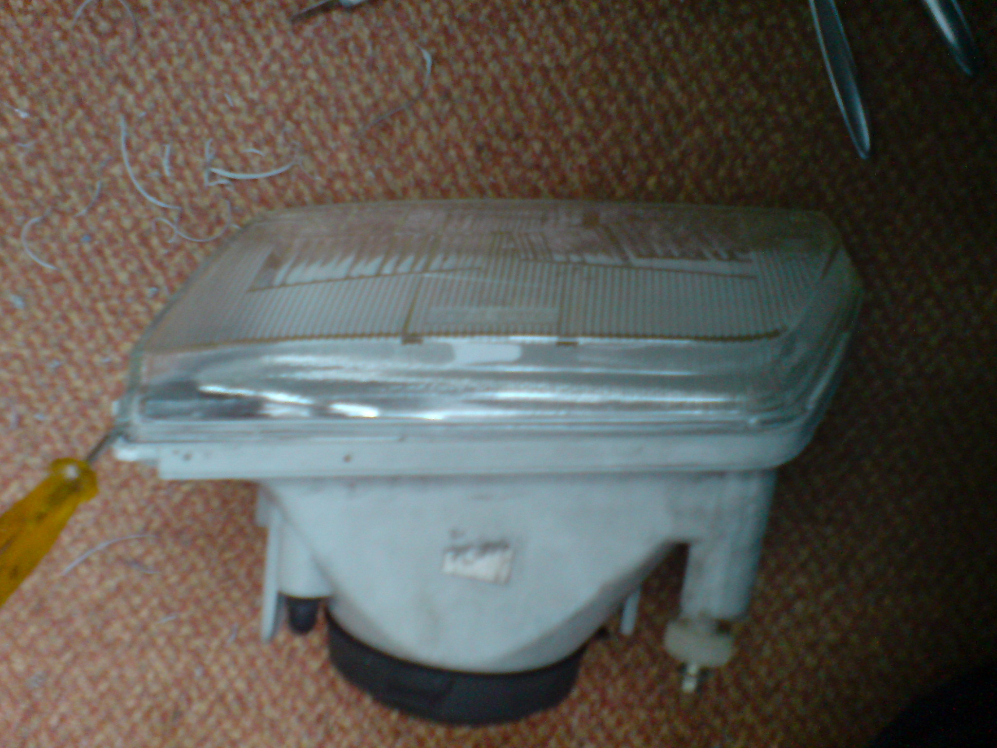

Firstly remove the headlight unit. There is one 8mm nut on the back of the front panel towards the inside end of the headlight (see Photo 1) and remove the connectors for the headlight and sidelight bulbs. The main unit un-clips from the body (see Photo 2) Then slide the indicator unit off the headlight (easy).
Photo 1
Photo 2
Photo 1
Photo 2
