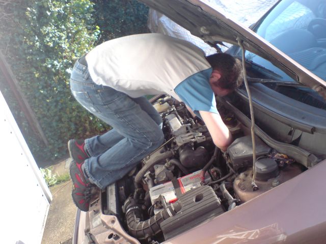

Ok now for the hard part. Get your hands in there and unscrew the filter. Remember to turn it clockwise to remove it. I got confused which way to turn it and managed to tighten it about 16th turn.. Which made things just that bit harder to remove. You may want to put some rags or kitchen roll down the back of the engine to catch any spilt diesel.

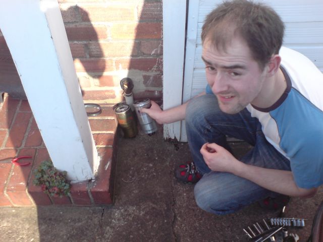

Once it's removed. Feed the filter along under the fuel feed/return pipes and out next to the brake reservoir.
You should now have the filter out to compare with the one you have bought. Make sure all the rubber seals (2) are there on both. If the one you removed is missing one check inside the filter housing.
