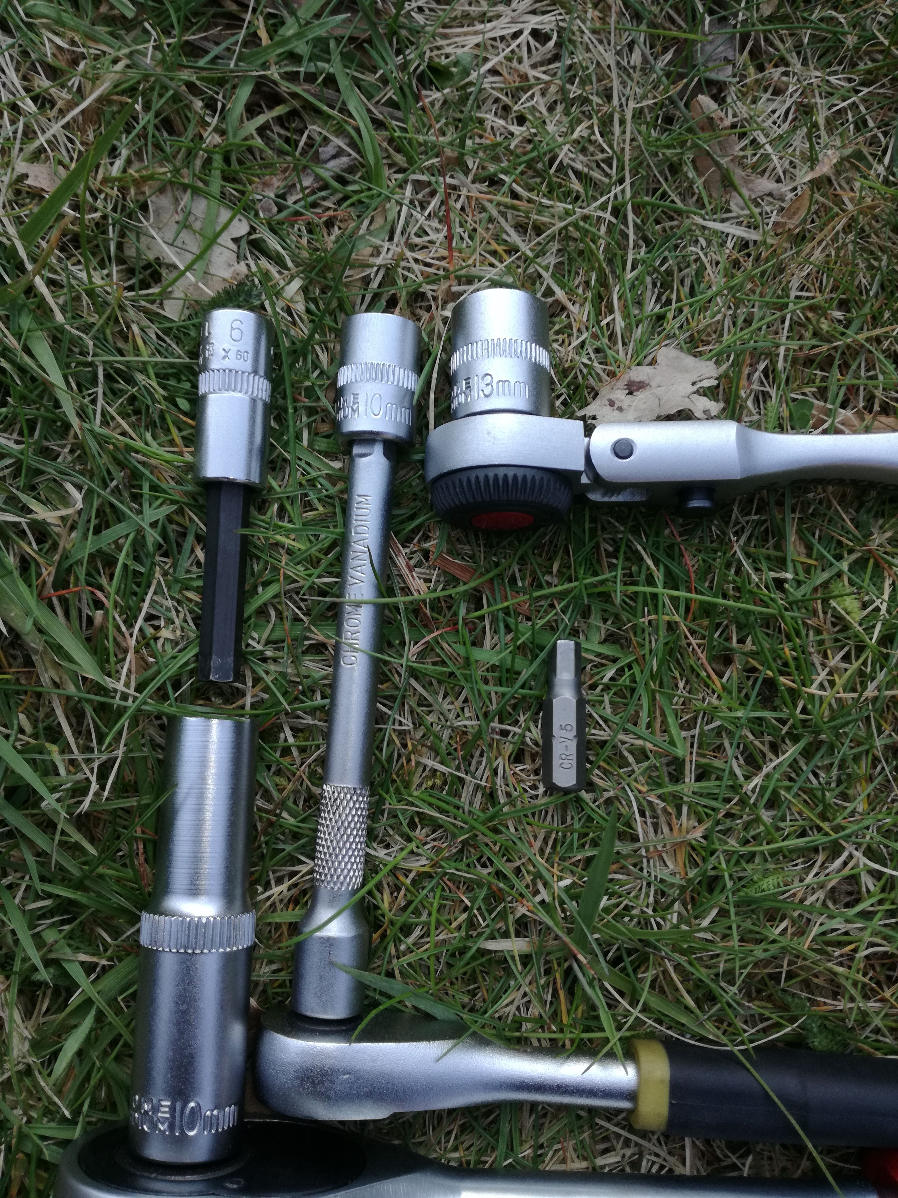

What we need
To get this job done we need this tools :
I pasted the video but i will upload some images how the workflow is as well.

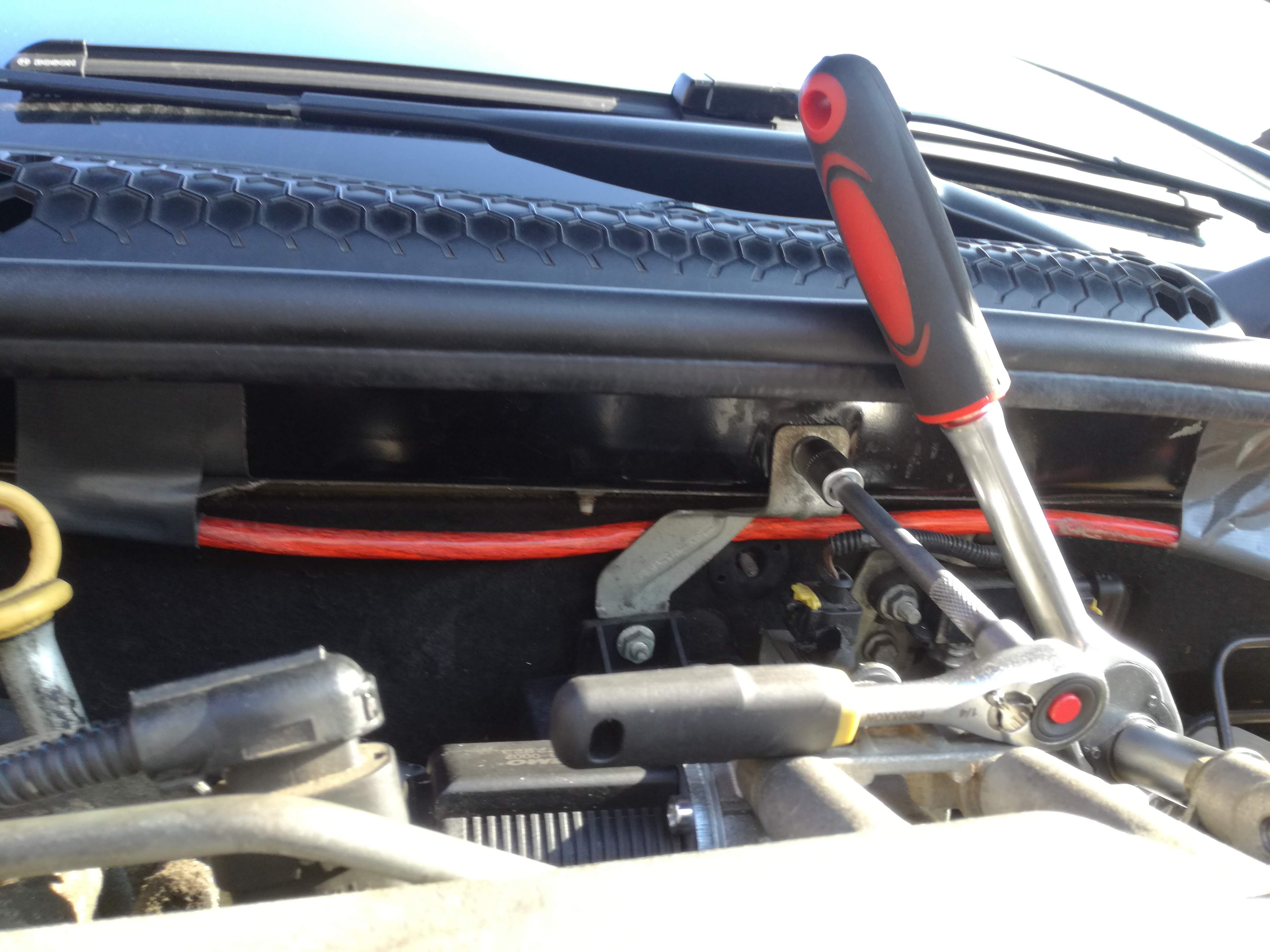

1. Remove the black bracket to get some space to work

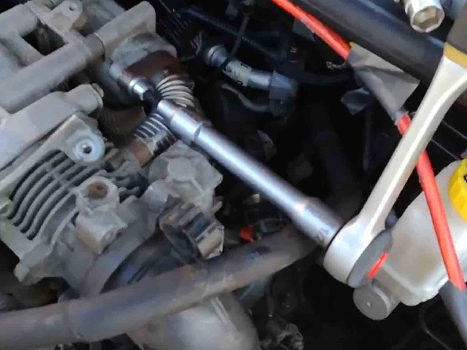

2. Remove the 2 upper backside screws

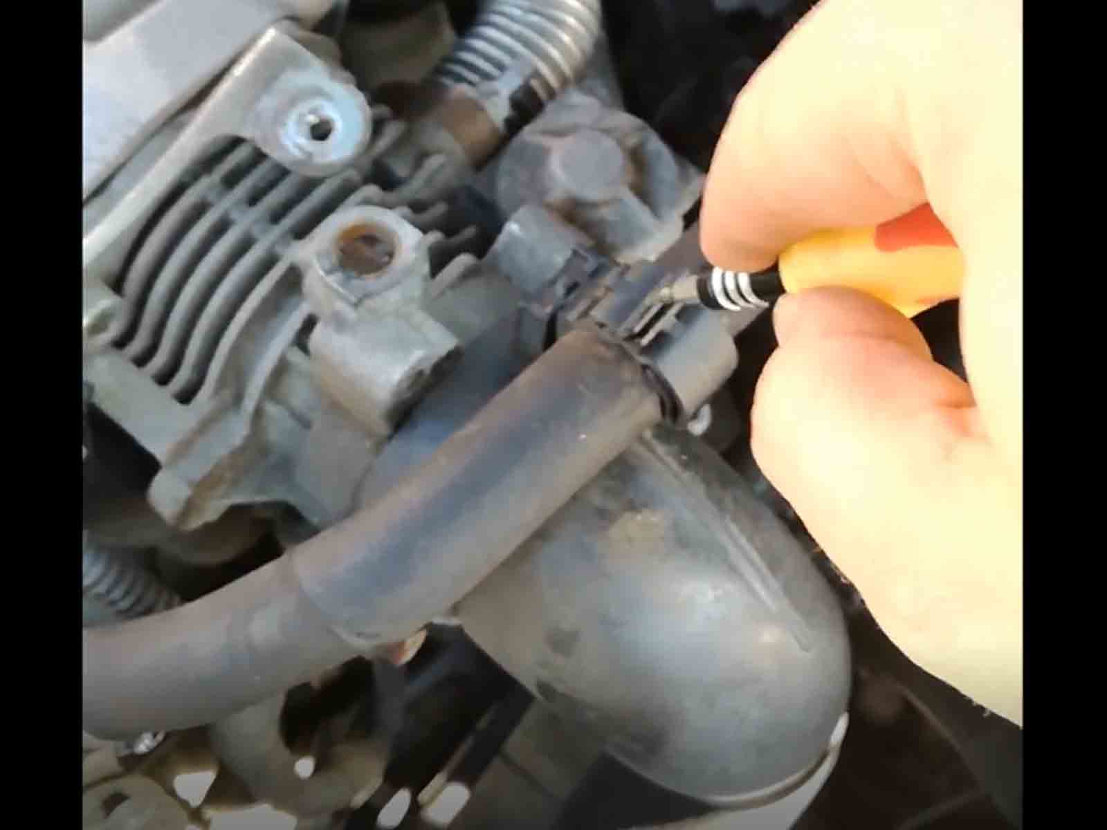

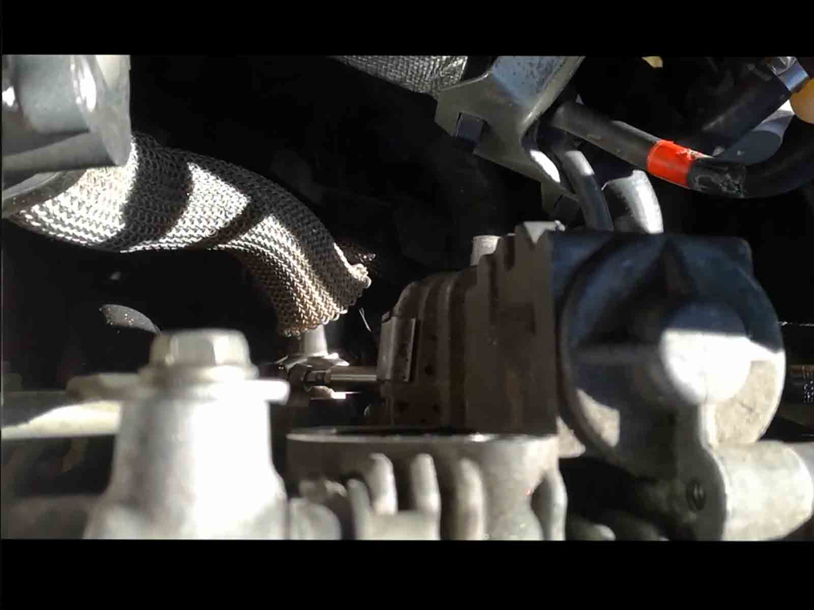

3. Loose the pipe holder with a small screw driver and make space, so you can unscrew the side screws of the agr valve

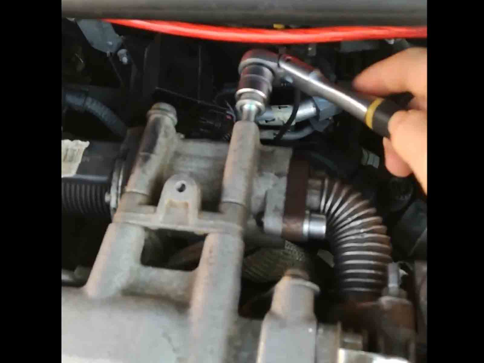

4. Remove the side screws

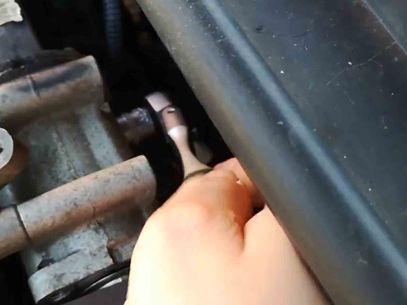

5. Remove the backside bottom screw

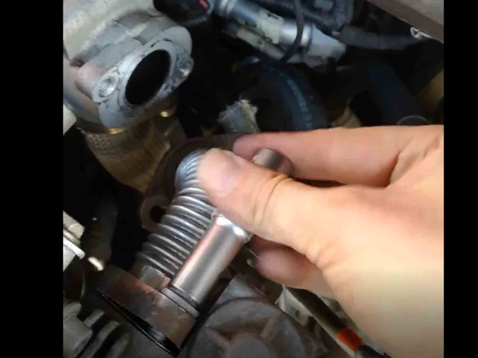

6. Remove the 2 screws holding the pipe between the agr and throttle

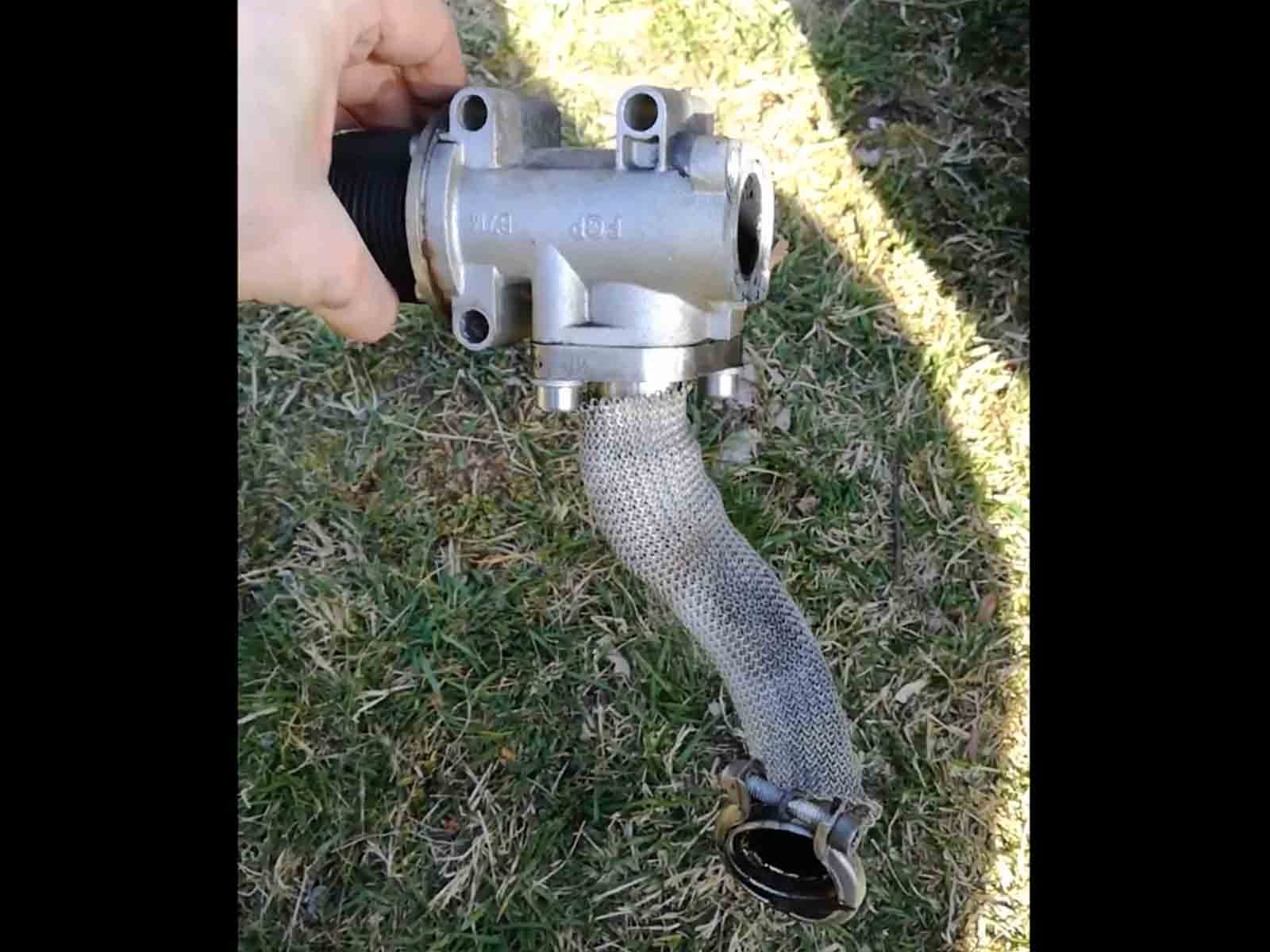

7. Unscrew the bottom pipe comming from the agr. The easiest way is to unscrew it on the other end of the pipe, where it is connecting to the heat exchanger. There is only 1 screw, its easy to acces.
After you removed it, it should look like this
Now just change the agr on the pipe and reverse the workflow. I hope i have helped you all.

What we need
