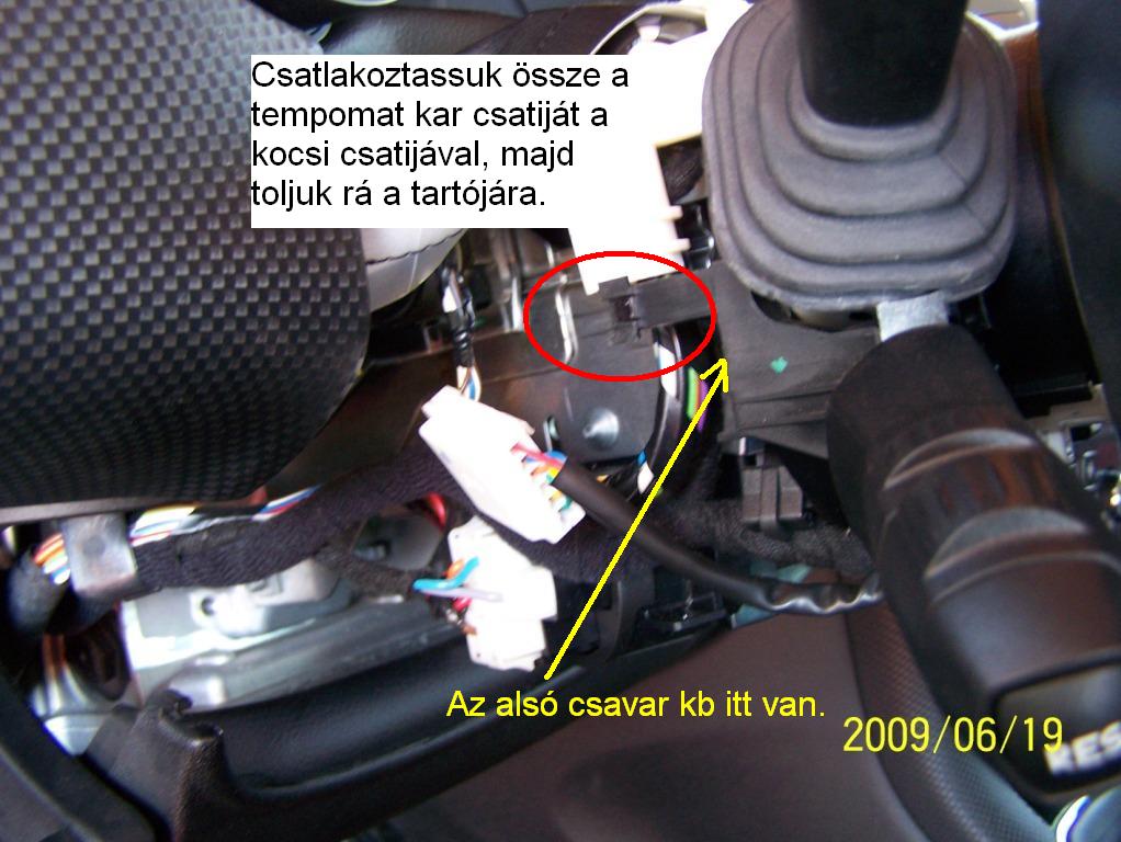

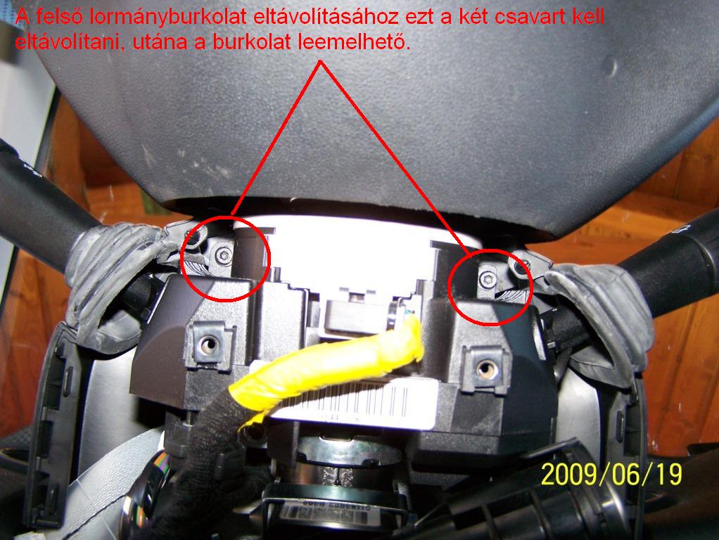

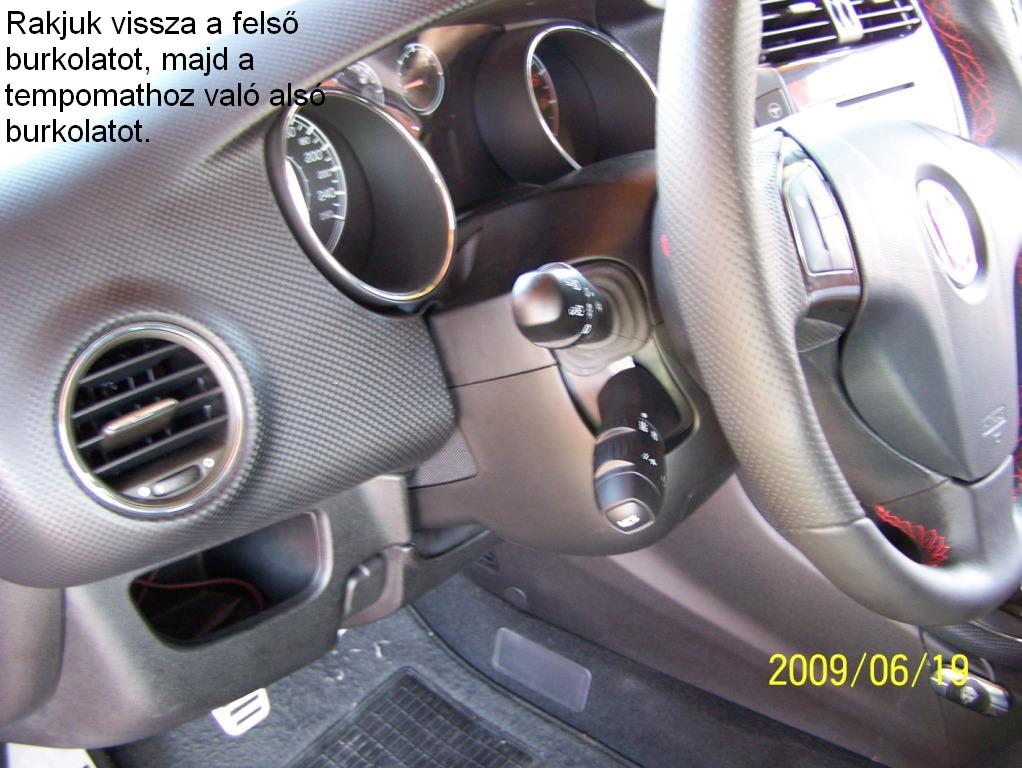

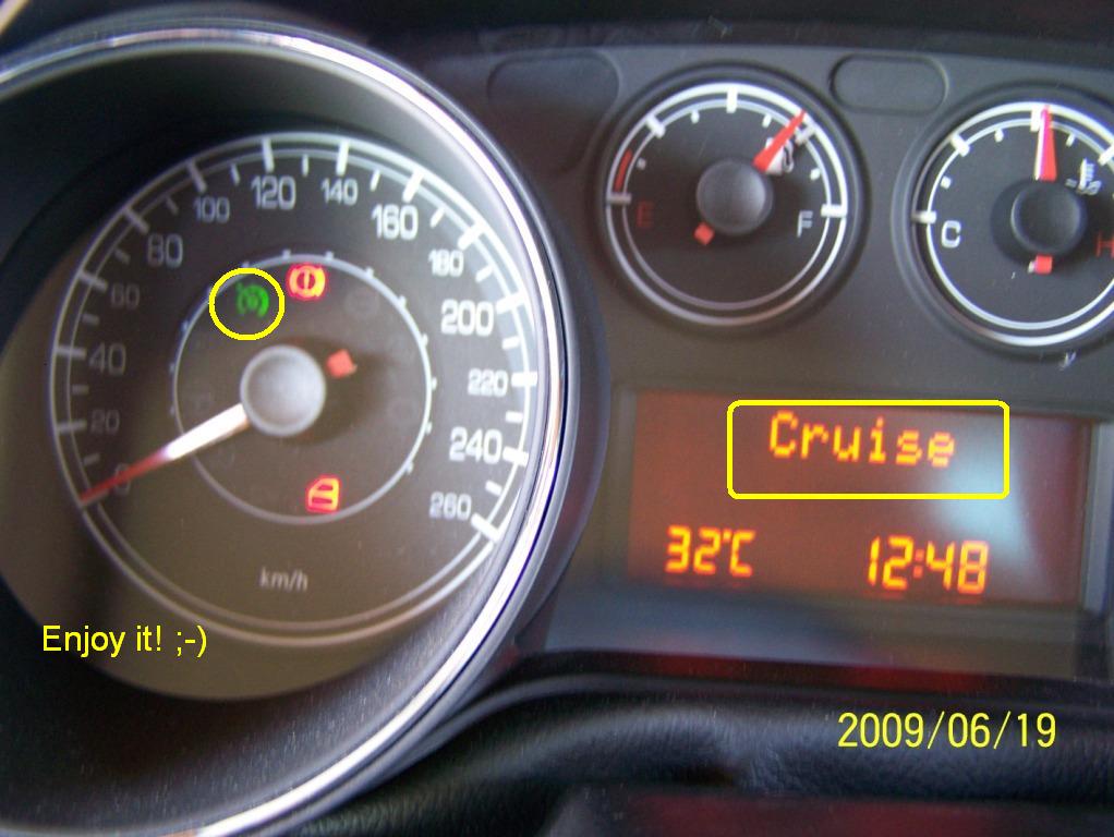

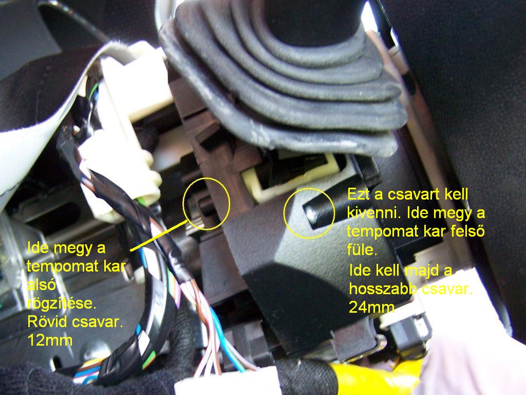

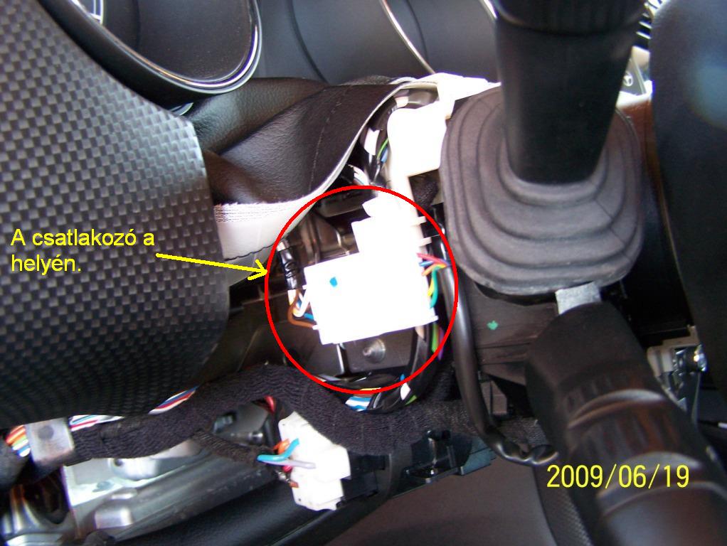

I'll translate later.
I hope pictures help.
I'll upload about wiring installation, also.
