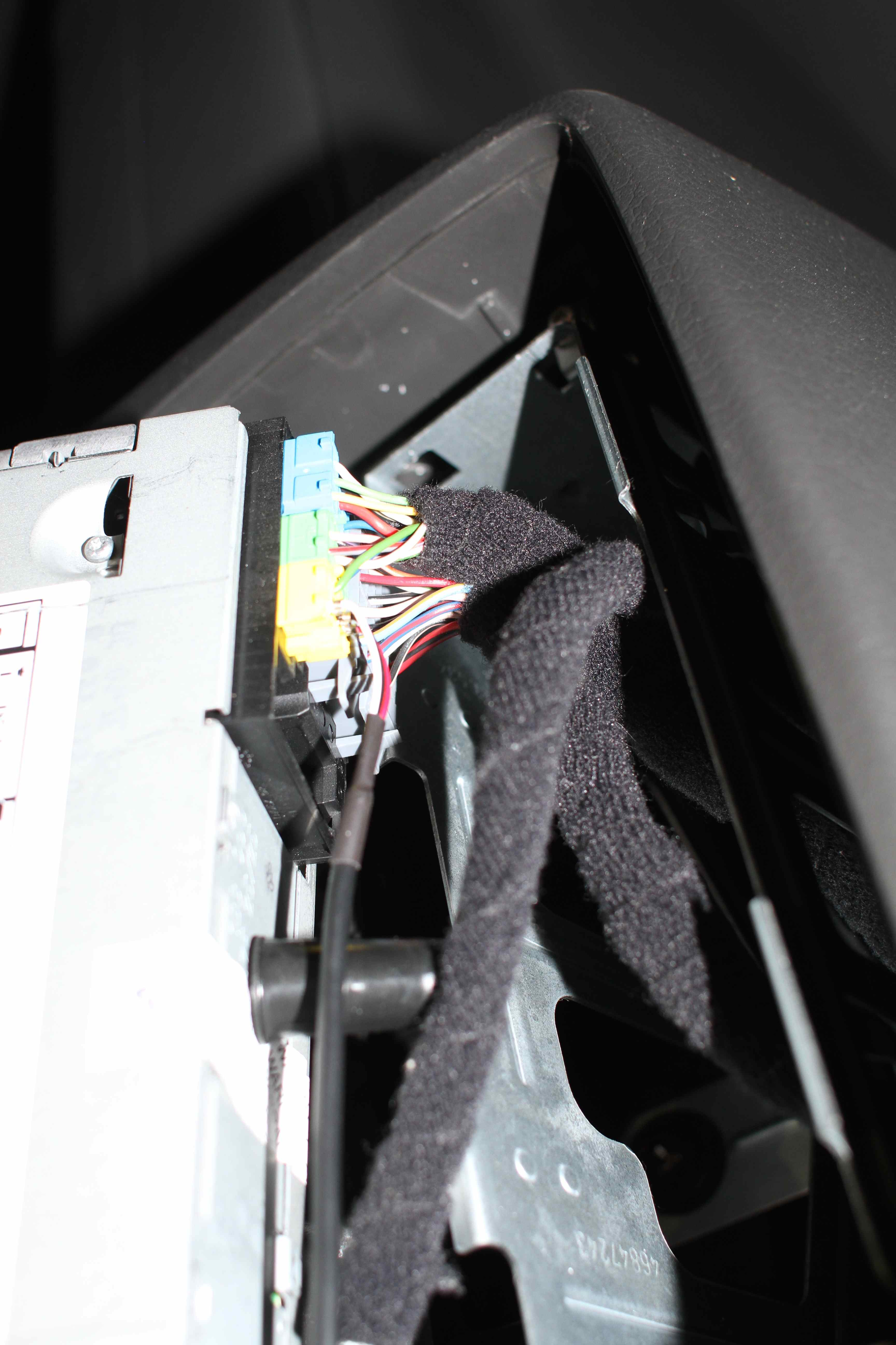

Wiring,
Make sure the head unit is not dangling by the wiring loom. Gently pull out the blue green yellow connector. There is some resistance but it will come with a little wiggling.
Having a blue plug instead of the yellow one, I needed to remove the connectors from the casing. I used a very sharp knife, take care when doing this as the plastic suddenly gives way and it would be easy to cut yourself. I started by whittling down the corners revealing the first two connectors. After removing them the middle one was easy to attack.
I then connected the three clips to the spades to check orientation of the wires (as when you push them into the block thats permanent). I reconnected the battery and played some music. Using the accessibility menu I adjusted the left right balance to check that I had the left and right wires on the right spades. (From memory it was white on the top black earth in the middle and red on the bottom).
