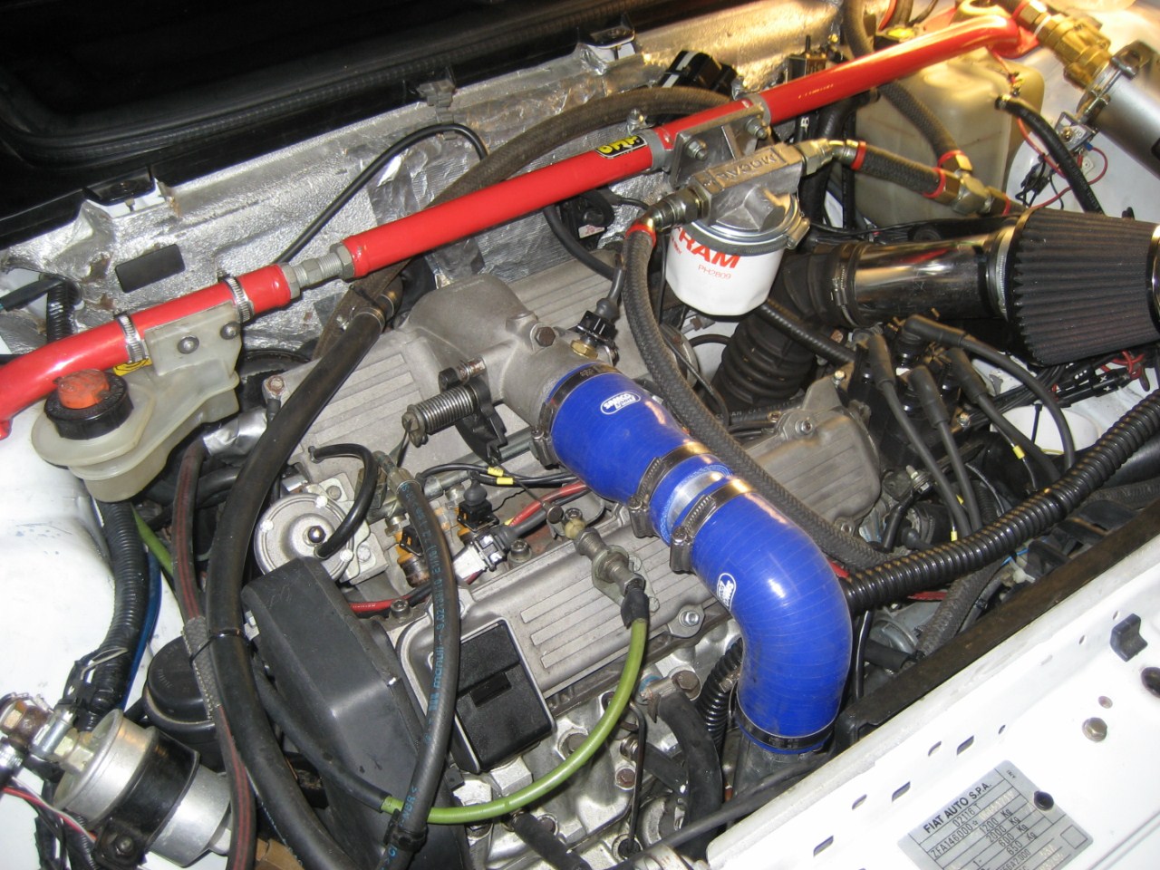

Guy croft built engine
Re-bored to 1423cc with wire ring conversion
Forged pistons
Cylinder head work
Triple race valve springs
Lightened flywheel
Modified oil ways
Baffled sump and Accusump too
Race spark plugs
Hybrid T25 turbo from Turbo Technics with -10 impeller and .48 turbine housing
"Pectel" 3rd party fuelling ECU
Group N straight though rally exhaust
Large intercooler
Two oil coolers

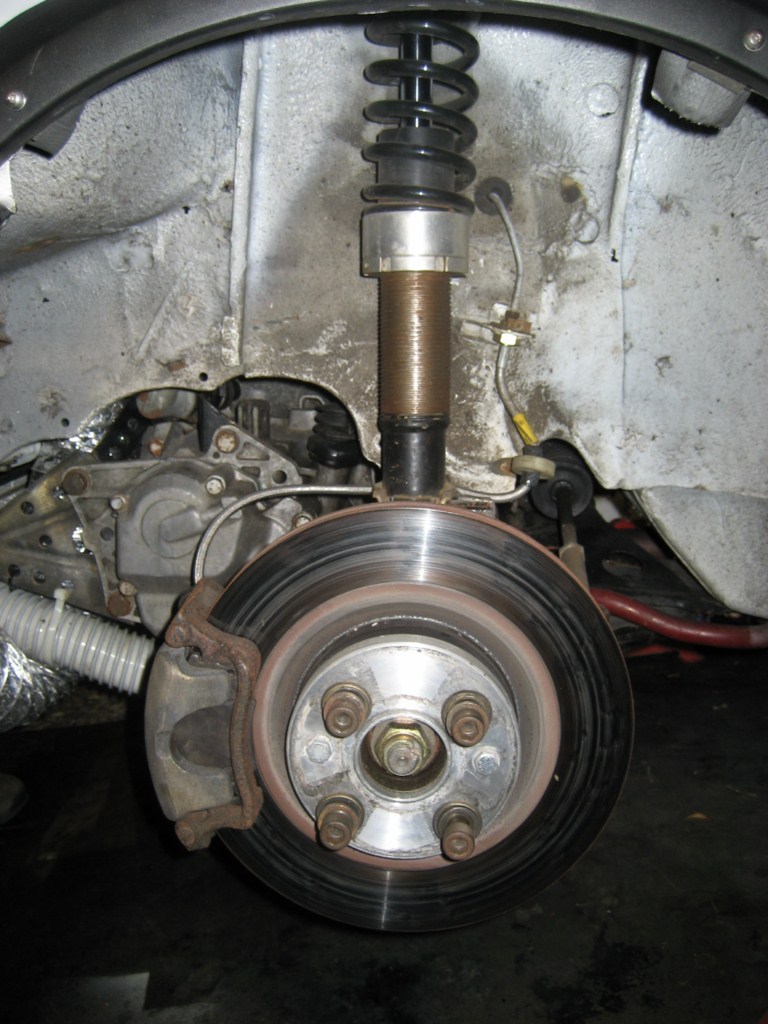

Coilover suspension all round.
Front and rear anti-roll bar
