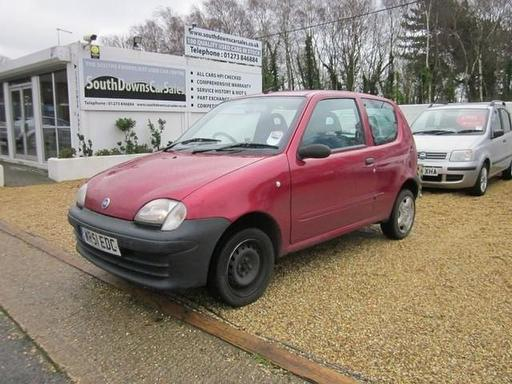

Here it is as it sits outside my work tonight. It's a little bit tatty I must admit but it'd be a shame to buy a mint one to throw at hedgerows and cones when out competing...
