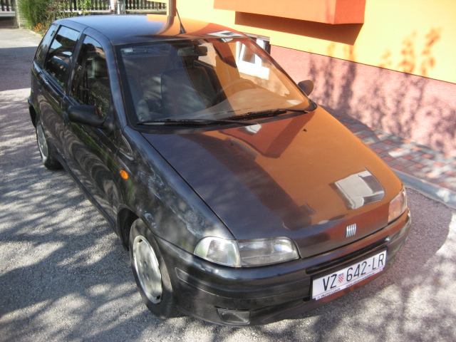

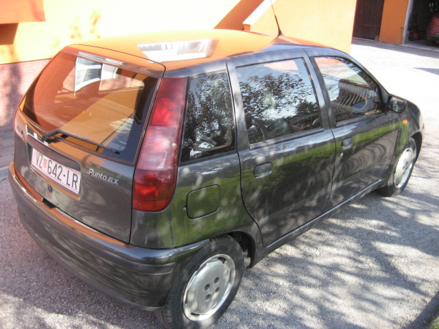

Punto (Mk1) Punto 75ELX 1996.
I needed some small and cheap car, first option was Seicento, but they are rather expensive, mostly without any extras.
So i looked for Punto mk1, checked about 10-15 cars, all had corroded underbody.
Found one but high mileage/km, 197 000km. But runs smooth and quiet.

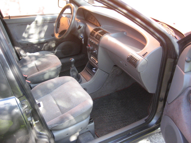

Pretty undamaged inside, no rust on floors, power windows, original IR remote lock that works, and A/C, but no power steering-but it has 165/65R14 tyres so its not big deal.

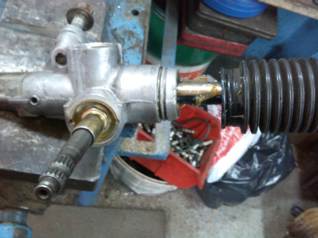

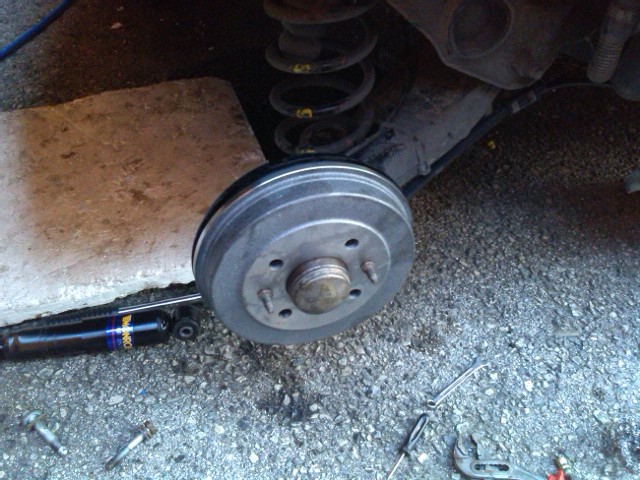

First of all i changed: front discs, pads and break lines, front wishbones, refurbished steering rack, rear shocks, rear break drums, break cilinders and pads, handbreak cables, gearbox and engine oil, thermostat, engine coolant, valve cover and coil holder gasket, belts, tensioner and pulleys, spark plugs

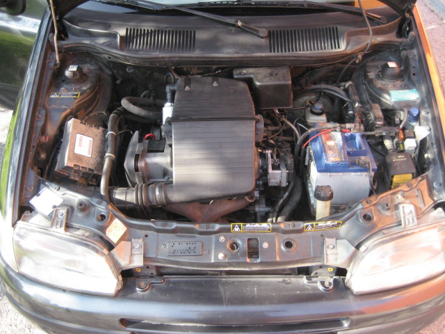

Added LPG filter between valve cover breather and air filter box to avoid oil on intake
