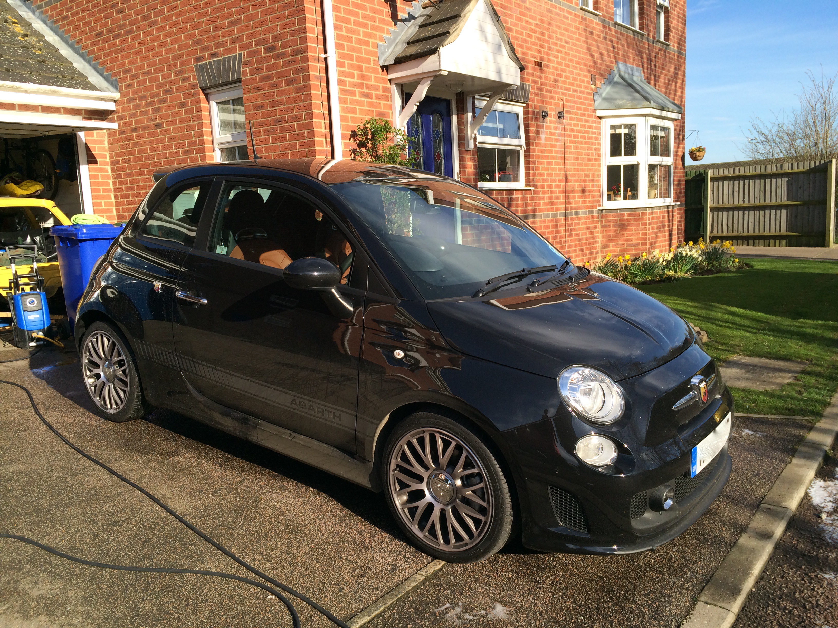

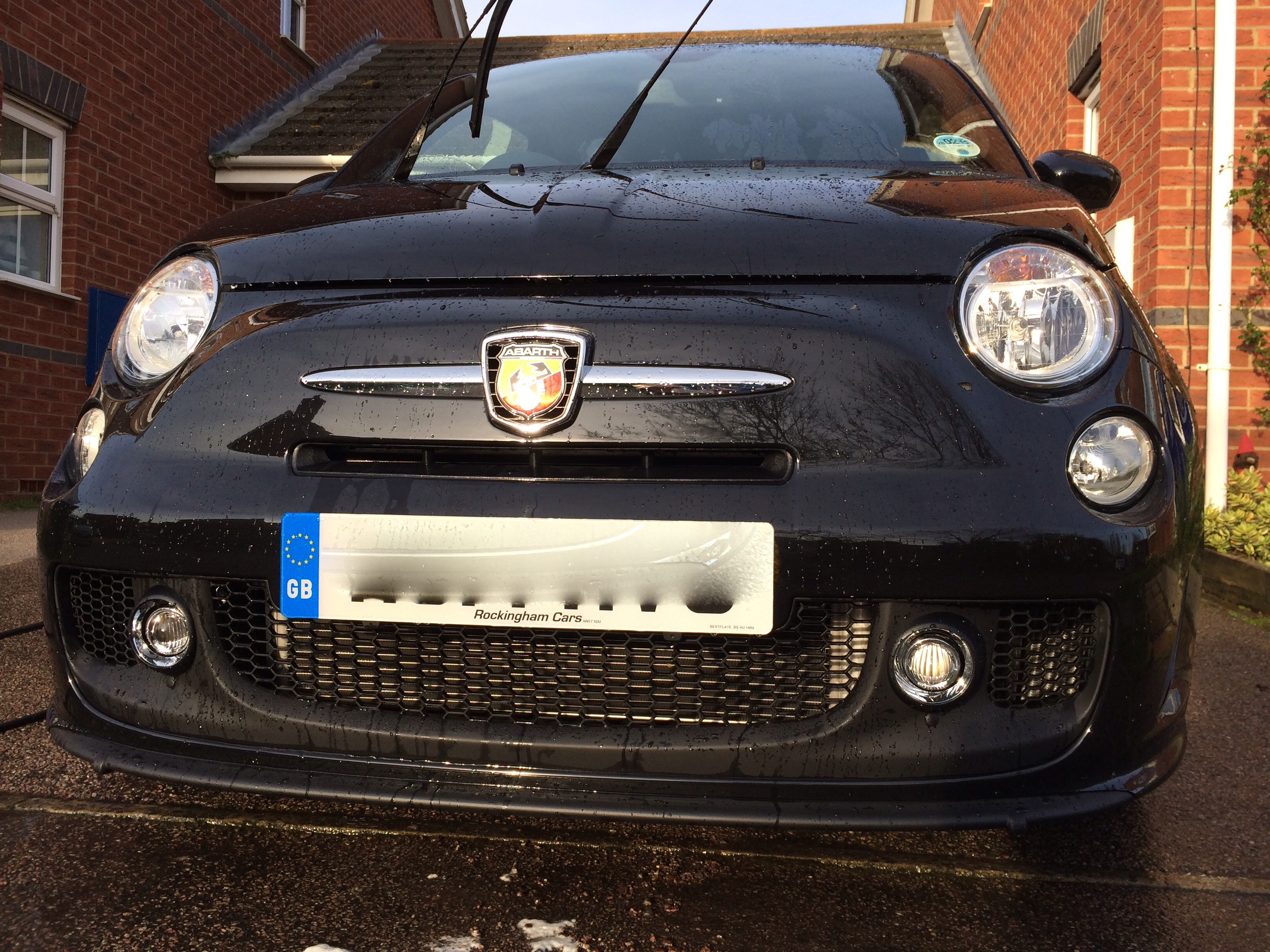

The car was a week old but as the weather wasn't good last week it was quite dirty after 250 miles.
So here are some before pictures:

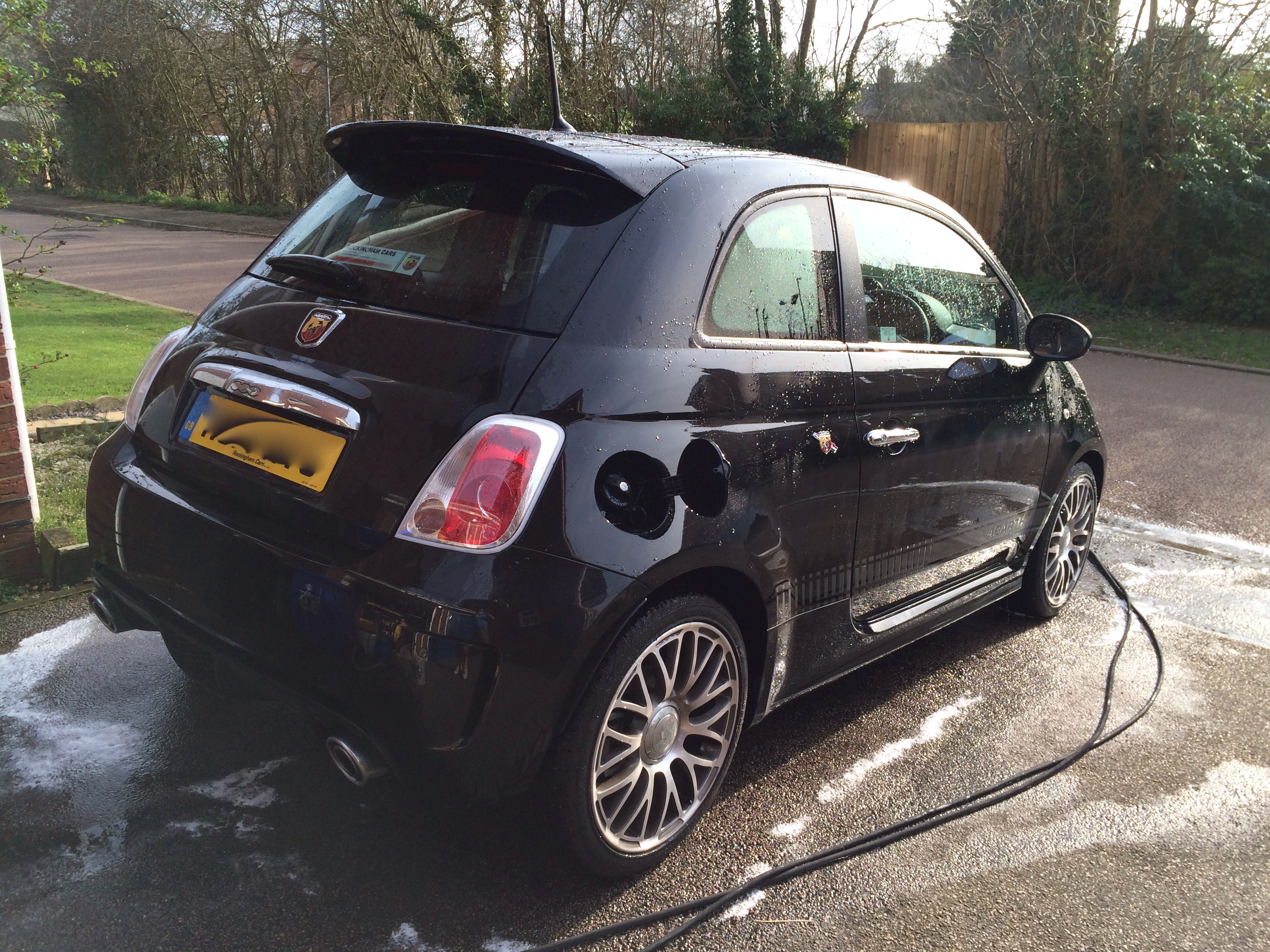

I then soaked the car in Autobrite Direct's Magifoam:
Left to dwell for 15 minutes and rinsed:
I then see to work using the two bucket method and Farecla's G3 Bodywork Prep shampoo. I also cleaned the wheels with Autobrite's Purple Rain 2.0 and rinsed again:

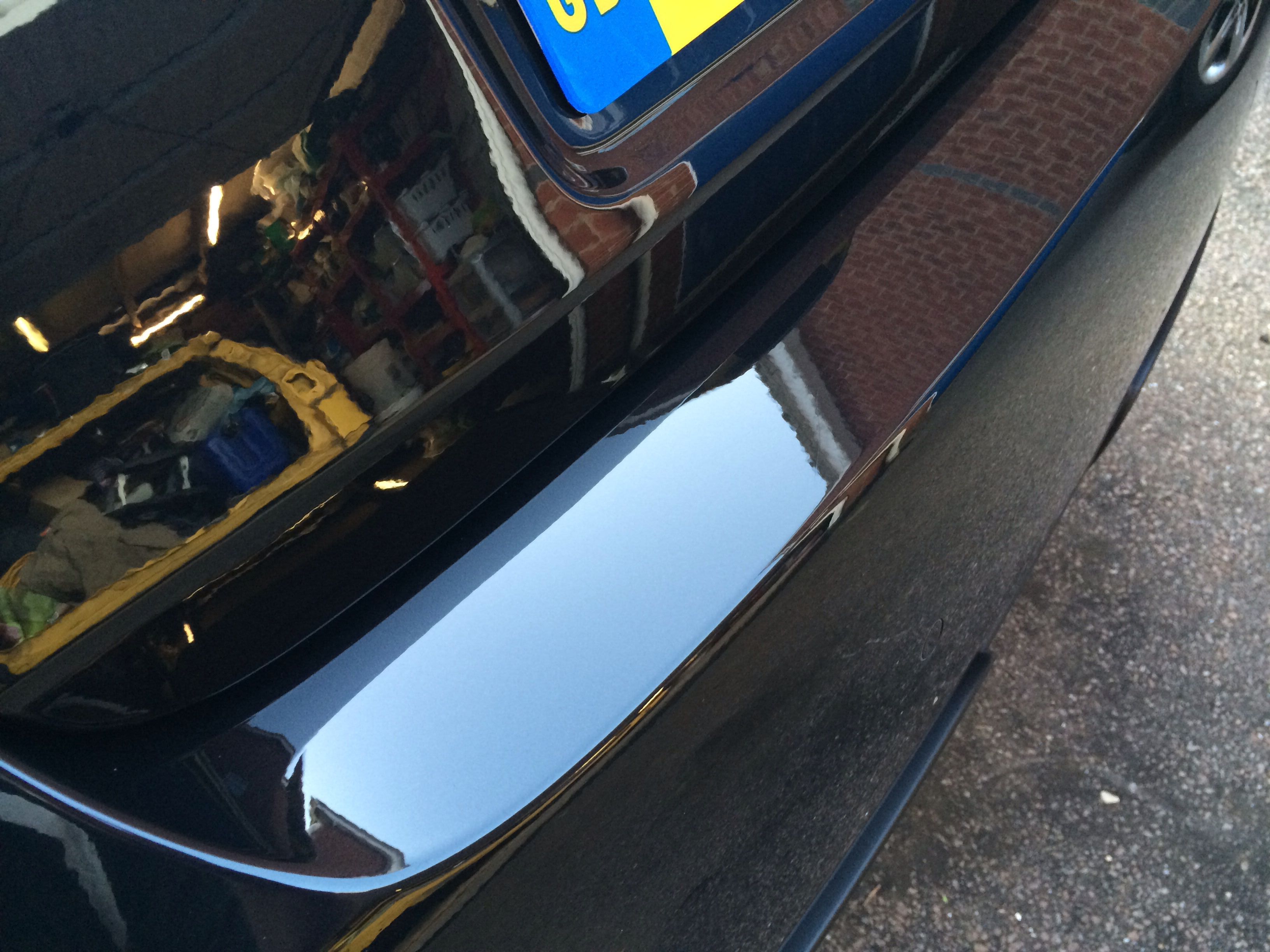

Once I had me chines the entire car I then wiped the car down with panel wipe ensuring each panel was uber clean and then applied C1 as per the instructions. I was a little worried at first as I'd never applied something like this before but I actually found it quite easy. The biggest issue I had was dust (being outside) and the sun. I had to keep moving the car round to keep the panels I was working on in the shade and panel wiping to remove the dust.
The car was looking great after the C1 but I waited 3-4 hours for it to cure before applying EXO. I found the EXO a little harder to apply. It seemed to cure within a minute or two of application. I found myself with the applicator cloth in one hand and a MF cloth in the other so as soon as I have applied the EXO I could spread it over the panel evenly then remove with another MF. I also started applying to smaller and smaller sections as to not let it dry on the panel before removing.

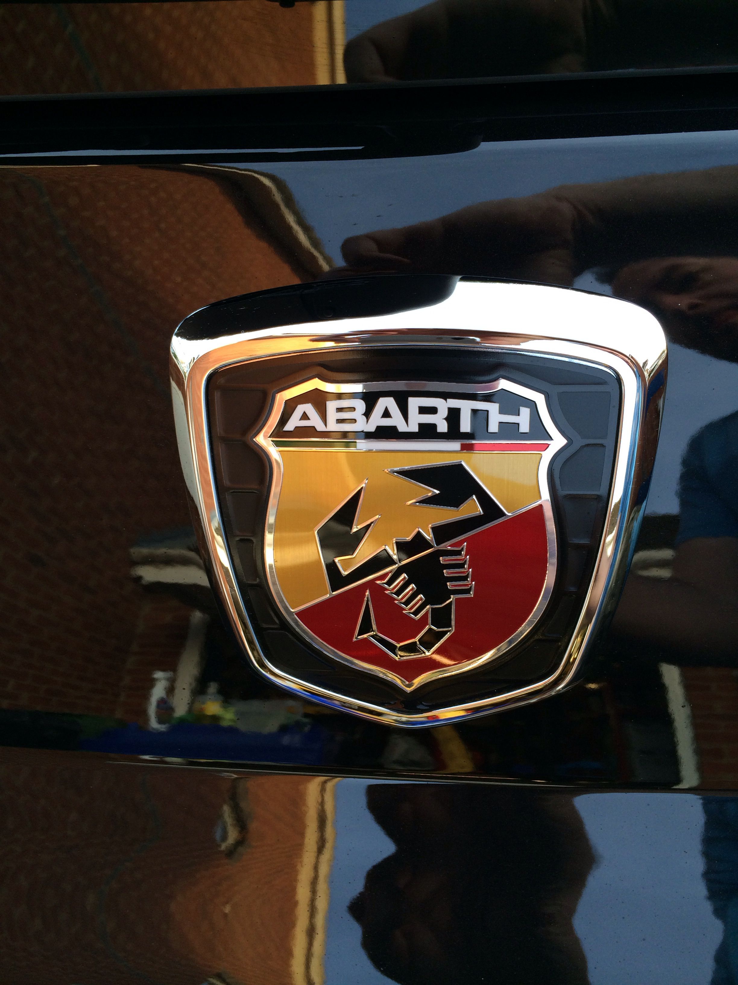

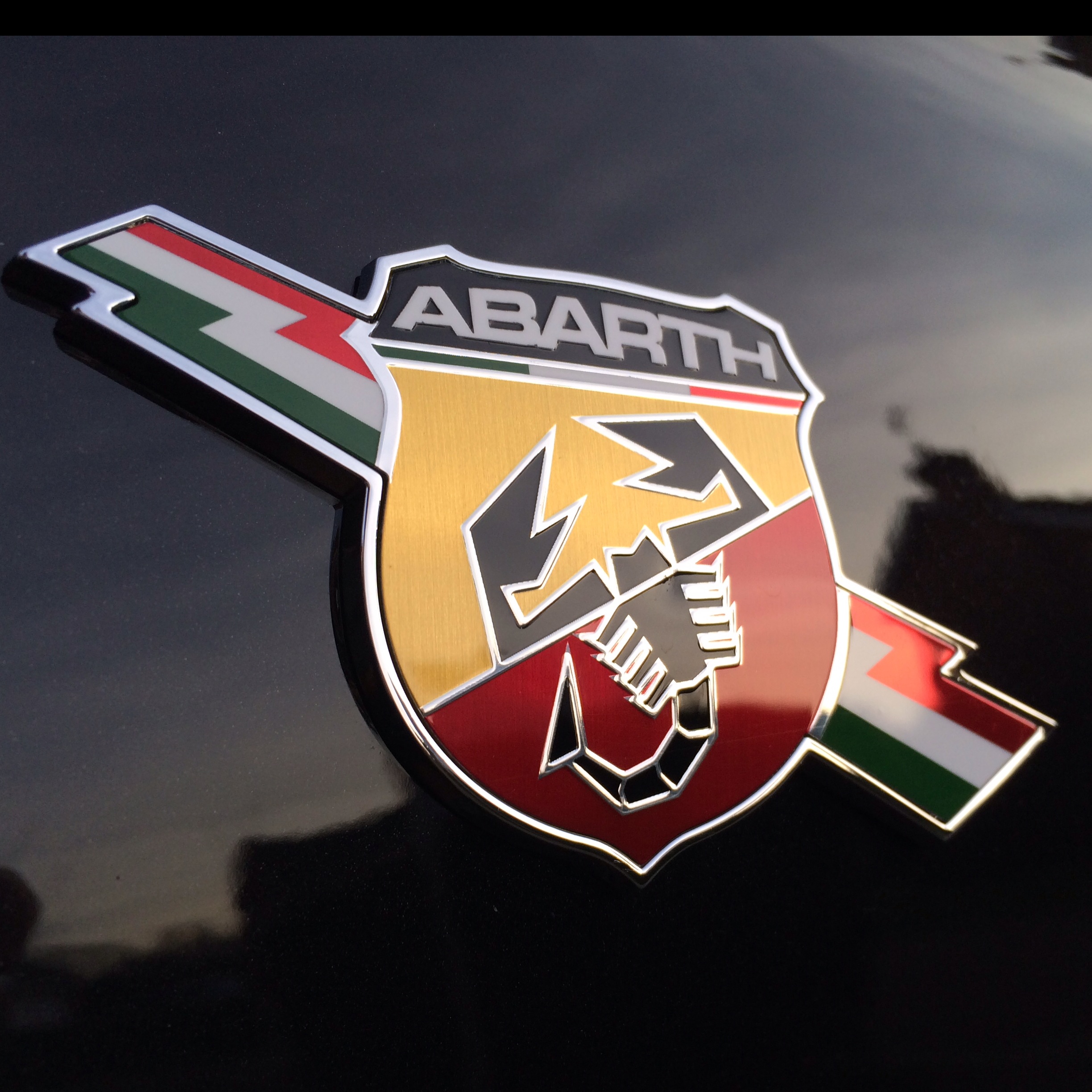

Last but by no means least I cleaned up the exhaust tips using trusty old Autosol metal polish.

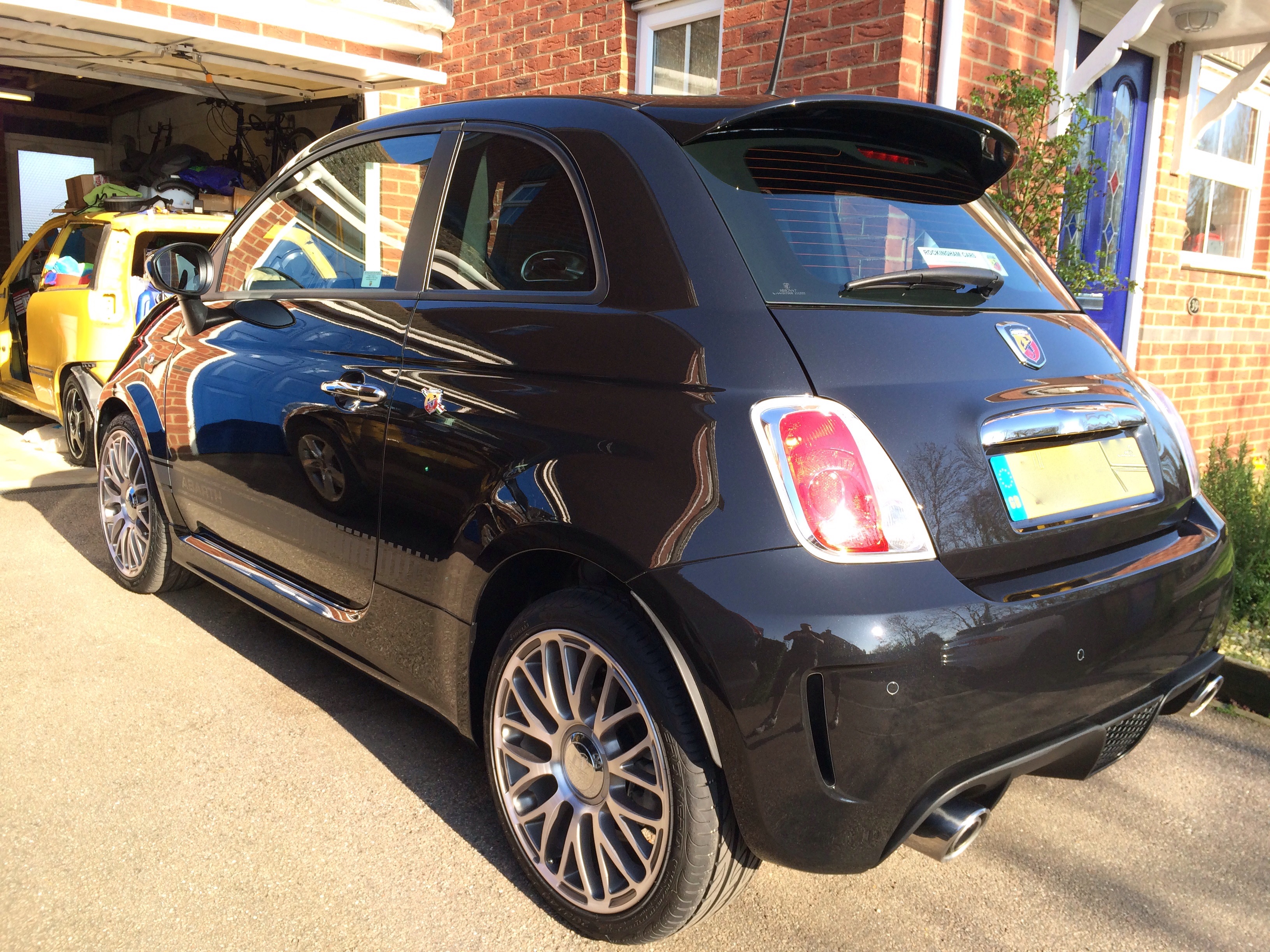

I'm really pleased with the results. I normally hate black cars but this was a pleasure to clean probably due to it being a week old. Just hoping the GTechniq products keep it look great for as long as possible.
Hope you like

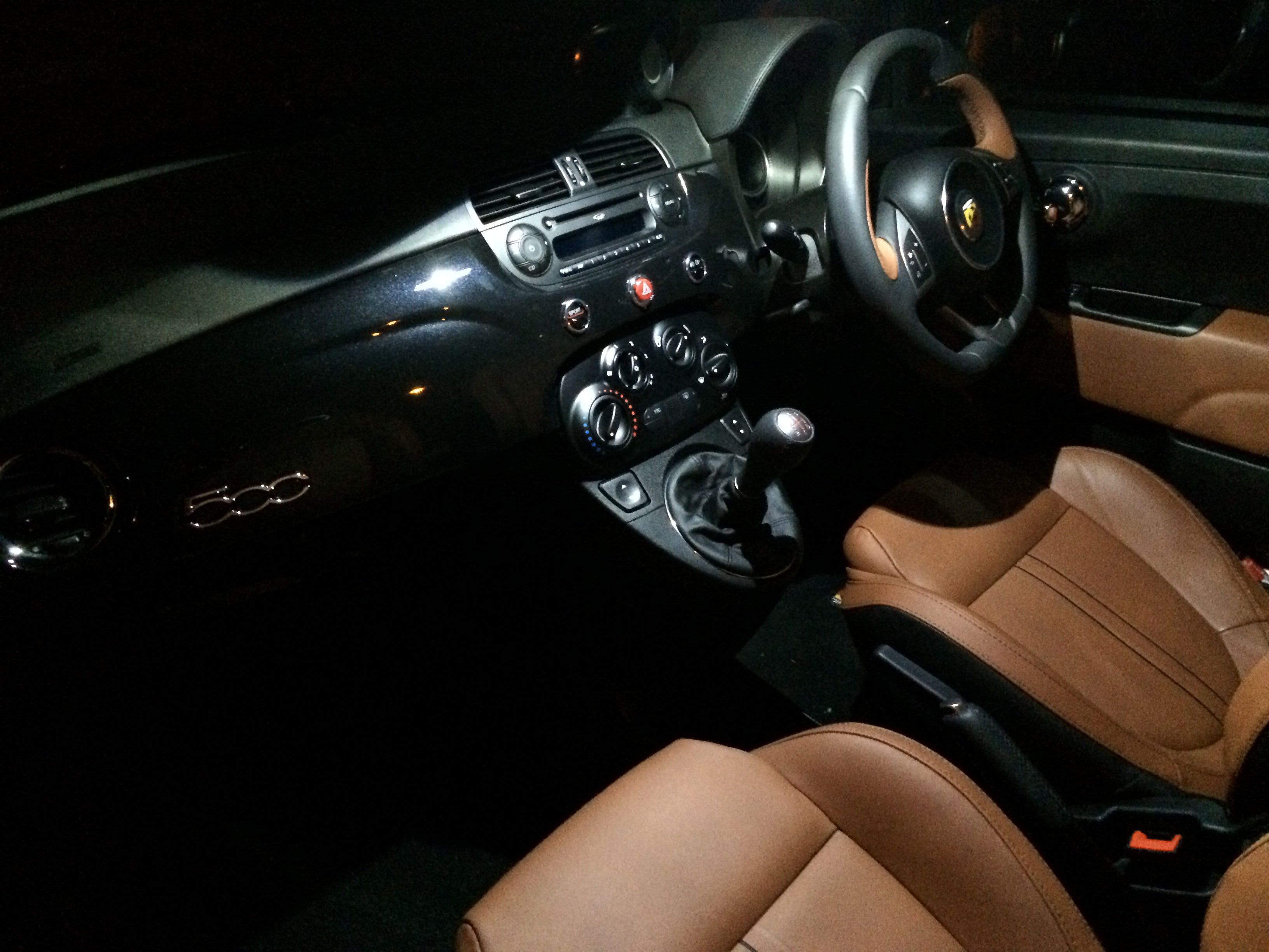

Since the detail I fitted some LEDs to the interior:
