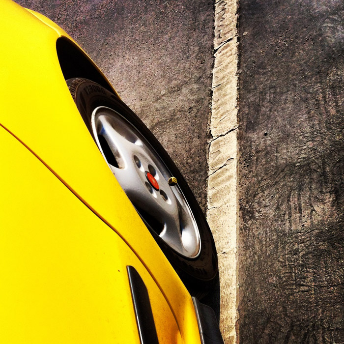

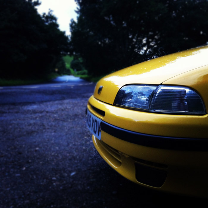

So this is my Punto as it stood yesterday morning...
There are still a few jobs I will be tackling some day, and probably some sooner as the MOT is due in November.
6 months in and I wouldn't wish the joys of Fiat Ownership on anyone but I forgive it for its faults when it gives me 45mpg and a grin every time I bury the go pedal to the floor :devil:
