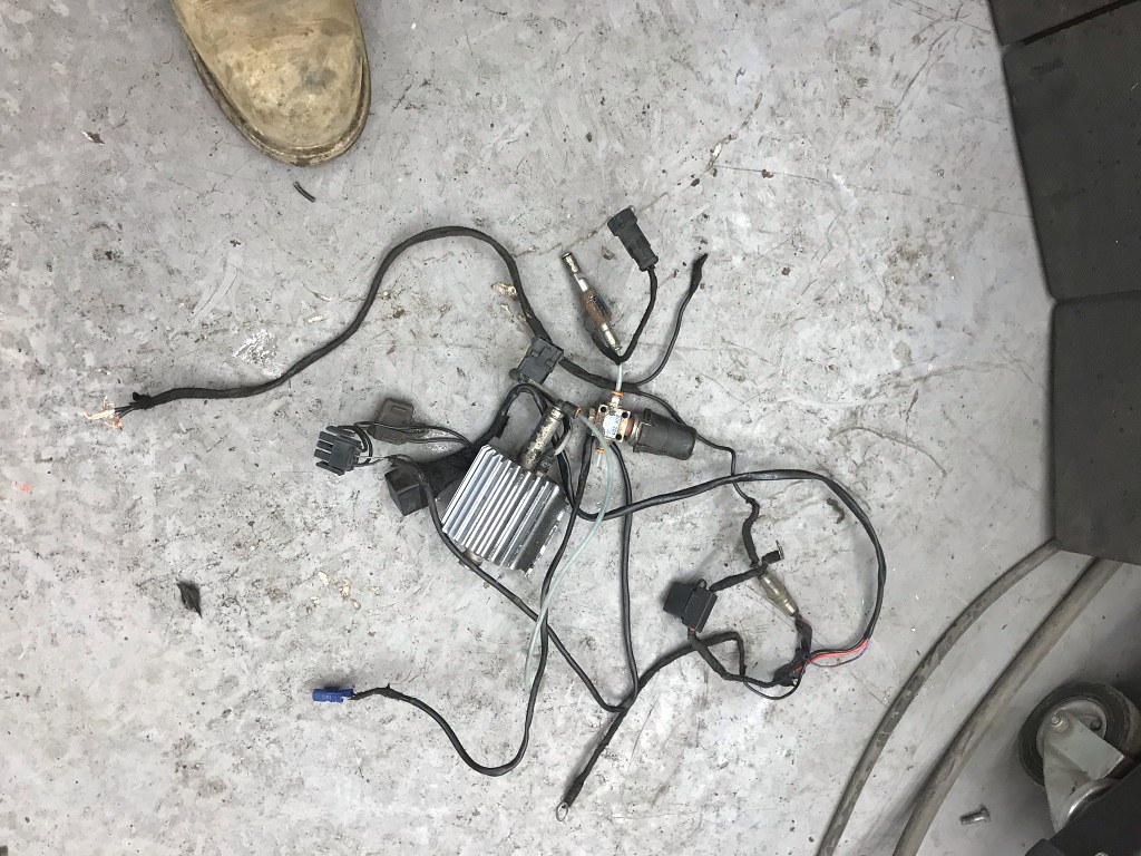

Some water injecton kit with a lot of extra wiring... all to go

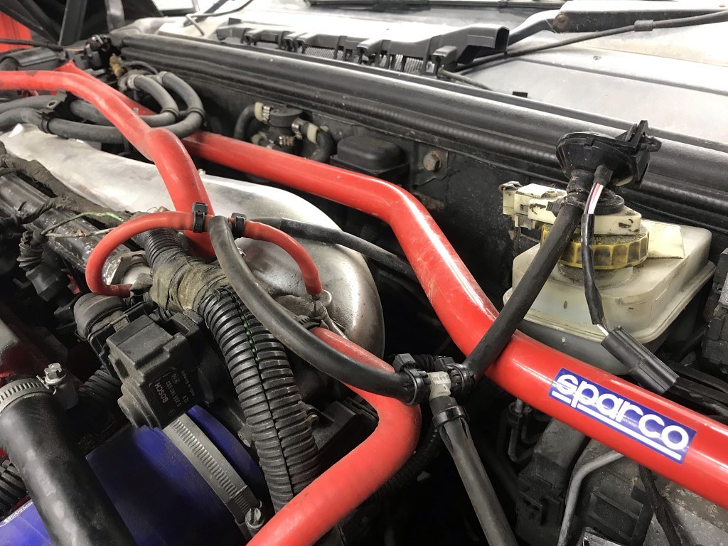

Lots of silicon and clamps...

Lot's of cracked pipes
Lots of stuff like this, hoses just capped off...
Found the air temp sensor just floating in the engine bay! Not in the inlet manifold?
First thing to go was the water injection, wiring was just twisted onto the injector wiring.
Stripped out

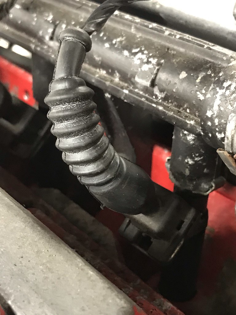

Wiring repaired and heat shrunk
New boot and thats one job done
