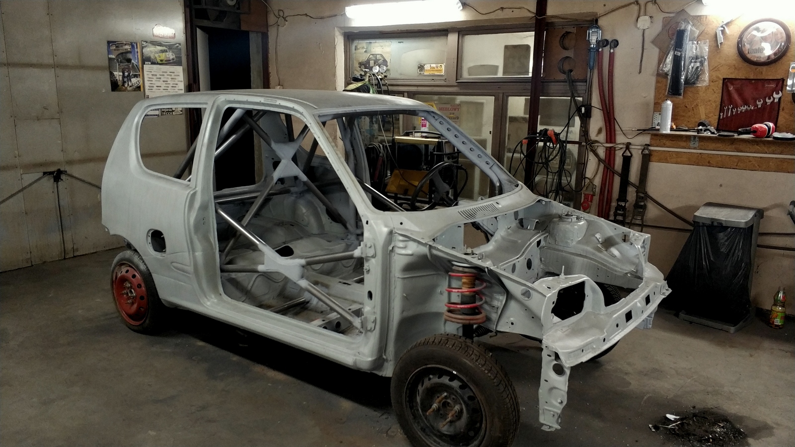

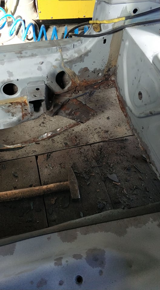

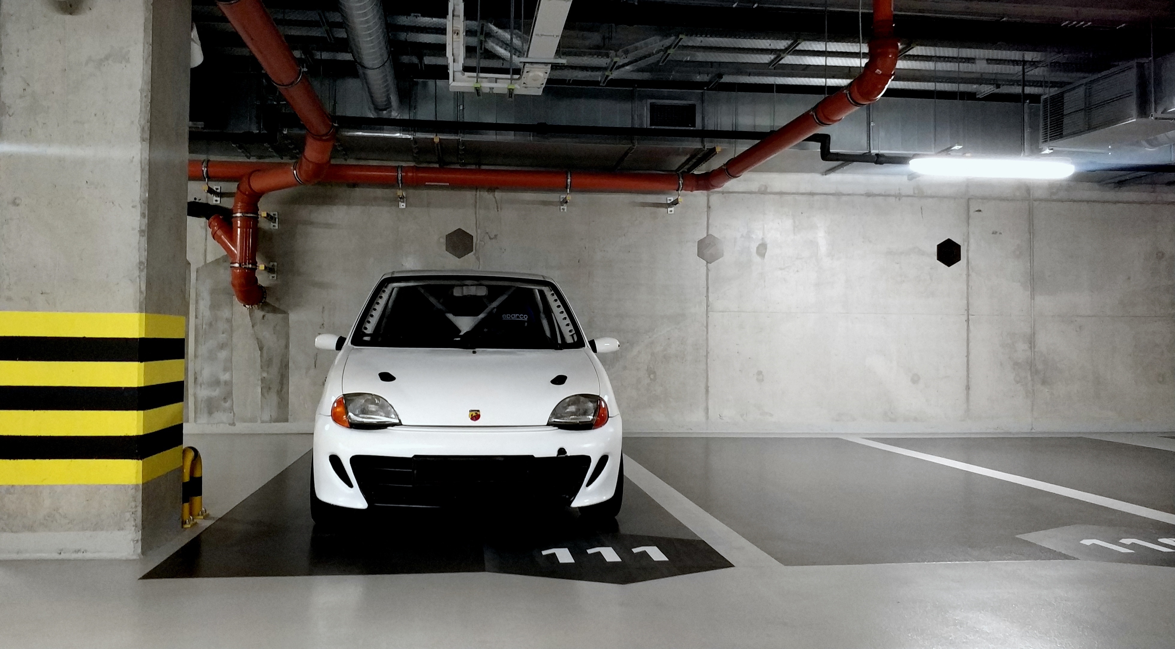

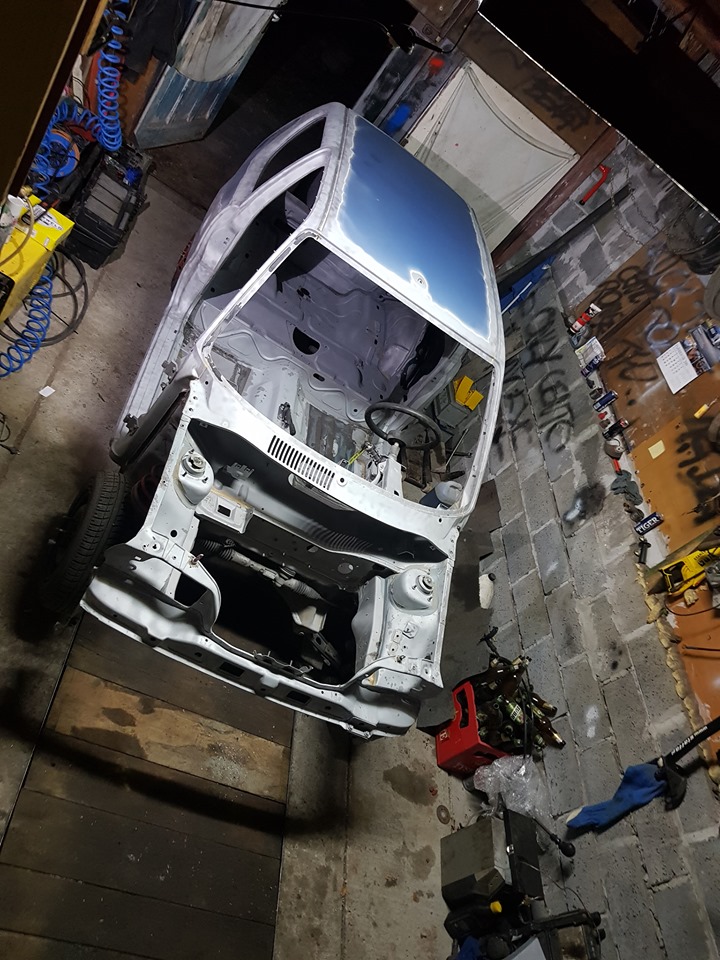

Hi folks!
I would like to show you my seicento. It was a 900 + LPG but after some circumstances 1.2 8V said hello to me. It's long story so I will drop below some modification done for now.
Engine and transmission:
- Full rebuilt 1.2 8V 75HP from punto I
- Yankowy intake (best in my country)
- throttle 45mm
- adjustable cam wheel
- camshaft 278*
- light flywheel 3,8KG
- gearbox 6s with main gear 13/64
- steel braided petrol hoses inside cabin
Exhaust:
- 45mm exhaust with 125p muffler
Suspension:
- everywhere yellow (strongest) poliuretanas produced by Strongflex
- Eibach spring and PZM-1/bilstein b4 shocks
- 4x25mm alu distance on side
- rear anti-roll bar
Brakes:
- front brakes - Brembo MAX + DS2500
- hydraulic handbrake
- steel braided brake hoses inside cabin
- Punto I brake pump and brake servo
Body:
- new pait
- sporting bodykit
- fiberglass hood
- polycarbonate rear glass
- tow straps
-lower and upper strutbar
Interior:
- full rollcage
- bucket seats FIA
- 6point harness FIA
- RRS wheel
- oil temp / water temp / oil press DEFI gauges
- main switch
- radiator fan on switch
- shiftlight
Wheels:
- russian forged rims, BMW Alpina, Speedline Sporting
Plans? YES! I need to bought LSD, 4-2-1 exhaust manifold, aluminum plate under the engine, swap rear brakes from Abarth 500. Buy new camshaft probably cat cams/colombo bariani but still dont know which degrees :/. Suzuki GSXR carbs to do some ITB
Some pics:
And some backfire
before painting:
