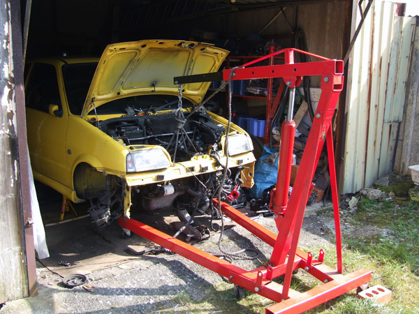

Out with the old

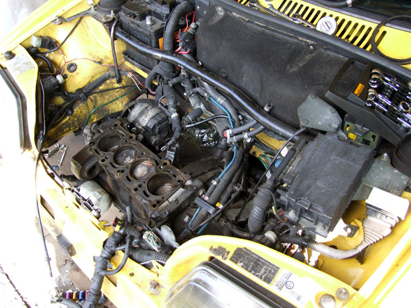

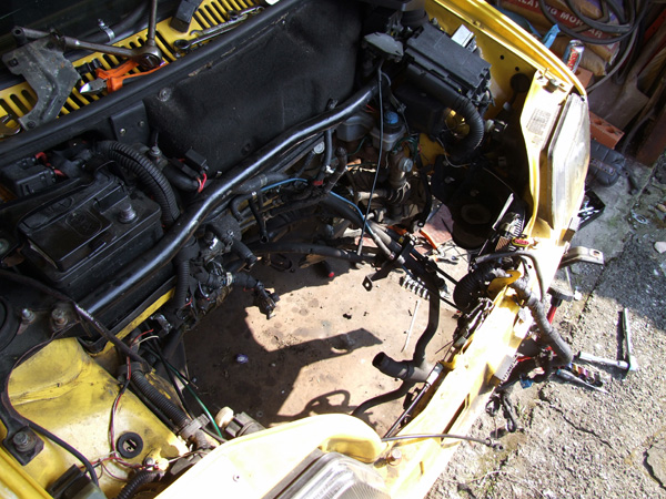

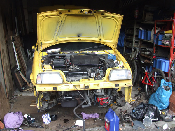

By this point id removed the head, driveshafts and most of the linkages ready to drop it out with the engine crane.

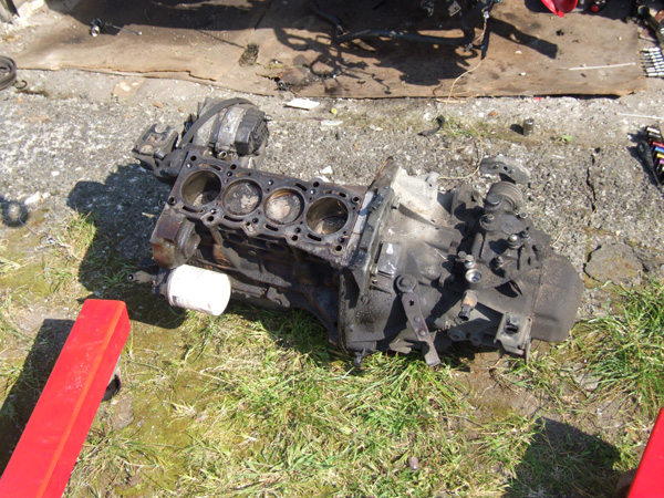

By the looks of the old engine, i had a leaky core plug and there were alot of oily carbon deposits on the piston crowns so the valve stem oil seals or piston rings werent sealing properly. Never mind

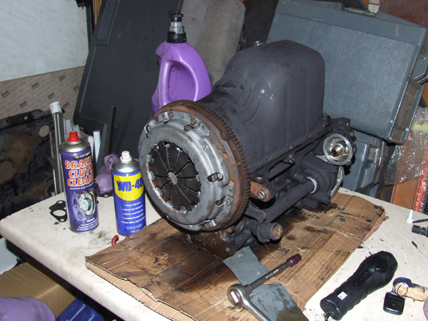

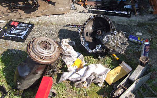

New clutch fitted (aligned by eye and it went on perfect first time
) and the water outlet pipe fitted and sealed after painting it.

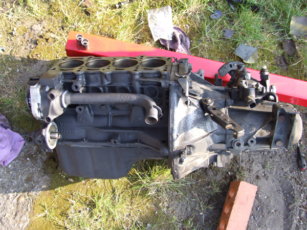

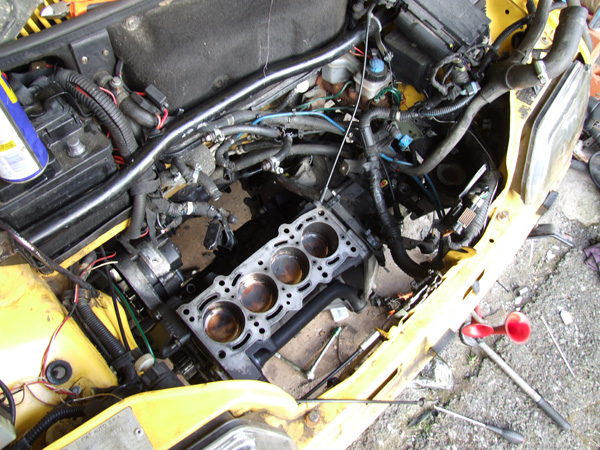

Mated the gearbox back to the new engine, and all seems well. I also cleaned up the gasket surface on the block using some 800 wet'n'dry with some wd40 to stop it cloging up - came out perfect
Then new block put back in!

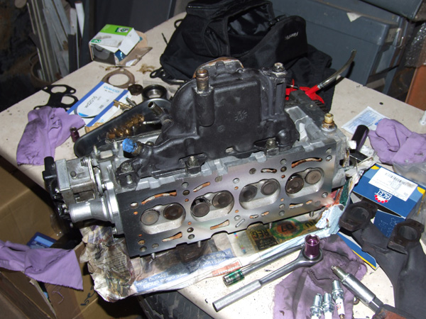

New head

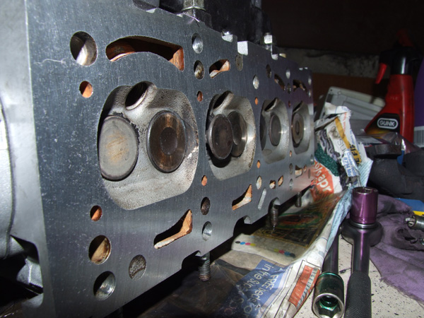

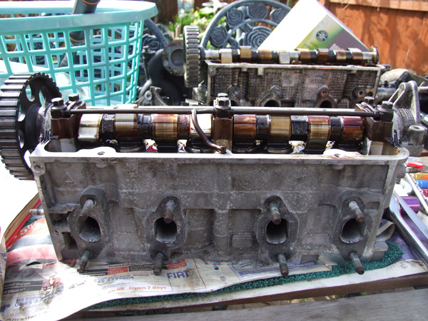

Fitted the 75 cam and shimmed it all within the 0.5 tolerances using the shims from both heads. This has been skimmed and cleaned, valves reground, home ported to the gaskets and exhaust ports polished as well as i could. blew up my trusty dremel in the process

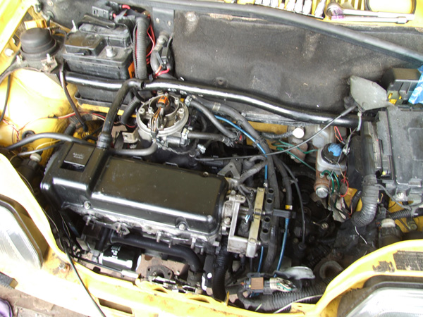

Fitted the intake manifold and new thermostat.
The head fitted, torqued down and throttle body fitted.

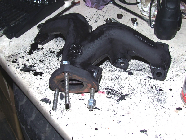

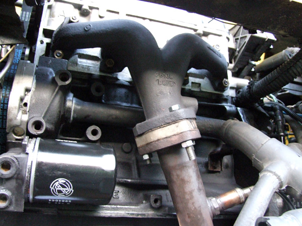

For the engine to fit, i needed to use a spacer for the exhaust manifold. But i also had to elongate the studs on my manifold. After attempting to get the studs out of my old manifold, i gave up and used a spare i had lying around. The only problem with this one was one had been broken and drilled out to the point where i couldnt re-tap it - so had to use a bolt instead. the other 2 were threadlocked in place and then painted the manifold. Once dry it was ready to be refitted...

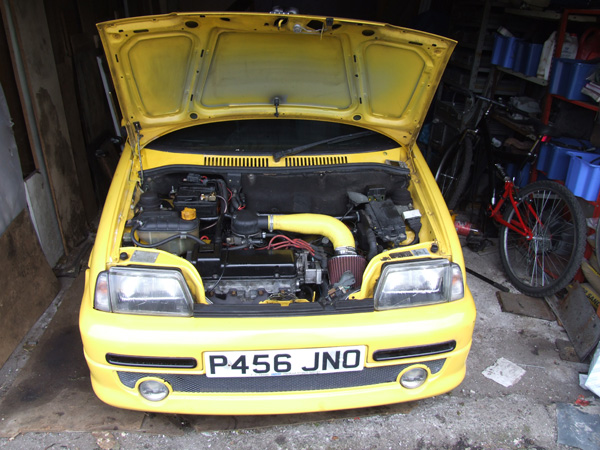

Back on the road!
I refitted all the ancilleries back and refilled all the fluids. sadly i didnt take any pictures as it was getting dark and had to work under torch light - which was fun to say the least. I came back the next morning and did the final touches and put it back on the road...
Luckily it started first time, with no problems. had a slight coolant leak, which was due to me forgetting to tighten a hose clamp on the back of the throttle body. Was also a small oil leak coming from the crank area, but think it was just runoff from where i spilled some re-filling. Will keep an eye out.
As it was still nice and warm, it was perfect weather for a wash/polish and wax to get rid of all the oily fingerprints and paint splatters from the work above. Yellow cars always polish up lovely
Final thought / First impressions
I was pleased with how it all went, taking me 2 days to do the whole lot by myself taking my time so everything was nice and clean
Im still running it in, so not had a chance to really open her up yet, but the torque difference is amazing - much more lower down and is really usable. It made it to ACE and back with no problems (covering around 110 miles), didnt overheat at all

- Take cam out of the old head and put in the new head (and shim it all correctly)

Out with the old
New head
