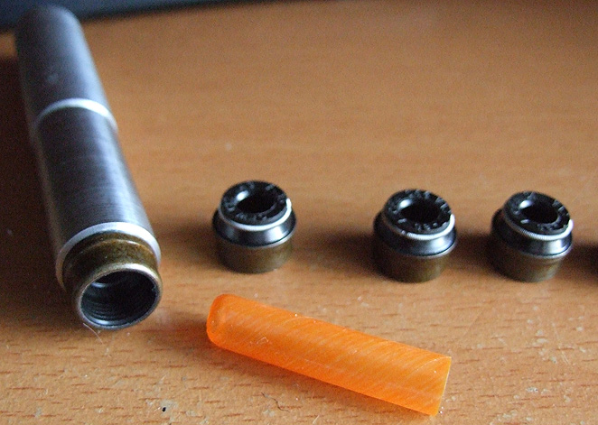

Fitting the valve stem oil seals were a peice of piss now my dad machined me up a tool that allowed me to tap on the edge and leave the top (with the spring) alone. I knew the lathe would come in handy!
