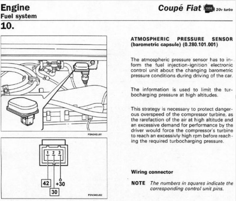

Pin 3: on general schematics (chapter 10, pagee 14 of workshop manual) pin 3 is connected to +12V battery; in electrical schematics this pin is connected to GND.
Which would be the correct connection for pin 3?
Thanks.
According to the Fiat workshop manual, pin 1 of the atmospheric pressure sensor connects to pin 42 of the engine management ECU. Pin 2 of the APS connects to pin 30 of the ECU. Pin 3 of the APS connects to +30 which is a 12 volt +ve battery supply.

Don't you think it's strange?
Sensor connections are:
- output (of course)
- +5V supply (of course)
- +12V (battery) supply instead GND???
Same BOSCH sensor mounted on other makes has connected pin to GND.

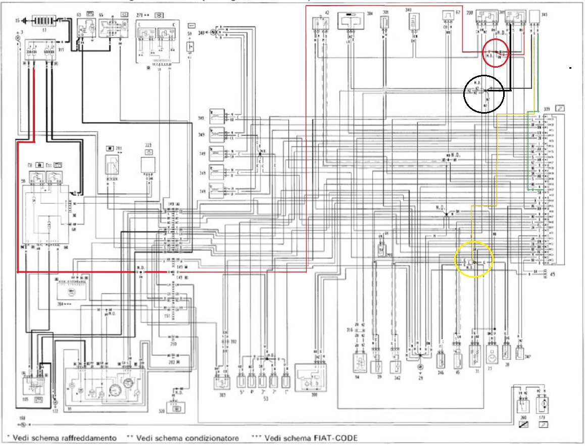

I'll post electric diagram (taken from workshop manual) where pin #3 is connected to GND.

I can't see anywhere that it's connected to GND.
Pin 1 (V = Green) of the APS connects to pin 42 of the ECU.
Pin 2 (G = Yellow) connects to the soldered joint (circled yellow) that also connects to various other sensors.
Pin 3 (N = Black) connects to the soldered joint (circled black). Another wire from that joint goes to pin 87 of relay 341. When the relay is switched by pin 36 of the ECU, pin 87 is connected to pin 30 which is connected to a +12v supply via the soldered joint circled red.
The soldered joints are insulated inside the wiring harness. They are not earth points.
