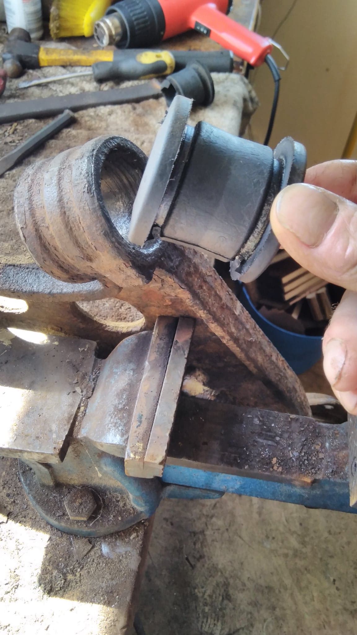

I'm fitting new rubber bushes in the wishbone and cant see how to fit the front one. I just cant see how it can go in with the rubber lip that is at both ends.
can anyone advise on how I get it in?
Plenty of lube and ram it in with that lovely vice you have there.
You may have to find a spacer so the end not being pushed can pop out of hole it goes through hole in wishbone.
Job done
used up all the swear words I know and made up a few new ones.
I was over thinking it brute force and ignorance wins again.
Thanks for your help
