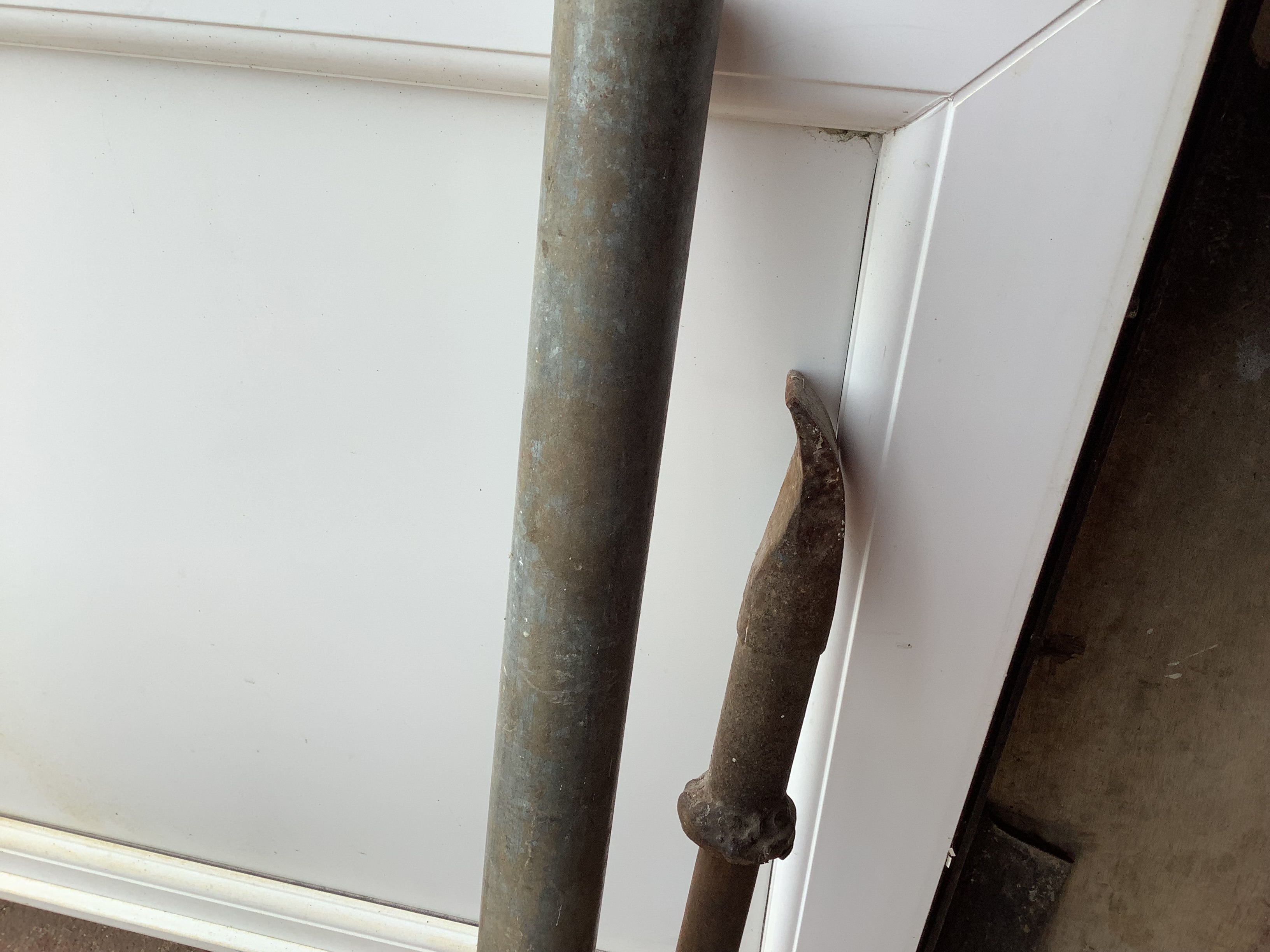

I believe both our hook and bead breaker were home made in the forge. Still use the breaker for my trailer tyres.
I remember those split rims, I never made a cage but always inflated with the ring facing away and preferably around a corner.
