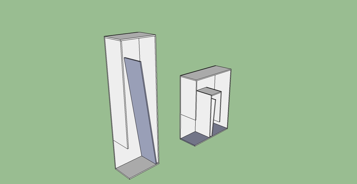

Been researching tapped horn designs and they look pretty good. Work in the same manner as TL's but have positive taper. Downloaded hornresp which is a programme that allows you to input all the data for the driver that is going to be used and set parameters for the design of a box. I managed to tune a box to 30Hz with an output of 120dB
I'll get a sketchup done to show what it will be like

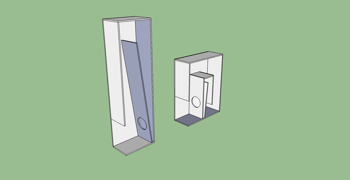

Ok so I did a sketchup model of 2 tapped horn boxes shown below:
The one on the left is 7'7" tall and is far too tall so I looked into double folded boxes. It came out with the one on the right which is 4'7" tall and 3'7" long meaning it is more suited to my space requirements. Both boxes are tuned to 30Hz with a 172" horn.
If my knowledge of Tapped TL proceeds me you cant make a horn like that. The angle of the horn on the wall opposite the mouth is where the sub needs to mount.
Yeah that's where it will be mounted, facing towards the throat so that the rear of the driver is facing the mouth I just didn't put it in the picture haha
