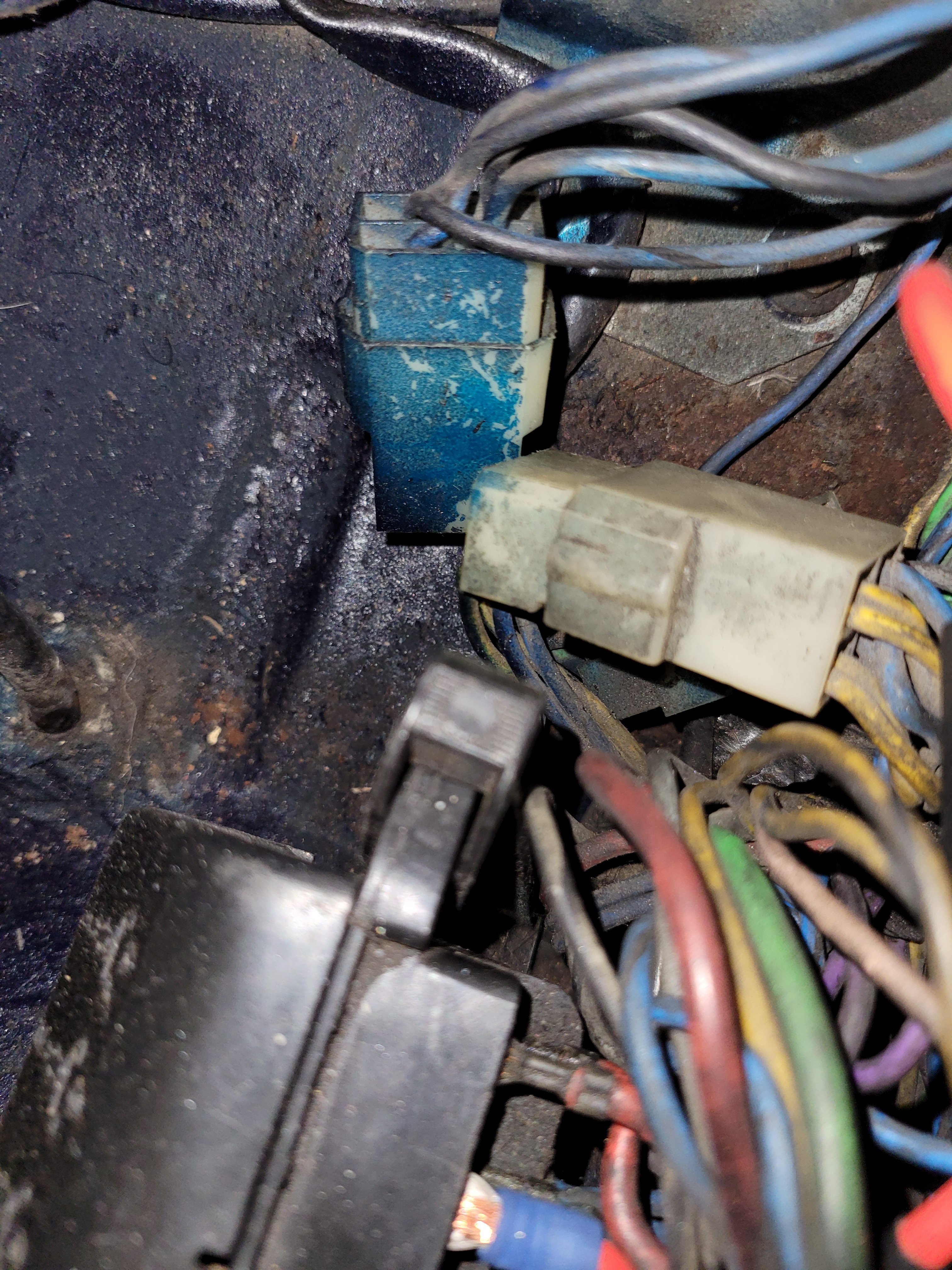

Hi I’m having the exact same issue with mine now all the lights work but the drivers side (LHD) rear light and rear number plate light, all lights work for braking etc.
Where was the part exactly that you jiggled to fix it please.

Hi - I can't remember exactly as it was a while ago but I think it was the white connector right next to the fuse box
