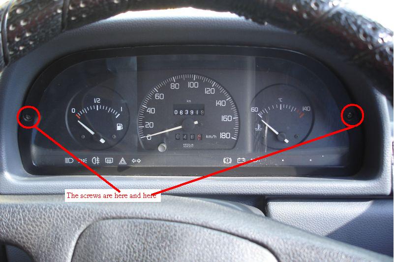

I had removed my instrument cluster at least 10 times last month, have a spare one now, and trying to get one which has a tacho ...
Well I actually twist the bulbs to remove it, and i'm pretty sure it's that way for all MK2's around (at least here)..I have tried some 4-5 instrument clusters but all were this twist to remove type...
And the plastic strip was not glued on our models, and it has many spare holes/bulbholders/indicator panels which is not used.
and , the diesel ones also shares the same cluster,so some connectors are reserved for those models, which is blank in our models.
and if u are curious, u can utilise some more of them work..I have made some seatbelt warning /boot open/door open indicators for which i used my brain to wire myself
Not hell of a job anyway.
U can try installing LED's in instruments, I've fitted a bright white one in my clock, now clock is kinda white instead of it's natural green ( u should remove the green coloured plastic strip behind the LED )
but by the way, I've found LED's as a little more directional, but still the light is brighter, but I decided to keep the standard lights as the brighter lights was disturbing my sight at night :: I have specs so may be u wont have any trouble : It's wise u try assembling one first, give it a try, and then go for the whole cluster..
why u need to test the tacho points ? Tacho wires should come from the LT side of Ignition coil..I think it's a green wire..but from the pic I can see u dont have a tacho either..like mine..but if we can add a tacho it would be fine and fun to drive..May be I'll be adding one..The research is on..main prob is finding two small meters that will fit perfectly into the uno's cluster..of course, a complete altered one will be the result, will post a detailed thread of it once i've sourced the items from the breakers...
