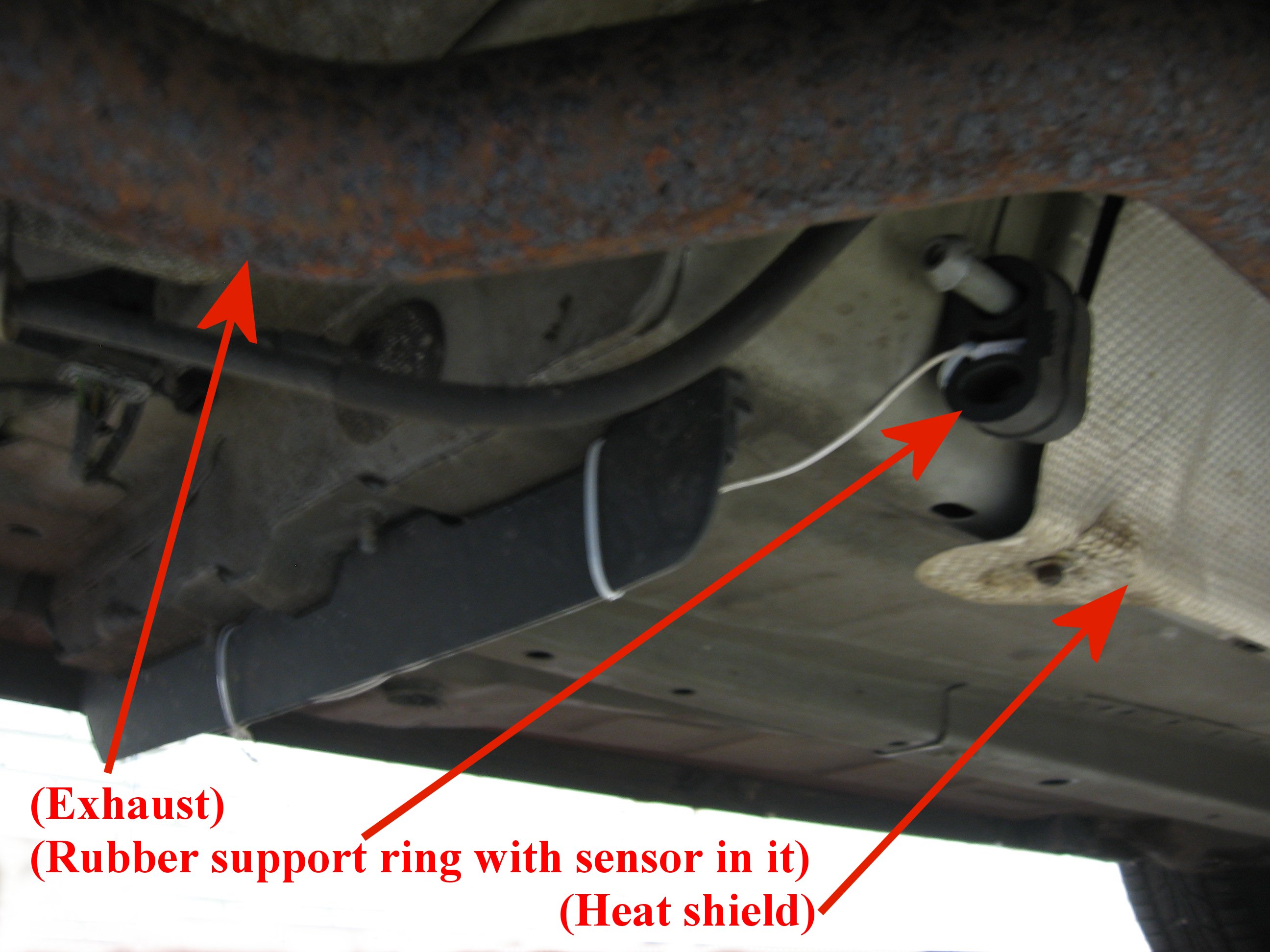

The expected temperature during a regen is about 640 degrees C. To prevent the sensor from melting down, it is mounted about 20 cm from the exhaust pipe and 1 meter downstream the DPF housing, in a spare muffler suspension ring (pn 90466668), slided on a free exhaust bracket. A makeshift arrangement was made for I was not convinced of a positive result.

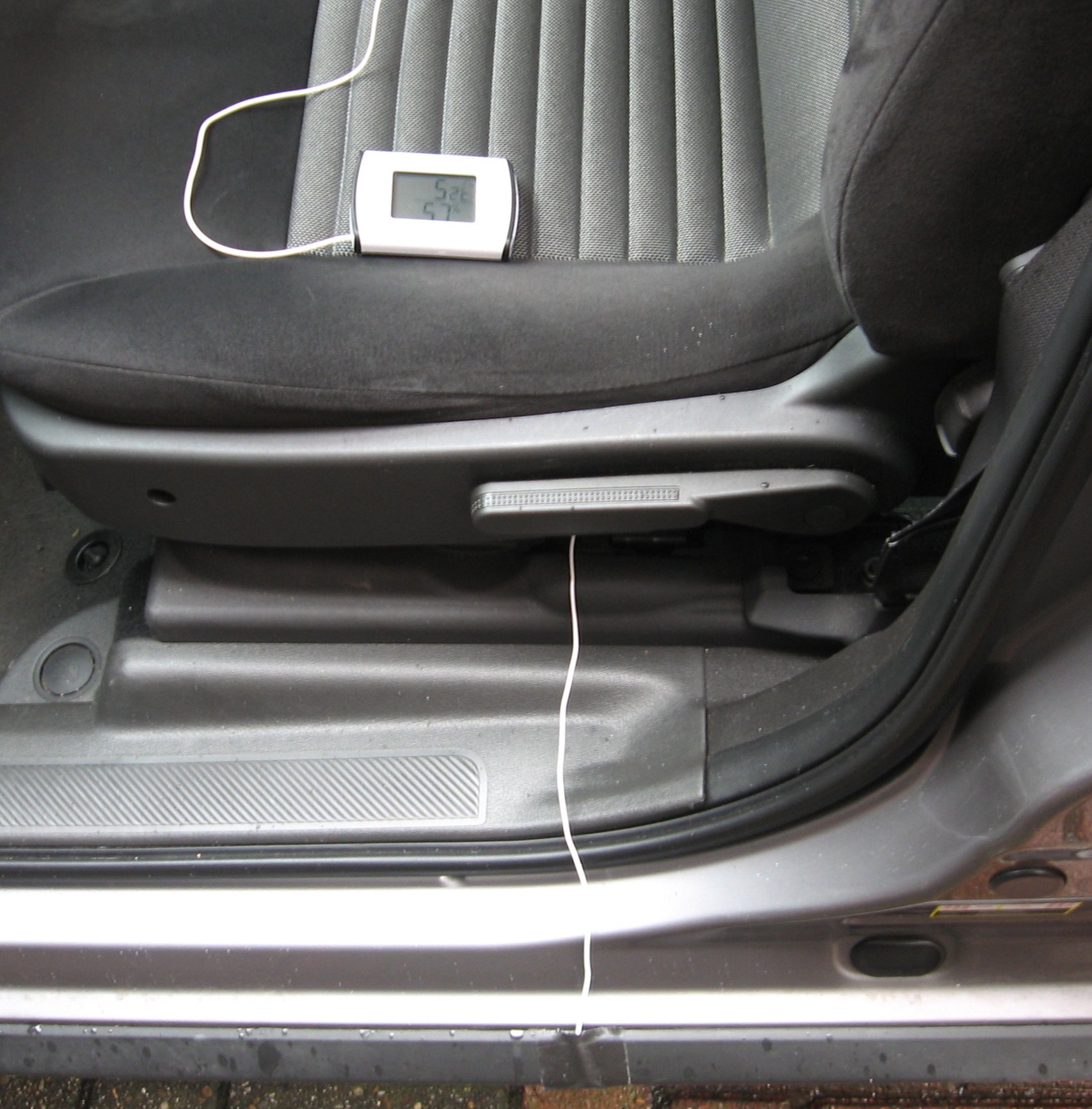

The displayed temperature during driving is 10 degrees Celsius above the ambient temperature, it ingreases a bit with the speed of the car. Driving in town gives about the same result, some 10 till 12 degrees above the environmental temperature, all the readings turns out to be predictable and stable. A higher outside temperature results in a higher thermometer reading.
The previous months the average value of the readings was around 14 degrees, after it went up several times to 20, I expected a regen to be happened. After checking with ECU scan, it proved to be right.
Hope to can lay my hands on a wireless device with acoustic warning signal in the near future.
